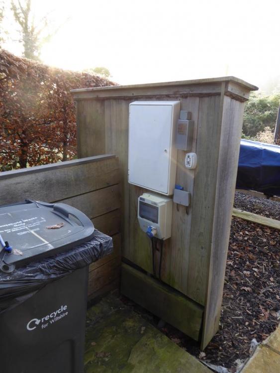

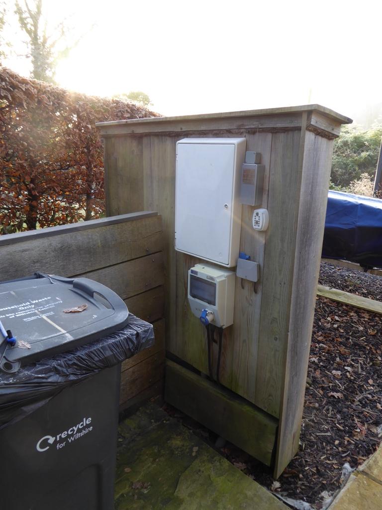

Jeremy Harris Posted December 4, 2019 Share Posted December 4, 2019 Just been out and taken a photo of the meter box side: The caravan box we used as a temporary site supply, with it's 16 A commando is still there. The small grey box is because Openreach originally insisted that their underground cable had to terminate outside the house - by the time they came to install it their rules had changed and they would have preferred to bring it into the house (too late, the duct was sealed up!). The old key safe we put in to give contractors access to the house keys is still there, but no longer used. The silver box is my energy/power measurement system, that transmits data by RF link to the house, and also transmits the on and off signals to the Sunamp heater (for excess PV generation Sunamp charging). 2 Link to comment Share on other sites More sharing options...
Coops Posted December 4, 2019 Author Share Posted December 4, 2019 6 minutes ago, Jeremy Harris said: Just been out and taken a photo of the meter box side: The caravan box we used as a temporary site supply, with it's 16 A commando is still there. The small grey box is because Openreach originally insisted that their underground cable had to terminate outside the house - by the time they came to install it their rules had changed and they would have preferred to bring it into the house (too late, the duct was sealed up!). The old key safe we put in to give contractors access to the house keys is still there, but no longer used. The silver box is my energy/power measurement system, that transmits data by RF link to the house, and also transmits the on and off signals to the Sunamp heater (for excess PV generation Sunamp charging). That's really useful, thanks for posting Link to comment Share on other sites More sharing options...
Danny68 Posted December 4, 2019 Share Posted December 4, 2019 Again thanks , neat and effective even down to the key safe . Link to comment Share on other sites More sharing options...
Jeremy Harris Posted December 4, 2019 Share Posted December 4, 2019 36 minutes ago, Danny68 said: Again thanks , neat and effective even down to the key safe . The key safe was really useful, as was having a combination padlock on the Heras fencing gate into the site. It meant I could let contractors have the combinations and didn't need to worry about having to be on site at the crack of dawn every day. As each contractor finished their work on site, I just changed the combinations for the next ones due in. Probably not foolproof, and I did advise contractors to not leave any tools on site (and had a notice up on the fencing saying this), but it seemed a fairly good way of keeping the place reasonably secure, yet still allowing easy access. It also meant I could just give someone the combination over the 'phone if they needed to get into the site to make a delivery. 1 1 Link to comment Share on other sites More sharing options...
