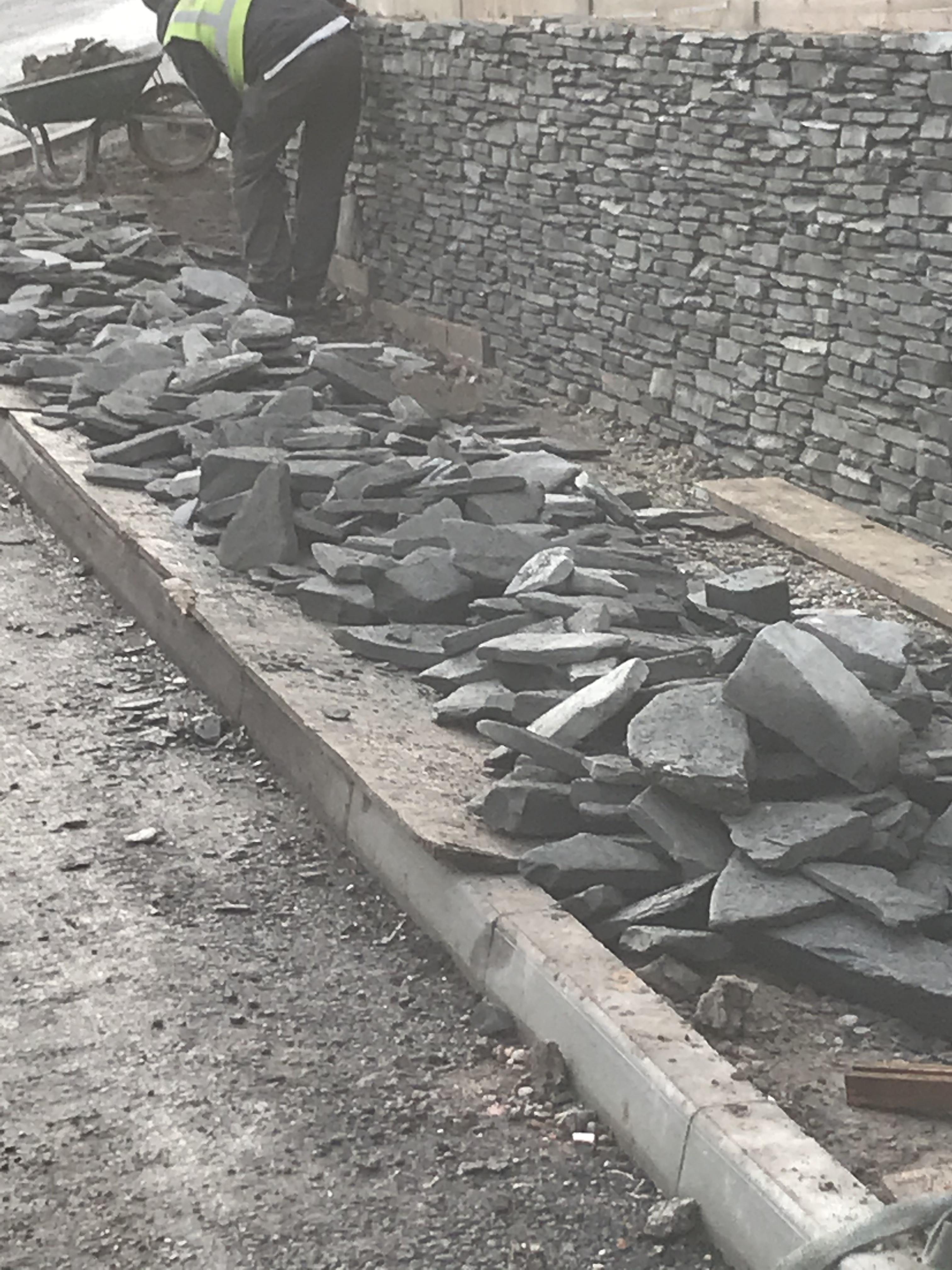

nod Posted December 3, 2019 Share Posted December 3, 2019 +1 and we are plastering here Link to comment Share on other sites More sharing options...

nod Posted December 3, 2019 Share Posted December 3, 2019 Temps have now risen to 3 above Business as usual Link to comment Share on other sites More sharing options...
