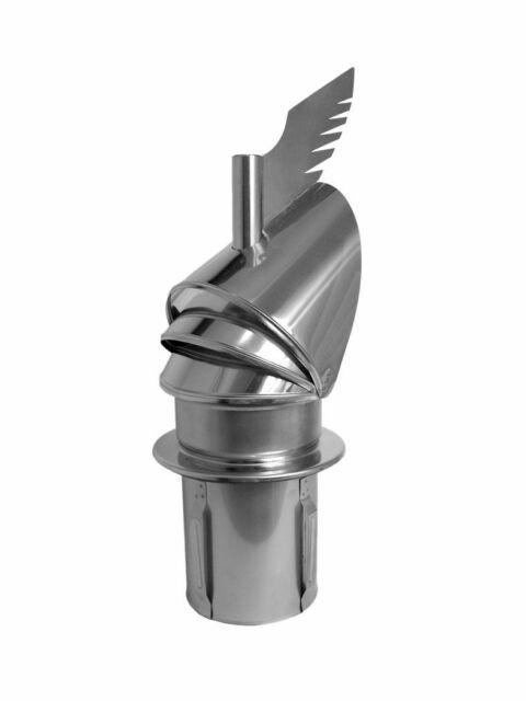

Mulberry View Posted December 1, 2019 Posted December 1, 2019 Here's a revelation for anyone that has flue issues. When we fitted our Wood Burner, we could only achieve a flue length of just over 3 metres, which is woefully short. We battled for years with it being incredibly difficult to light and would frequently smoke the room out. Then we bought one of these cowls, which totally transformed it. I know it looks a bit funky and weird, but it's worth every penny. It works like a dream, spinning on a nice little bearing, tracking the wind and drawing air through it's ingenious design. Ours is now matt black so as not to draw attention to it, also the reflective chrome coating was playing havoc with the neighbours when it was sunny. This is where we got ours... https://www.ebay.co.uk/itm/DRAGON-Self-adjusting-Chimney-Cowl-for-insertion-6-7-8-10-stainless-steel/151951881289?hash=item236109b449:m:mkckuj9atLKv4qtYNTby9QA 1
