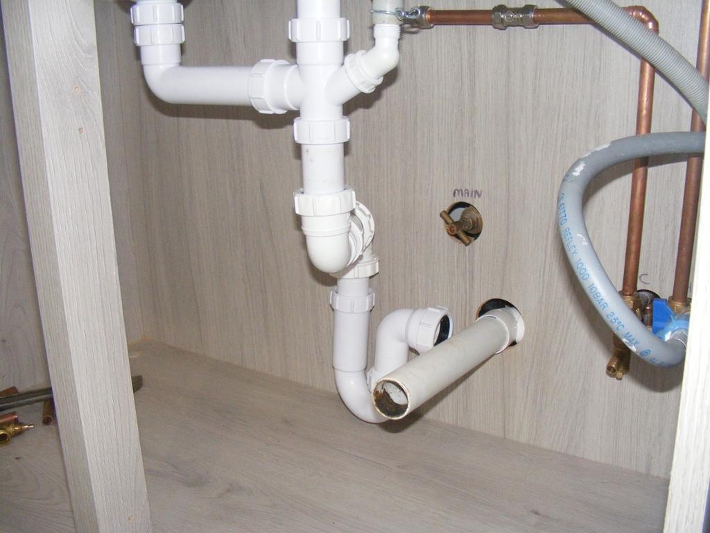

The immediate question refers to sink wastes and traps, a job I am trying to do just now and would appreciate an opinion please.
If I fit the waste and trap as it is intended, the trap ends up very low inside the sink unit.  Even allowing for the fact I can shorten the bit of pipe above the trap, it still ends up lower than I want, which forces me to put the shelf a lot lower than I want, or forces me to cut a hole in the shelf for the trap to hang down through which is awkward and I think looks like a bodge.
If I make some "alterations" I can move the trap so it is lower down, below the level of the shelf, and right at the back of the unit. This mock up shows what I have in mind.
Again by shortening the first bit of pipe out of the branch, my top elbow will be higher if I proceed and do this.
This would mean I only need to notch the back of the shelf to clear the pipe, and can fit the shelf where I want otherwise unobstructed.
Can anyone give me a reason not to do this?

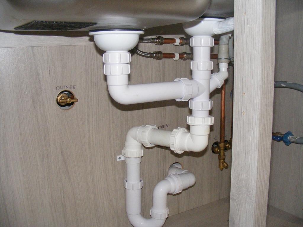

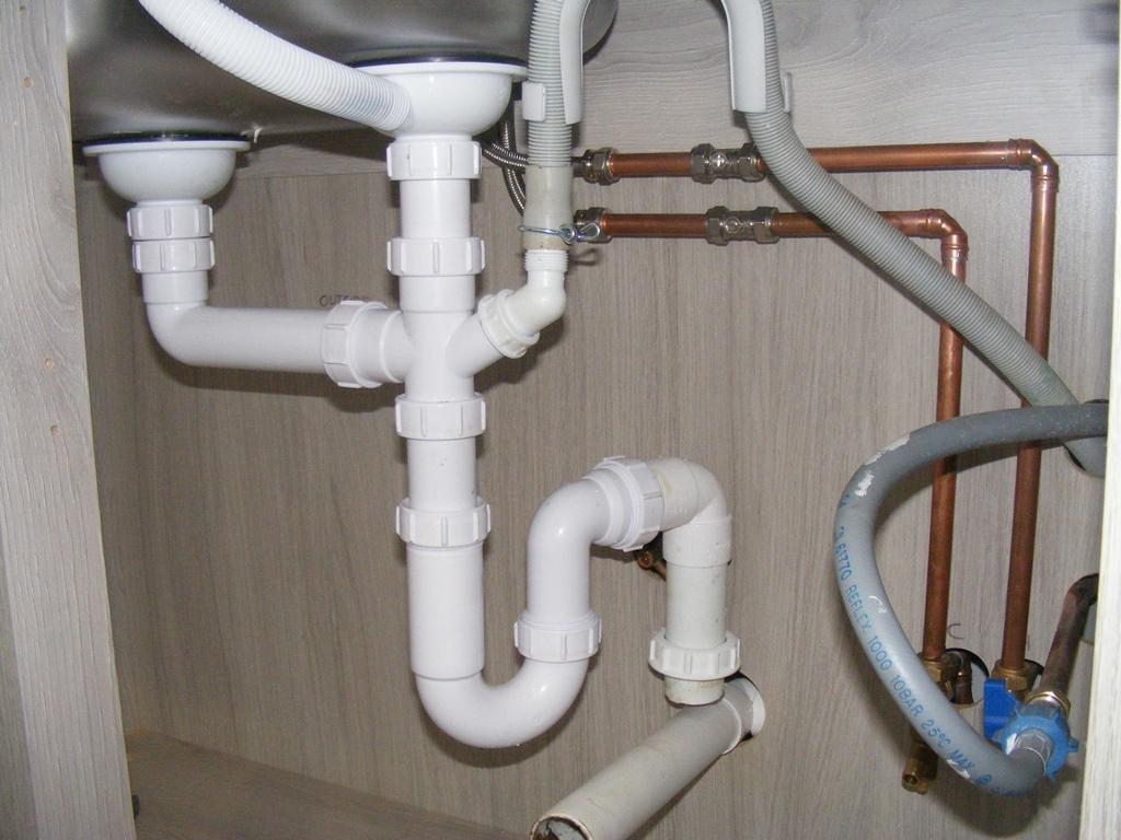

Posted
Well nobody shouted at me not to do it, so I have done it.
And here it is with the shelf in place
There were a few other things that constrained me, like the position of the main stop tap, otherwise I could have put the shelf a bit higher still.
For those pondering the details, in effect I was intercepting and modifying the "inner workings" of a waste trap system.  That presents a few difficulties.  The main one being the pipe used withing the trap is 40mm, yes real 40mm outside diameter pipe.  Unlike the "40mm" waste pipe we all buy and use that is something like 43mm outside diameter.  So standard "40mm" waste pipe and fittings are no good for modifying an intermediate bit of a waste system.
The solution.  40mm compression waste fittings have enough give to compress down onto real 40mm pipe so that is what I used for the 2 elbows.  That means the extra horizontal bit is 43mm pipe.  That just meant I needed an extra bit of real 40mm pipe, which of course you cannot easily buy.  The solution to that is my washing machine stand pipe is now 6" shorter than it was this morning to donate the 6" of 40mm pipe I needed.
Have I ever mentioned I hate waste pipe and fittings and the fact not all bits fit together as one might hope?

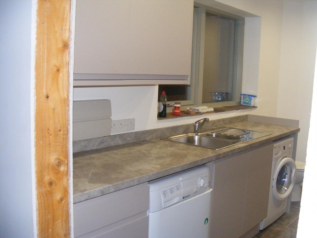

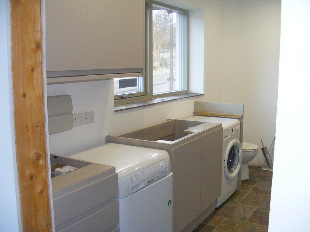

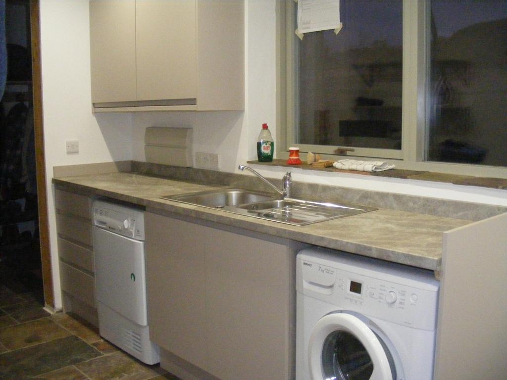

So now the "big picture" of what this is all about and the job in hand.
Over a year ago when we fitted the kitchen, we had neither the time or money to organise the final worktop, so I fitted a temporary cheap worktop and sink.
But being a cash strapped self builder, that worktop was not going to be wasted.  A bit of forward planning and that worktop was always destined to move to the utility room.  That is why the worktop was left deliberately over length, hanging out close to the stove, but we managed not to even singe it (thanks to a metal baffle plate screwed under the overhanging bit)
So now the utility room was finally ready for it
And it fitted like a glove
It was the waste fitting and shelf in the utility room that was the starting point of this thread.
So now for the next 2 weeks we have an awkward situation with no sink in the kitchen, and all sink work being done in the utility room.  Should keep us fit with all the walking between rooms.
