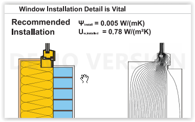

Best (better?) practice would be to change the window when you do the insulation, and install it in the insulation layer.
I would like to do the EWI when and if we are able to get PP to change the hip ends on the bungalow to gables. Figure the EWI could just carry straight on up. As for getting PP I'm doubtful. The house has already I believe had it's 50% extension allowance before we bought it and I think if you increase the m3 in the loft by doing gables from hips that comes into it. Plus the profile that would change faces the road. That being said, looking up and down the road I would say gable ended properties outnumber hipped roofs by a big majority. AONB, SSI etc.

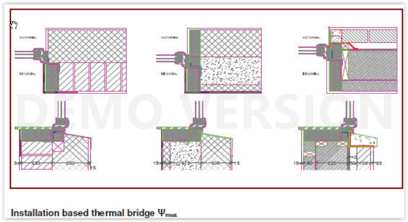

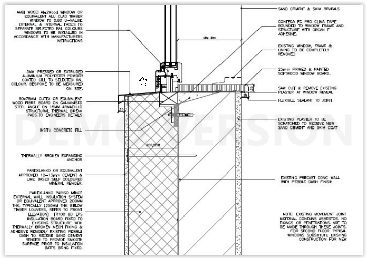

I've Googled "fitting window to EWI" looking for a section through view to no avail.
Collecting the new Window next Friday
Edited by Onoff
3 minutes ago, Simplysimon said:
any use?
Ta. So top, middle diagram is akin to what I have IF I added a couple of inches of insulation inside?
it's all about minimising cold bridging, stopping condensation and mould growth, esp in a bathroom. the middle top and bot is the same detail with different views
simon
Edited by Simplysimon
more info
simon
Appreciate the plan/side view thing!
Do you have a link to the site, the quality of the screen grab isn't that easy to decipher?
