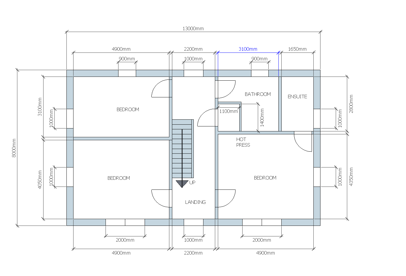

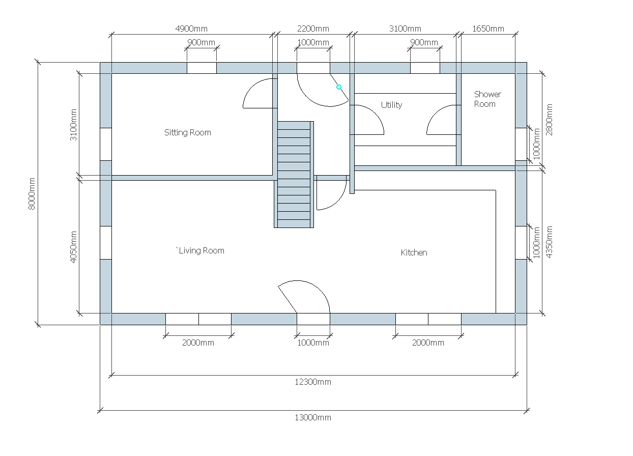

Iceverge Posted December 26, 2019 Share Posted December 26, 2019 (edited) Hi @Amateur bob, What a lovely opportunity. We are in a similar situation in Ireland, currently at first floor level. For reference price wise, we are expecting to pay our builder €230k for taking the house from a field through to pre final interior fit-out for a similar sq meterage. I don't think your build only price is unrealistic given the £/€ rate and the fact you can reclaim VAT in the UK. I did pay a lot of attention to value (amateur)engineering the project however. Obviously profession fees/levies and final fit out will all add up. Couple of questions. 1. What is the maximum ridge height likely to be acceptable to the planners? 2. Is this likely to be a lifetime home? 3. How many bedrooms do you need ? 4. What direction from the house is/are (i) The Farmyard (ii) The nicest Views (iii) the access road 5. Is the farm dirt likely to be earthy or somewhat smellier?!! 6. Will you require a room that could be used as a farm office/study? 7. How proximate are your neighbours? I'll see if a similar house design to ours (below) could be adapted if you like..................................... Cheers, Iceverge Edited December 26, 2019 by Iceverge Link to comment Share on other sites More sharing options...

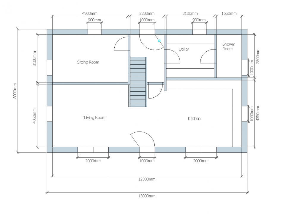

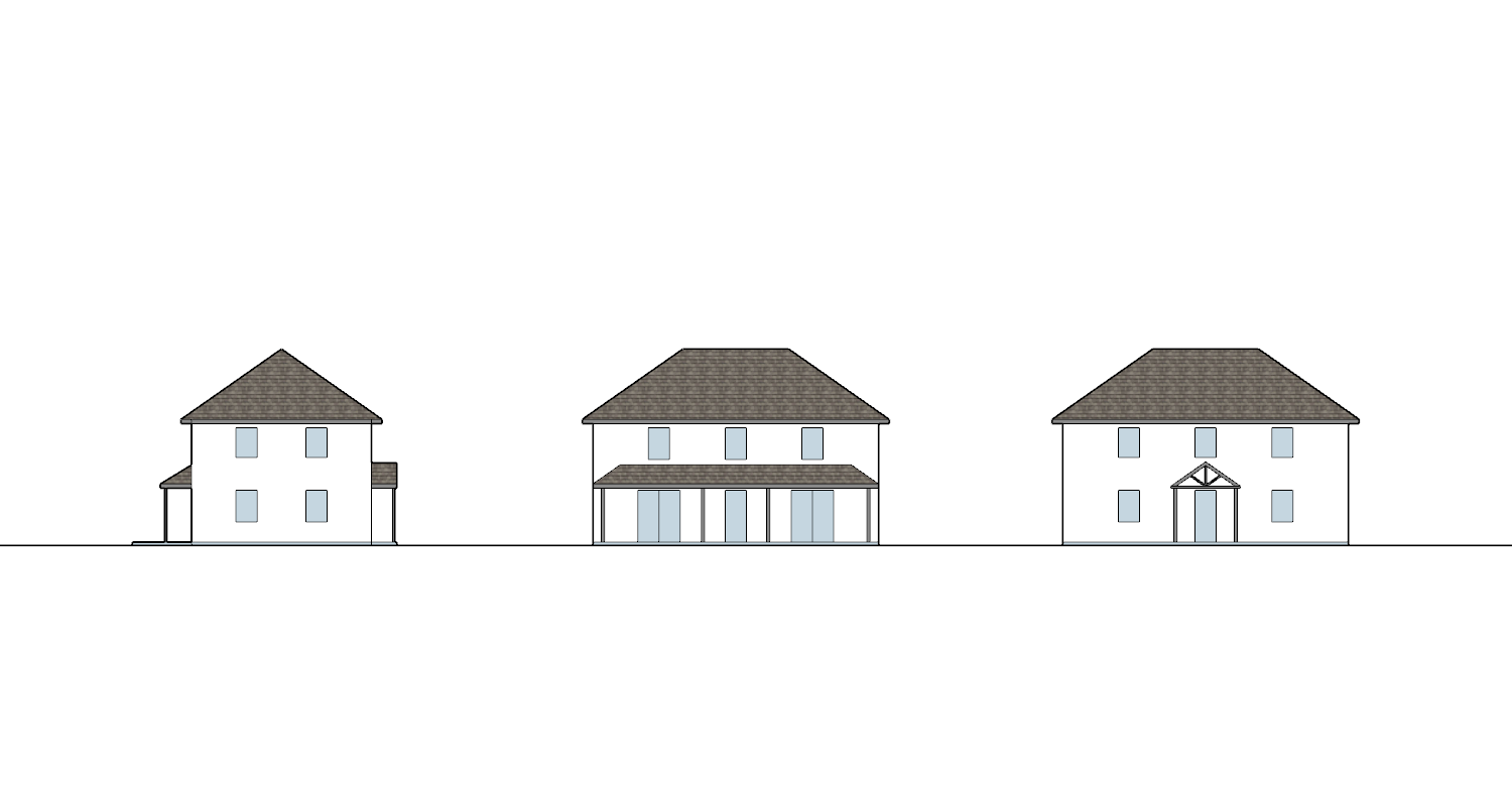

Iceverge Posted January 12, 2020 Share Posted January 12, 2020 Hi Bob, Here are our plans. This was the final of many iterations but the fundamentals were. 1. Simple rectangular shape - Cheapest, easiest to build, easiest to make airtight. Less insulation needed as less m2 wall per m2 floor. 2. Water + wet rooms all grouped in one corner. Cheapest, less pipe runs, less waste pipe runs. 3. (almost) All rooms with at least 2 windows to allow for a natural light + cross ventilation etc. 4. Old age proof - Living room can be converted to bedroom and we will have level threshold access ( as per regs ) and an accessible shower room/toilet downstairs. 5. Hip roof to ease the insulation of the eaves and provide a large overhang of the walls. 6. A realistic view of the total number of rooms we'd need and minimising the floor area and house size to this requirement. 7. A balanced handsome exterior. ( although beauty is in the eye of the beholder!) 8. No unnecessary complications. I'll have a quick blast of sketchup and see what I can come up with. Link to comment Share on other sites More sharing options...
Iceverge Posted January 12, 2020 Share Posted January 12, 2020 I'm still not 100% as to the layout of your site but on reflection would my plans be inline with what you were imagining? Link to comment Share on other sites More sharing options...
Amateur bob Posted February 4, 2020 Author Share Posted February 4, 2020 On 12/01/2020 at 20:07, Iceverge said: Hi Bob, Here are our plans. This was the final of many iterations but the fundamentals were. 1. Simple rectangular shape - Cheapest, easiest to build, easiest to make airtight. Less insulation needed as less m2 wall per m2 floor. 2. Water + wet rooms all grouped in one corner. Cheapest, less pipe runs, less waste pipe runs. 3. (almost) All rooms with at least 2 windows to allow for a natural light + cross ventilation etc. 4. Old age proof - Living room can be converted to bedroom and we will have level threshold access ( as per regs ) and an accessible shower room/toilet downstairs. 5. Hip roof to ease the insulation of the eaves and provide a large overhang of the walls. 6. A realistic view of the total number of rooms we'd need and minimising the floor area and house size to this requirement. 7. A balanced handsome exterior. ( although beauty is in the eye of the beholder!) 8. No unnecessary complications. I'll have a quick blast of sketchup and see what I can come up with. sorry i just saw this, quite like this the rooms are spacious, no office or dining room though? Link to comment Share on other sites More sharing options...
