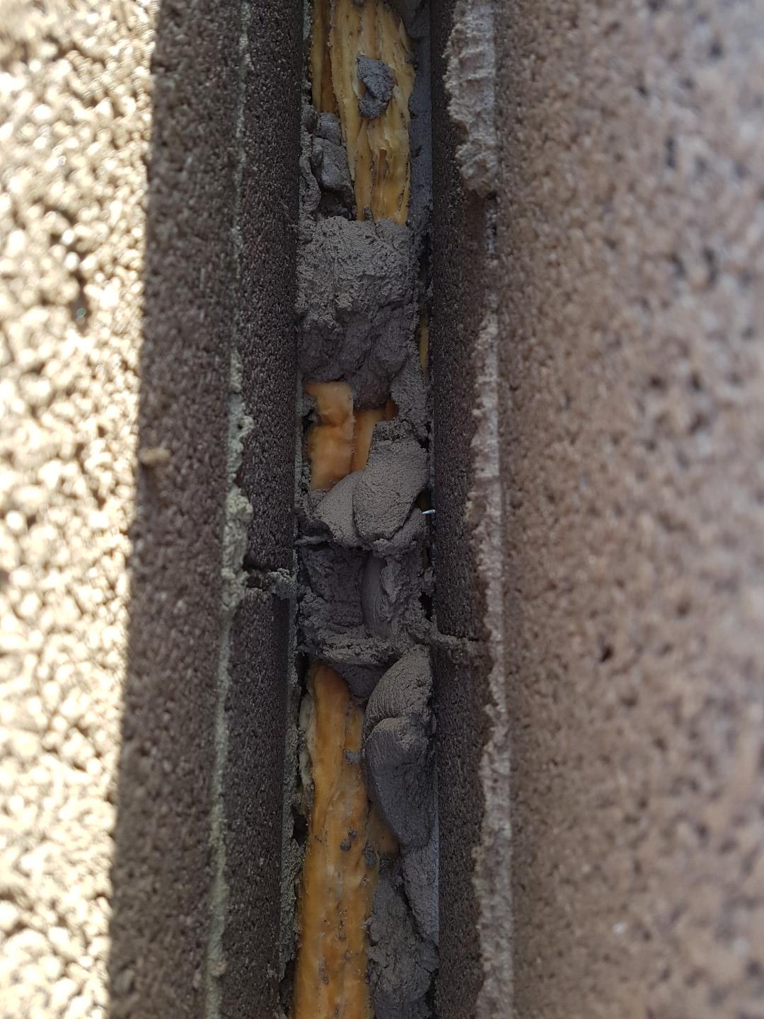

Moonshine Posted November 22, 2019 Posted November 22, 2019 (edited) 9 hours ago, Terryturf1 said: De coupled leaves ? Are you saying not to use brick ties ? no he is not, use resilient ties wall ties (Type A) correctly spaced (i.e. not too many of them). What @Mr Punter is describing is too much mortar build up / snots on the ties will cause bridging of the cavity and reduce the acoustic performance of the wall. This is particularly of note if using insulation slabs / roll in the cavity as careless brickies can let build up happen on top of the insulation slabs / roll which causes issue. Edit: if you find things like below, you want to be having a lot of words with your brickies! Edited November 22, 2019 by Moonshine

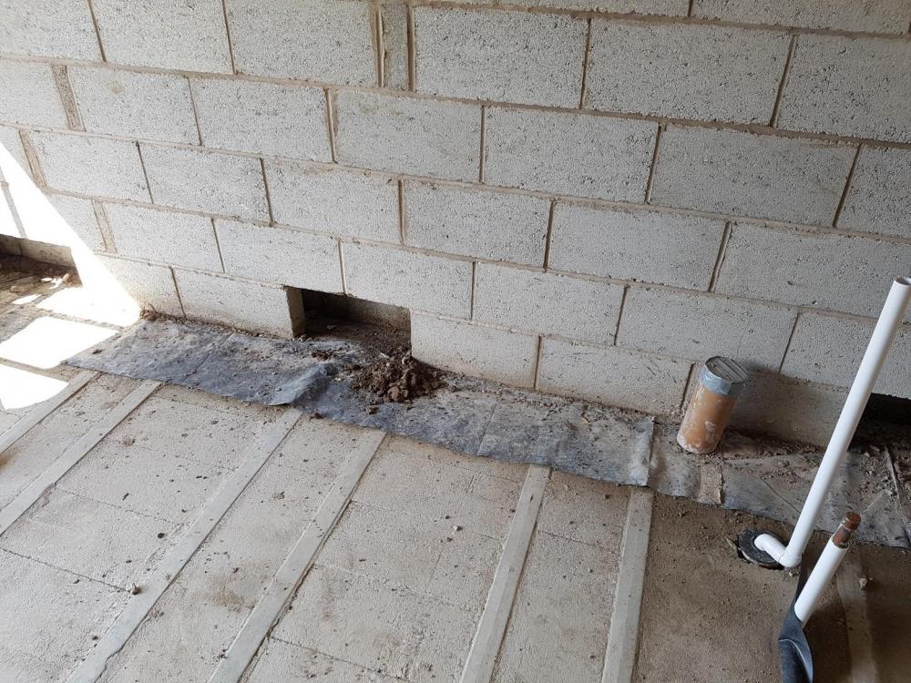

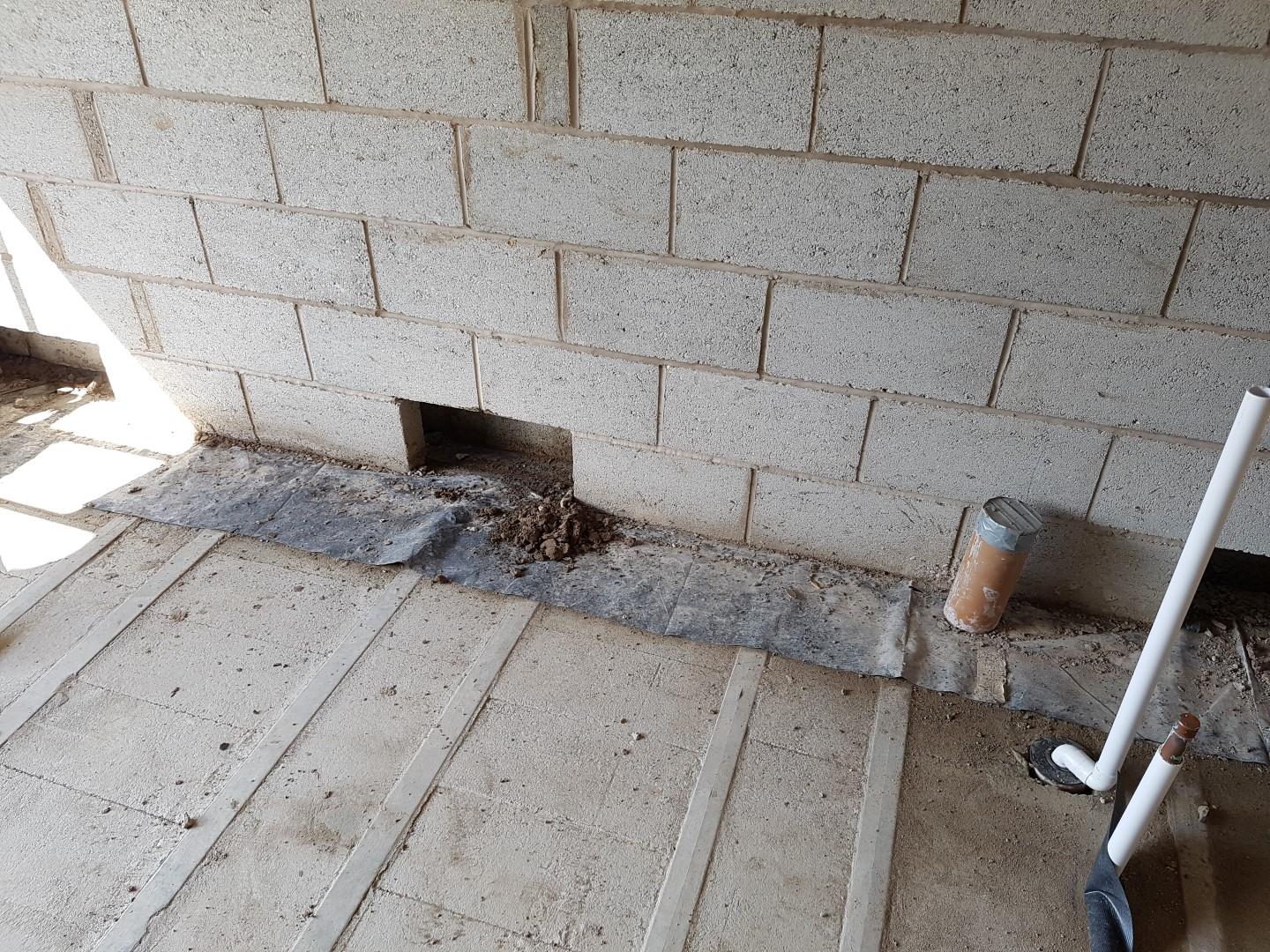

Moonshine Posted November 22, 2019 Posted November 22, 2019 (edited) 18 minutes ago, ADLIan said: mortar droppings on ties and bottom of cavity! Mortar at the base of the cavity is not usually a problem on open cavities unless the is a gas/pollution membrane at the foot of the cavity (at floor level). If there isn't this in place then mortar will just drop down to the oversite level and not a big issue acoustically. The big issue acoustically comes where there is a gas/pollution membrane at the foot of the cavity and the mortar gets trapped and the brickies don't clear it out. A way around this is to keep blocks out at the base of the cavity to allow cleaning of mortar droppings. Edited November 22, 2019 by Moonshine 1
