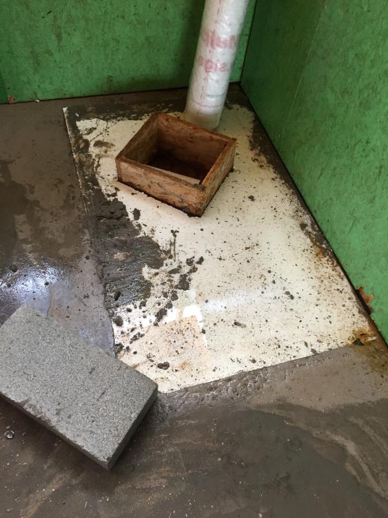

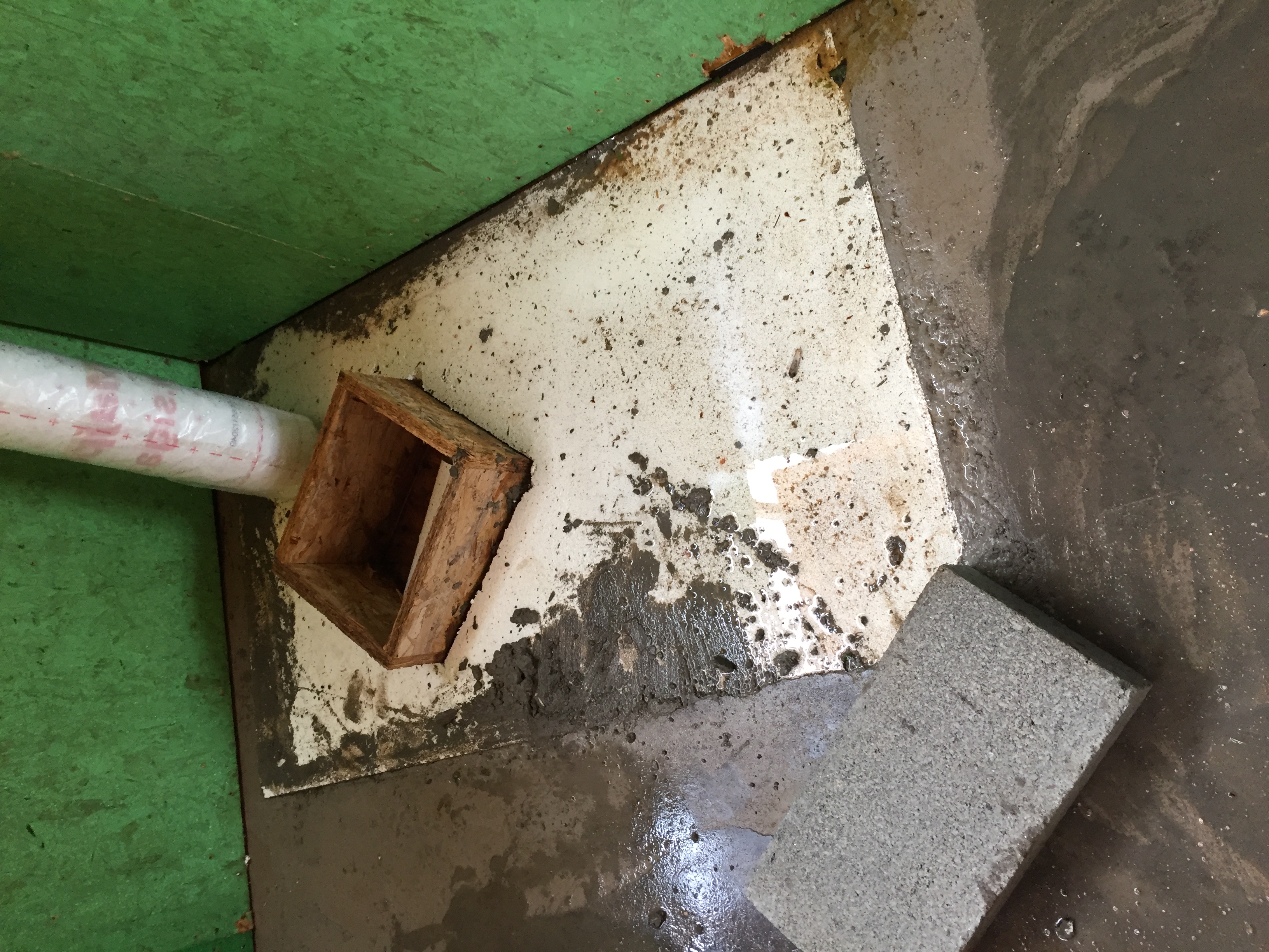

Barney12 Posted August 31, 2017 Posted August 31, 2017 Here's a couple of photos of our MBC slab where we're having a shower former in the downstairs cloakroom. We didn't apply a fall to the rest of the floor just simply positioned the waste and created a former with a sheet of polystyrene. We're having a glass screen and it will only get occasional use. The boxed section is to allow for the trap. 1
Nickfromwales Posted August 31, 2017 Posted August 31, 2017 22 minutes ago, divorcingjack said: against an internal wall for future maintenance Maintenance of what ? Almost all modern mixers are serviced from the front . Spend a little extra and go for something Mira / Vado / HansGrohe and you'll be guaranteed future service / parts availability too. Your question kind of answers itself. If you pour a bucket of water on the floor, it needs to all go down the drain. If you have a wet floor / former in the middle of the room, and no glass sides, then you need the entire room tanked all the way to the door. You need a bloody good tiler to pull this off, but it is doable. Basically you fit the shower glass to hide the fact that the tiles drop. Now you see it Now you don't. Thats basically how you'll need to do yours, with a linear drain in the middle exactly like that is. Yours will look the same, but instead of walking into the wall, where the shower is in that pic, you'll walk out the other side. So basically you'll be doing the same as I did there but mirrored. Get the wet area the same distance as the linear drains come supplied at so you have a full width drain, save for 50mm or so each end so your wall tile has a bit of floor tile to land on. Say 1000mm wide and a 900mm drain. 1

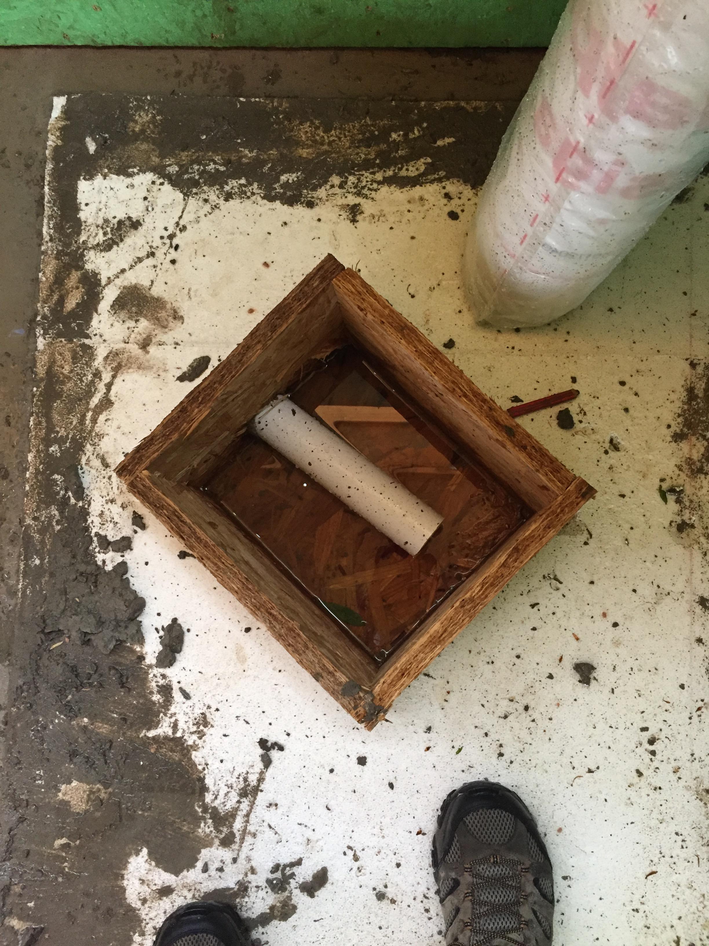

divorcingjack Posted September 11, 2017 Author Posted September 11, 2017 OK lads, as expected, this has not gone 100% to plan during the concrete pour as I was not on site. The pop up drain points are not exactly where we wanted then to be, so we're going to have to chase out a bit of the concrete to go from the shower waste to the drain. So, given that we wanted to use a linear drain - any recommendations for suppliers? Are the attached wastes normally ok (50mm)? I've been looking at the mcalpine channel drain, given that we were planning on a mcalpine top access trap previously. This one - http://www.plumbers-mate-sales.co.uk/mcalpine-shower-drain-gully-brushed-stainless-steel-4944-p.asp Any other suggestions?
IanR Posted September 11, 2017 Posted September 11, 2017 I'm happy to recommend the linear gully I used: A decent price too direct from the manufacturer.
