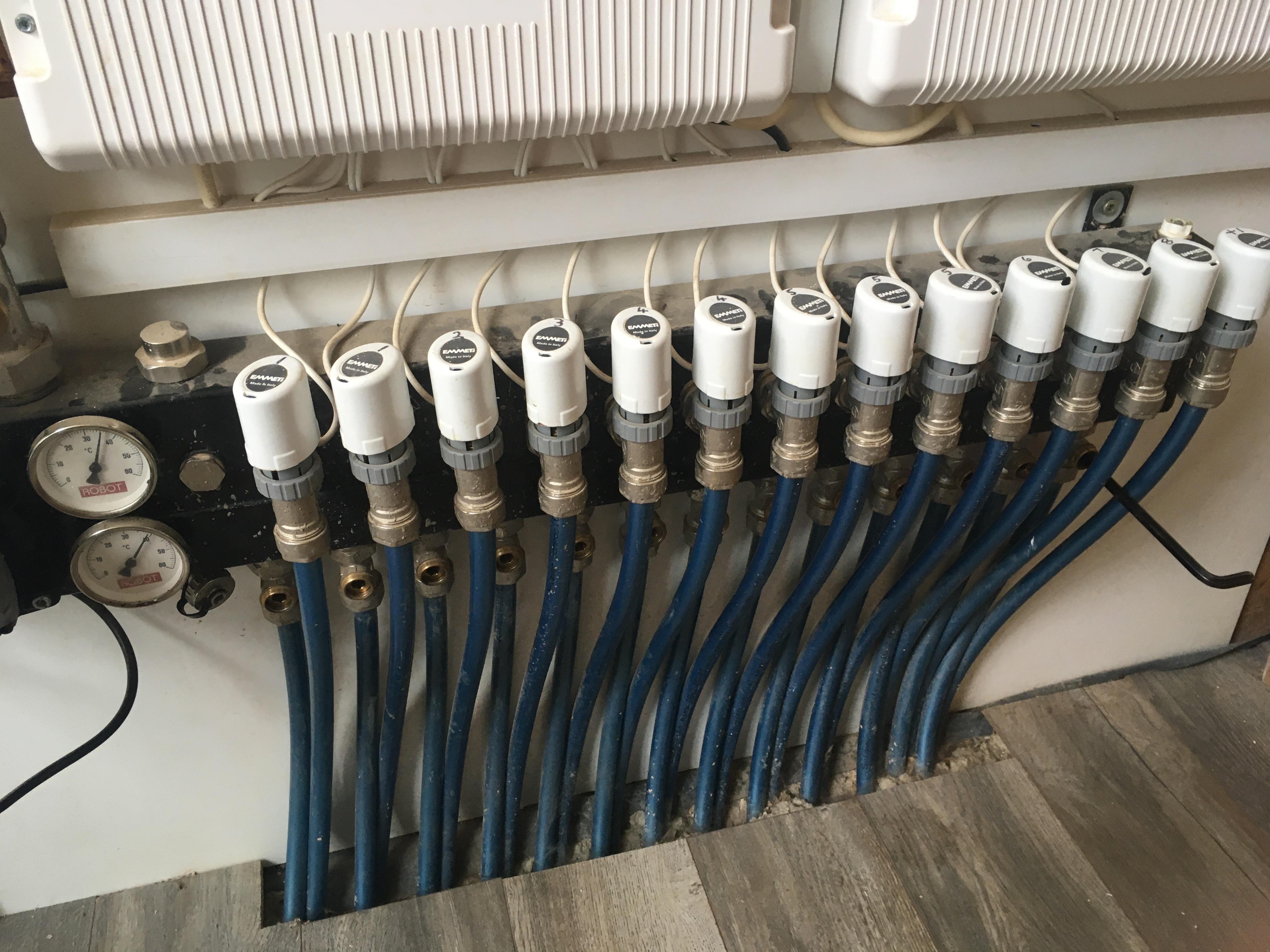

recoveringbuilder Posted November 16, 2019 Author Share Posted November 16, 2019 So , home again and back to this, hubby decided to phone the aforementioned company to check out if they’d be suitable for our system, sent in photo of our manifold and informed them of the fact we have the Heatmiser neo air stats, here is the answer he got ; “as a parts only supplier we are happy to supply them to you however what you choose to do with them is your choice, we won’t recommend you fit them to another system however they may well work” Not a lot of help! Here is a picture of the manifold if @Nickfromwales could have a look and advise please Link to comment Share on other sites More sharing options...

dpmiller Posted November 16, 2019 Share Posted November 16, 2019 stats don't matter as the wiring box interfaces the two ends... Link to comment Share on other sites More sharing options...
Nickfromwales Posted November 16, 2019 Share Posted November 16, 2019 Are the current actuators 2 wire or 4 wire? Link to comment Share on other sites More sharing options...

recoveringbuilder Posted November 16, 2019 Author Share Posted November 16, 2019 @Nickfromwales they are 2wire Link to comment Share on other sites More sharing options...
Nickfromwales Posted November 16, 2019 Share Posted November 16, 2019 If the wiring ctr gives an on / off steady voltage output then there is no reason they won’t work perfectly. 2-wire do not provide feedback so they’re dumb aka good news. Link to comment Share on other sites More sharing options...

OldSpot Posted November 22, 2020 Share Posted November 22, 2020 (edited) @recoveringbuilder Just wondered if you fitted these Salus auto balancing actuators to the Heatmiser and it worked okay? Edited November 22, 2020 by OldSpot Link to comment Share on other sites More sharing options...
recoveringbuilder Posted November 22, 2020 Author Share Posted November 22, 2020 26 minutes ago, OldSpot said: @recoveringbuilder Just wondered if you fitted these Salus auto balancing actuators to the Heatmiser and it worked okay? Yes we did and they work great Link to comment Share on other sites More sharing options...
