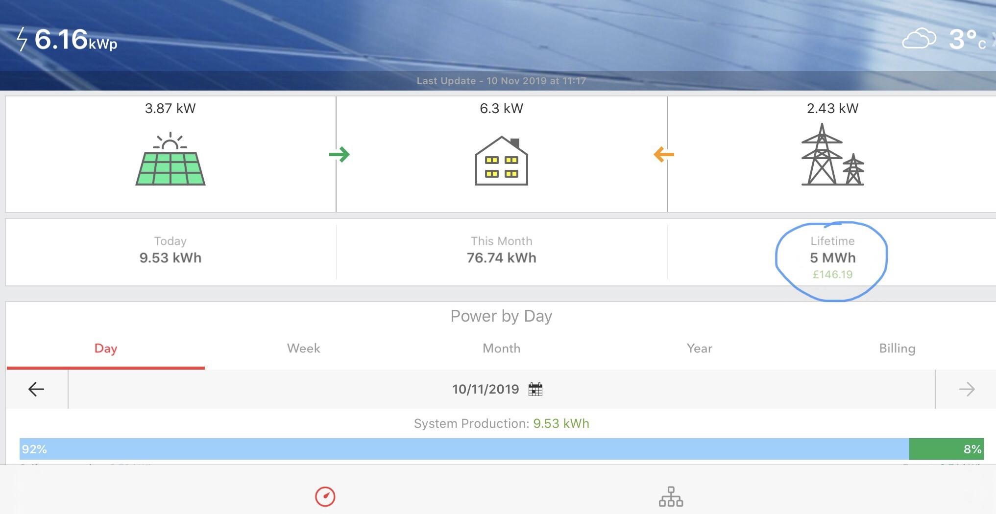

H F Posted November 10, 2019 Posted November 10, 2019 We hit our 5 MWh milestone on our solar PV system a short while ago. Almost 13 tonnes of CO2 saved from going into the atmosphere.
SteamyTea Posted November 10, 2019 Posted November 10, 2019 (edited) Interested in how you calculated the 13 tonnes of carbon dioxide. There were many times this year when we had very low fossil fuel usage, this reduced the carbon dioxide per MWh considerably. There are also regional variations. A quick look at intensity.org.uk shows that the South East, where you are, has a CI of 245g/kWh. South West, where I am is 78g/kWh. So your 5 MWh is worth 1225 kg saving, mine is 390 kg. A third of yours. Makes investing in personal RE for carbon dioxide saving rather marginal. @Ed Davies is the person that has looked at marginal differences in grid intensity. Edited November 10, 2019 by SteamyTea
H F Posted November 10, 2019 Author Posted November 10, 2019 Yikes! You impress me with your meticulous calculations. I didn’t do anything to work it out. Just used SolarEdge’s app that spits the info out. Assumed it would be correct.
Ed Davies Posted November 10, 2019 Posted November 10, 2019 Lots of ways to calculate this but whatever, it looks like there's a decimal point slip in there so it's probably more like 1.3 tonnes rather than 13 tonnes of CO₂. The current carbon index of the grid (total CO₂ emissions / total generation) is not very interesting from this point of view. Generally speaking, low-carbon power sources (renewables and nuclear) do their thing at whatever rate they can manage at the moment then gas makes up the difference. This means that any additional renewable generation (used sensibly) directly reduces the amount of gas burned so should really be “scored” at minus the emissions rate for a closed-cycle gas turbine, not the grid average at that moment. 2
H F Posted November 10, 2019 Author Posted November 10, 2019 (edited) I think you’re right Ed. My iPad app says 12k (as per the screen grab). iPhone app says 1.2k. I’ll let SolarEdge know about this. Edited November 10, 2019 by Home Farm 1
SteamyTea Posted November 10, 2019 Posted November 10, 2019 33 minutes ago, Ed Davies said: This means that any additional renewable generation (used sensibly) directly reduces the amount of gas burned so should really be “scored” at minus the emissions rate for a closed-cycle gas turbine, not the grid average at that moment. I agree with that. Though sometimes harder to work out on a time series. I think it could be worked out from the GridWatch data as that gives generation by type at the 5 minute interval, as well as demand.
joth Posted November 10, 2019 Posted November 10, 2019 1 hour ago, Home Farm said: We hit our 5 MWh milestone on our solar PV system a short while ago. Almost 13 tonnes of CO2 saved from going into the atmosphere. Nice! Thanks for sharing this. How long was it since installed? Could you explain the various numbers here? I guess 6.16kWp is max power it's ever generated, 3.87kW is current live power? Was your ASHP running at the time this image captured (or cooker on)? If so nice to have caught an unusual example of the getting over half of the space heating load from solar. 1
H F Posted November 10, 2019 Author Posted November 10, 2019 (edited) We’ve been running since March. 6.16kW is our full array - max we can produce. 3.87 is what we were producing when I took the screen grab. 6.3 is what we were consuming power wise - that would have been ASHP and dryer running... maybe even dishwasher. So we were offsetting half our power requirement with solar. Edited November 10, 2019 by Home Farm 1

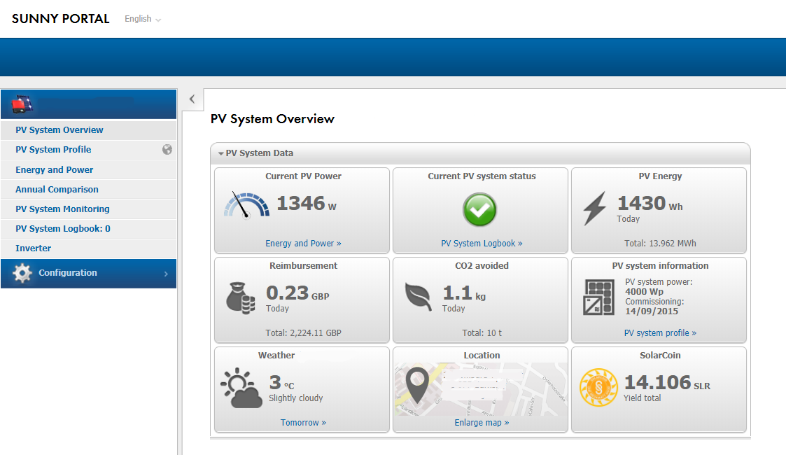

MikeGrahamT21 Posted March 6, 2020 Posted March 6, 2020 Yeah 13T sounds a bit optimistic. I've saved 10T apparently, just nearing 14MWh
H F Posted March 6, 2020 Author Posted March 6, 2020 I think there was a calculation issue when I first posted. My 1.5 tonnes sounds more realistic. What app are you using Mike?
MikeGrahamT21 Posted March 6, 2020 Posted March 6, 2020 (edited) Its Sunny Portal, from SMA, links into my SMA inverter. They even give one solar coin for every MWh I generate, not that they are worth anything at the moment! lol Edited March 6, 2020 by MikeGrahamT21

H F Posted March 6, 2020 Author Posted March 6, 2020 9 hours ago, MikeGrahamT21 said: Its Sunny Portal, from SMA, links into my SMA inverter. They even give one solar coin for every MWh I generate, not that they are worth anything at the moment! lol What are solar coins? Are they like crypto?
MikeGrahamT21 Posted March 9, 2020 Posted March 9, 2020 Yeah its a cryptocurrency, they give you one coin for each MWh you generate, but they are worthless pretty much, I suppose theres always a chance they could increase in value, unlikely id say!
