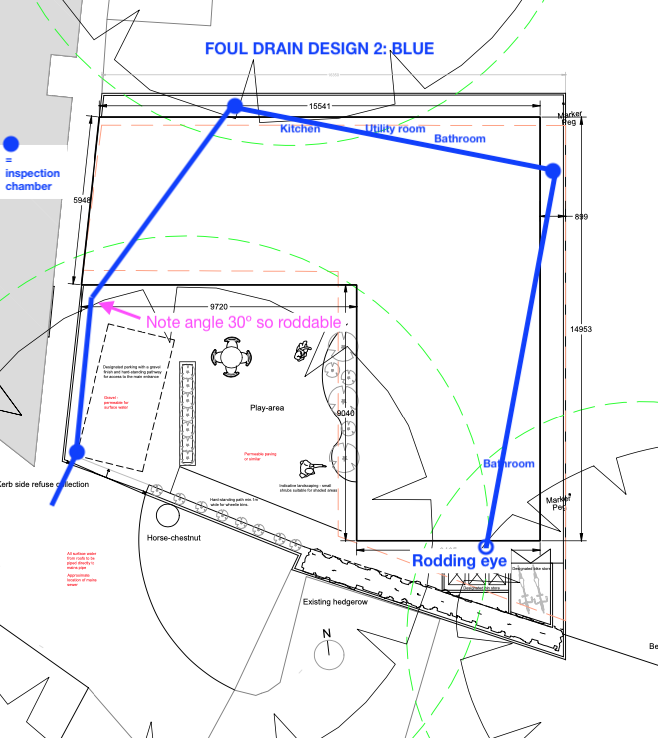

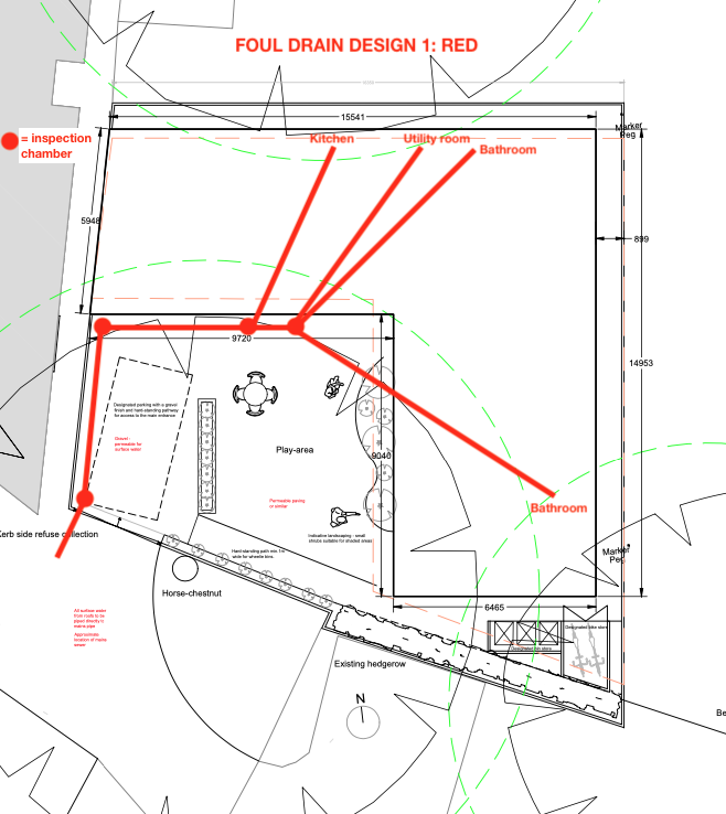

Dreadnaught Posted November 2, 2019 Posted November 2, 2019 (edited) Hi guys, which of these two foul drain run designs is better, 1 (red) or 2 (blue) and why? Edited November 2, 2019 by Dreadnaught
scottishjohn Posted November 2, 2019 Posted November 2, 2019 (edited) blue- good straight runs between the inspection chambers there is a maximum distance you should have between rodingpoints /inspection chambers --look it up why not a rodding point/chamber where it the bend is ? Edited November 2, 2019 by scottishjohn
Dreadnaught Posted November 2, 2019 Author Posted November 2, 2019 (edited) Thanks @scottishjohn. 10 minutes ago, scottishjohn said: there is a maximum distance you should have between rodingpoints /inspection chambers --look it up Yes I believe it is 22m according to Part H. 10 minutes ago, scottishjohn said: why not a rodding point where it does the bend? I think it is because rodding points are only for pipe terminations. An IC is needed for a corner > 30º. Any other votes? Edited November 2, 2019 by Dreadnaught
scottishjohn Posted November 2, 2019 Posted November 2, 2019 1 minute ago, Dreadnaught said: I think it is because rodding points are only for pipe terminations. An IC is needed for a corner > 30º IC then

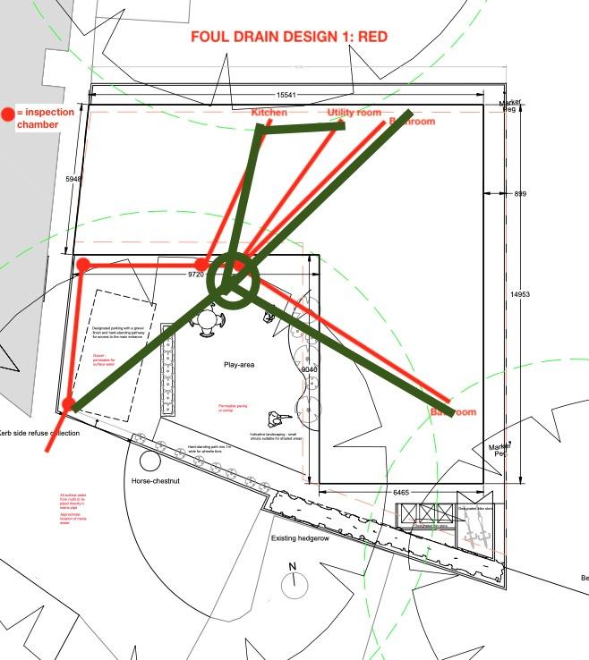

PeterW Posted November 2, 2019 Posted November 2, 2019 Neither...!! Far too complicated and you’re creating problems for yourself .... Try this - single IC and the utility to kitchen creates a decent wash through 1 2
Dreadnaught Posted November 2, 2019 Author Posted November 2, 2019 Thanks @PeterW. I like your simple approach but the council tree officer might not approve it because of the root-protection zone for the chestnut tree on the south boundary, shown with a green dotted line.
PeterW Posted November 2, 2019 Posted November 2, 2019 Done carefully that is fine ..!!! The only difference when you’re working in the RPA is that you may need to do more work by hand - I’ve had to do this - basically went within 800mm of the trunk of a sycamore but had to do all excavation manually. Just put a note that says “x to y will be hand trenched where required to avoid tree roots.” At that distance out a HC will be no more than 60-70mm thick and will be deeper than your trench ..! 1
Oz07 Posted November 2, 2019 Posted November 2, 2019 Out of the 2 i'd prefer red. Any problems only effect one run not the whole system. May be that it just works better in my head.
Dreadnaught Posted November 2, 2019 Author Posted November 2, 2019 @PeterW, in your scheme, how would one rod a blockage between the utility room and kitchen?
PeterW Posted November 2, 2019 Posted November 2, 2019 A blockage of what ..??!! Only thing in a utility should be a sink and a washing machine ..?? A 40mm waste into a 110mm swept elbow there is nothing really that can block ..? You’re not putting food or fat down it, and there is nothing such as wipes or other rubbish in the run ..?? Same with the kitchen - swept up into the floor with a socket in the top, utility tees in at 90 degrees just after the elbow and you’ll have basically 65c water flowing through that whenever your dishwasher or washing machine clears out. Washing machines are great at cleaning out drain runs - a 90c maintenance wash with a bio powder once a month will not only keep the machine clean, it will also sort the drains too ... 1 1
Mr Punter Posted November 2, 2019 Posted November 2, 2019 Red but scrap the kitchen IC. Use the bathroom near to utils in the main run inlet, with a bend just before the IC. Use the 2 inlets on the left of the IC for utils and kitchen, the R/H 45 inlet for the other bathroom and blank off the final inlet. 1

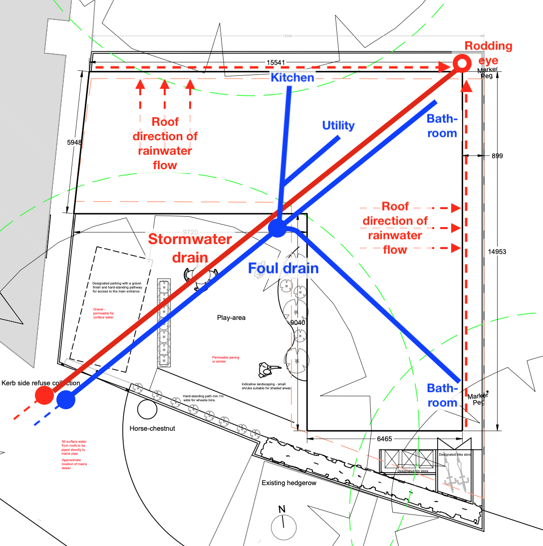

Dreadnaught Posted November 4, 2019 Author Posted November 4, 2019 Thanks everyone! Superbly helpful. Here's the new plan based on all your comments. Got it down to just 3x ICs (from 8x in the plan by the engineer). What does everyone think? Is it OK to have the ICs just outside my gate? Nobody owns the road. Would help to keep the IC's off my paving. The road is concrete. The gutters (shown as red dotted) are long, about 15m each. Is that OK with a single downpipe serving both gutters. I tried a few online calculators and think it is but not sure. Roof is 142 m². The foul run is 12m to the IC and then about 12m to the bathroom, so the max allowable. The rainwater run is about 24m, which seems OK as Part H says 45m max from rodding eye to IC (!). In the road, the storm main drain is alarmingly deep, 2.2m. The foul main drain is just 1.2m deep. Think I will need a trench box. Then I just have to convince the engineer to change his design and tree people to let me (hand-) dig nearer the chestnut tree. D. (IC = inspection chamber. Part H = building regs.) 1
Mr Punter Posted November 4, 2019 Posted November 4, 2019 I think it would be better to have the final ICs on your own land. Gutter outlet will be OK if all properly sized. Run all the drainage fairly shallow and just dive down where you are connecting into the main drain. 2
scottishjohn Posted November 4, 2019 Posted November 4, 2019 2 minutes ago, Mr Punter said: I think it would be better to have the final ICs on your own land. Gutter outlet will be OK if all properly sized. Run all the drainage fairly shallow and just dive down where you are connecting into the main drain. If on the public road then you should be using cast iron "heavy duty things - a 40 t load cast iron manhole frame and cover --very exspensive cheap galvanised one will not be fit for purpose in public road - https://www.draindepot.co.uk/600mm-x-450mm-d400-40-tonne-ductile-iron-cover-frame.html
Dreadnaught Posted November 4, 2019 Author Posted November 4, 2019 27 minutes ago, scottishjohn said: If on the public road then you should be using cast iron "heavy duty things Good point. It is not an adopted road, indeed it not owned by anyone, but it it is open to the public, although I shall be the only regular car driver across it as just beyond my entrance there is gate blocking the road which I have never seen opened.
scottishjohn Posted November 4, 2019 Posted November 4, 2019 1 minute ago, Dreadnaught said: Good point. It is not an adopted road, indeed it not owned by anyone, but it it is open to the public, although I shall be the only regular car driver across it as just beyond my entrance there is gate blocking the road which I have never seen opened. If there are other users --maybe they will have a delivery on a big artic -- which could damage a lesser cover
