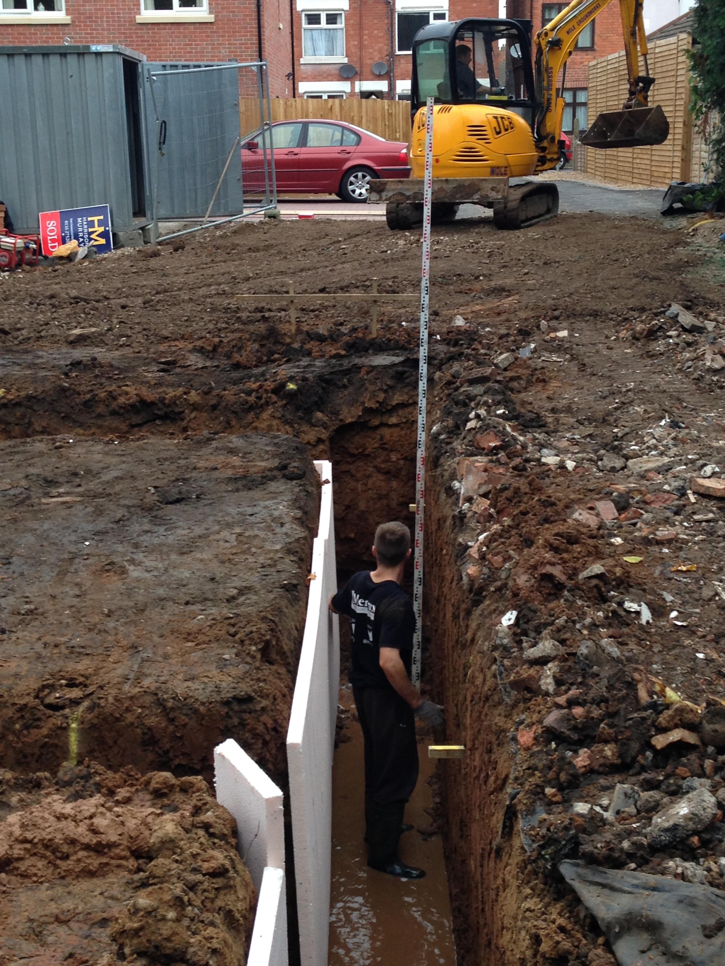

Big Jimbo Posted October 31, 2019 Share Posted October 31, 2019 Evening all. I've got about 41 lin mt of footings to pull, or have piled. I'm told by a builder who has just built 4 masonary barn style properties about 500m from me in the same lane that "Its good ground" He dug footings at a 1m deep for 2 storey masonary. Happy days you might say. However, i have trees. 2x poplar, 3x oak, 2 x silver birch, and conifers cut to about 5 m in height. Boo Hoo you now might say. I'm going to need about 10 m at 3m deep, and the remaining to be 2.5 m deep. I have not had a soil test done yet (See below) but i should find clay with flints, silt, sand, and gravel according to British Geological survey web site. Dont know yet but may have to make the trenches wider, ie; 700mm and stick in some clayboard re clay. I've got a decent size rear garden, about 100ft x 200ft, so unless what i pull out is total crap, i could prob spread most of the spoil, over the site without making much difference, or have it carted away. I think that i could do the deep founds for between 15 and 20 k allowing about 4k for muck away. I've been told by the engineer that i sould be able to get it piled, and do my own ringbeam for similar money. I've dug plenty of founds down to about 1200mm with my mini digger, but never any deeper. Any body on here dug deep founds ? Is it a pain in the butt ? 3m is bloody deep, i know, 2.5 aint exactly shallow. Am i mad to even consider it ? should i just get piles and do my 450mmx450mm reinforced ring beam ? If i was to get my own soil test (plasticity) done. (lab locally) anybody have any idea at what depth i should take the sample from ? or do i need to do several tests at various depths ? Thanks in advance gang. Link to comment Share on other sites More sharing options...

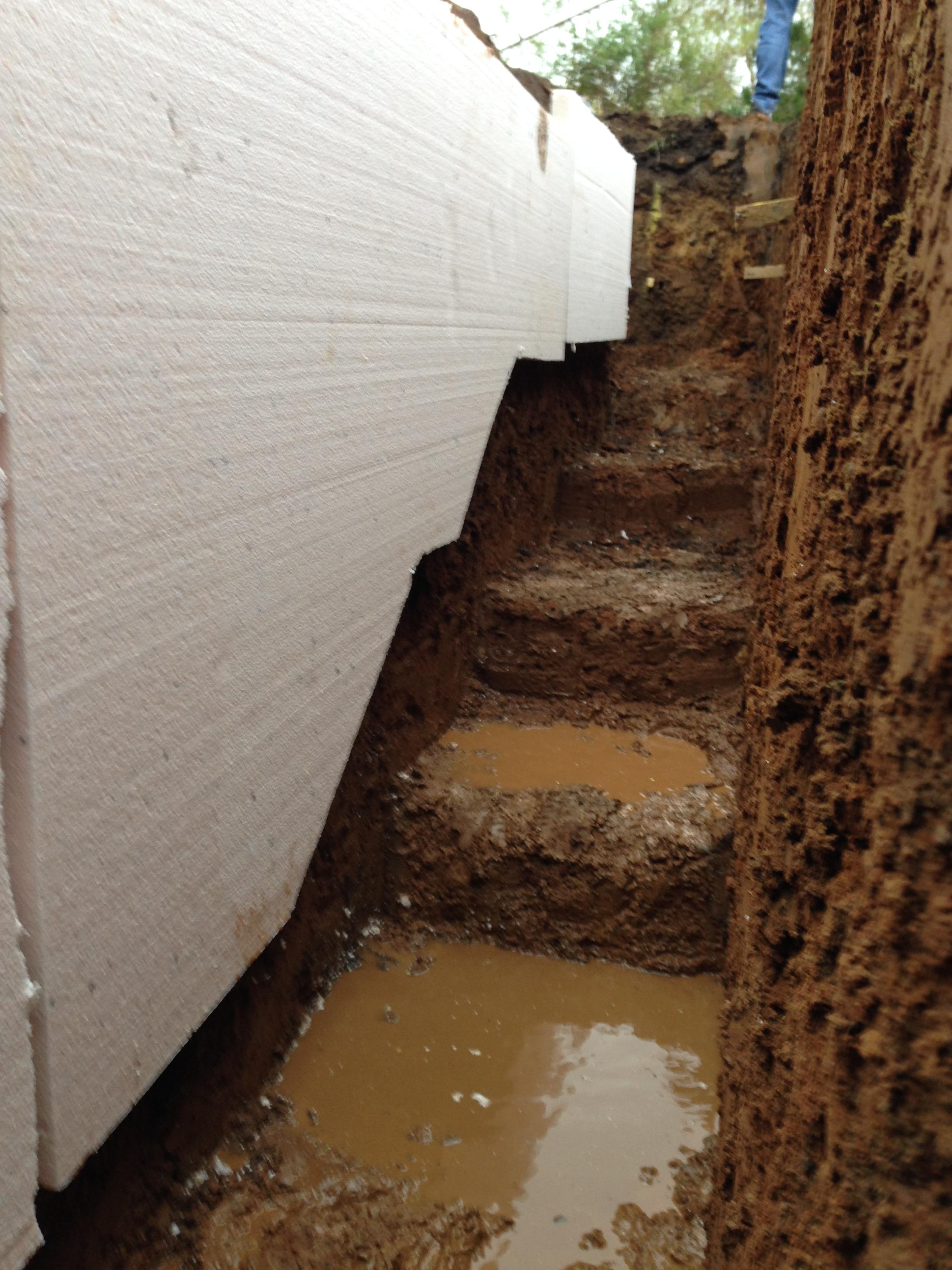

Oz07 Posted October 31, 2019 Share Posted October 31, 2019 2.4 ish pictured. Don't stand in them as pictured though. Was preferable in this case as rest of house 1.5m so saving to be made. You've just got to crunch the numbers and make sure to allow for everything you can. Piling matt etc 1 Link to comment Share on other sites More sharing options...
