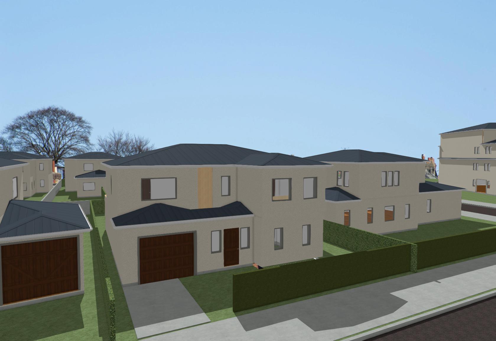

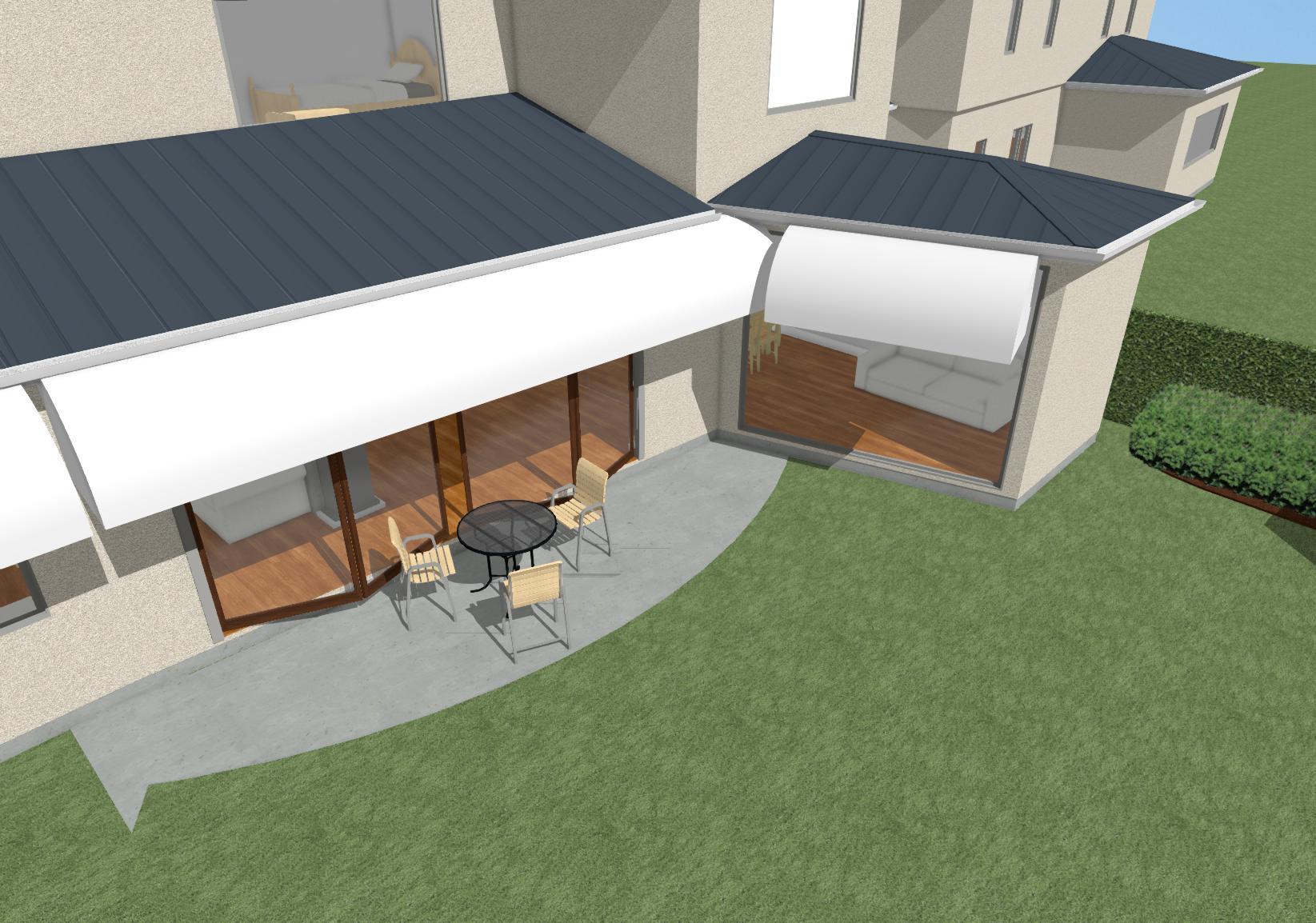

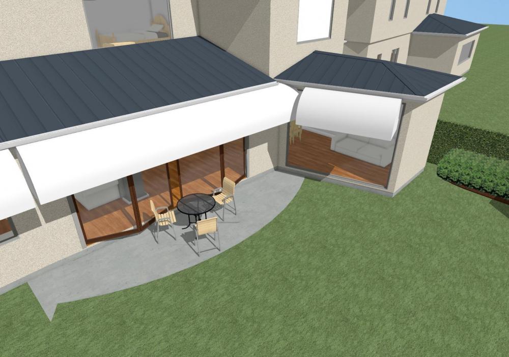

puntloos Posted October 21, 2019 Posted October 21, 2019 Angled walls - from a prettiness point of view, I like this design: As can be (kinda) seen, there are 2 unusual angles, one, to the far left between the two awnings, and the corner in the center. Pro: Prettier? More unusual design might add to resale value? Pro: Catches slightly more sun (plot is southeast-facing) Pro: Audio characteristics of an angled wall are better than straight Con: ? I can guess at the Con's, but I'm not sure: Con: Costlier to build? (how much?) Con: Harder to design properly (risk of e.g. leaks if done improperly?) Con: furniture harder to fit in non-straight corners? For what it's worth, a straight angle house would look like this: (please ignore the awning clash). I tried to make total floorspace about equal What do you all think? Better to keep it straight? Better to angle? Am I missing, or wrong, about a few Pro/Con?
Ferdinand Posted October 21, 2019 Posted October 21, 2019 (edited) it’s the angle of the dangle... (No it isn’t.) For value, you need crude floor area. Only 1 in 250 would notice that wall angle difference, few of those would give you an extra 10k for it. But an extra 10 sqm would breeze into the numbers. For sun, I would stick a tall thin window in the end. Much easier. Audio .. why do you need the better audio characteristics? Roof resolution and complexity is the curse of angled walls imo. In this, I would say play with interesting integration of the inside / outside spaces, perhaps with things like flowerbeds, landscaping, water features and bar b cues or an outdoor kitchen. Pleached lime pergola or similar, to be like the dream sequences from Gladiator? Does this proposal shade your evening light on the terrace? Edited October 21, 2019 by Ferdinand
Russell griffiths Posted October 21, 2019 Posted October 21, 2019 (edited) Our last house was shaped like a Z so lots of angles but it cannot be random they where specific parts of a 90degree corner, so two 45 opposite each other and a couple of 22.5. You will have real dramas with internal corner beads and external corner beads if you just pick some weird angle. It worked very very well in a long hall with an off set door at the end, took a fair bit of sorting out on paper first. Cost, allow a lot of extra dosh for that roof. Edited October 21, 2019 by Russell griffiths
Mr Punter Posted October 21, 2019 Posted October 21, 2019 If there is no reason to do it (like boundary or physical geographical feature) then I am not at all keen. Don't waste your money there is no WOW factor in this. The top window is clashing with the roof btw. 1

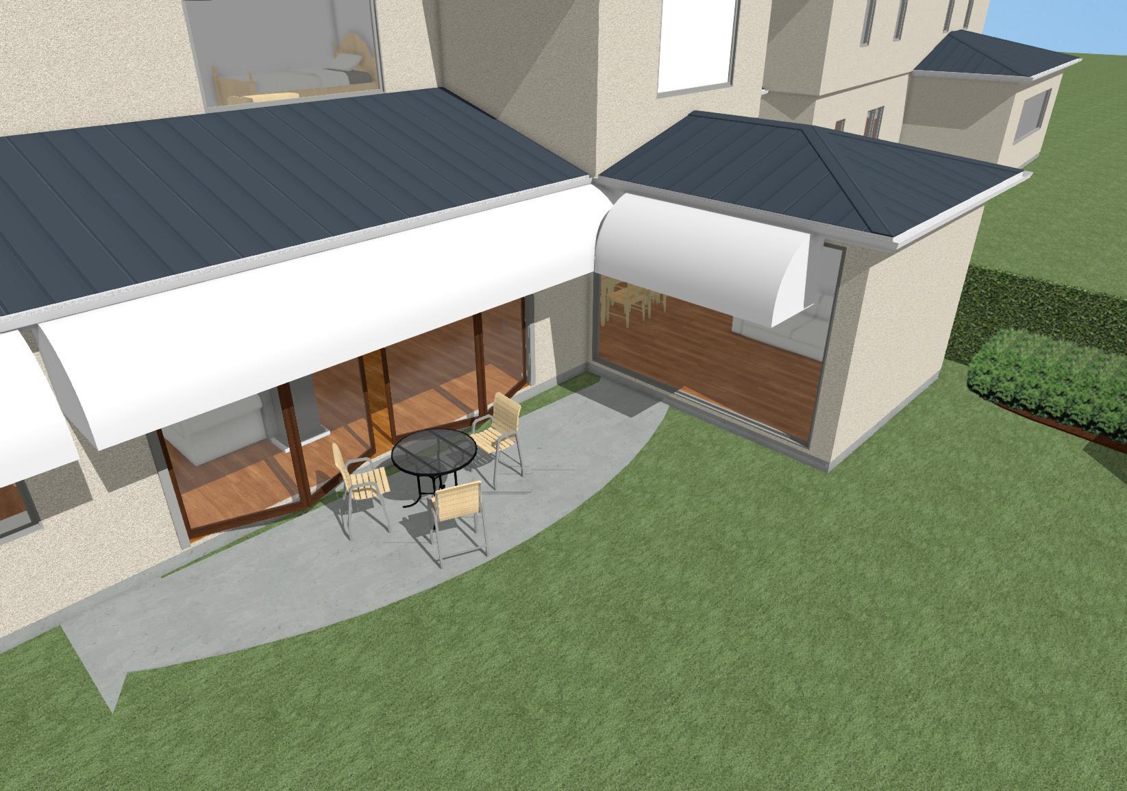

mvincentd Posted October 21, 2019 Posted October 21, 2019 Whilst I’m quite anti going to the trouble of building an aesthetically bog standard house I do think that if this is the only ‘divergent’ angle it may prove visually awkward/pleasing in equal measure. You could look at flipping to a contemporary bay window there, possibly even at a ‘cheese wedge’ angle thereby maintaining the constructionally simpler oblong at floor and roof intersections.

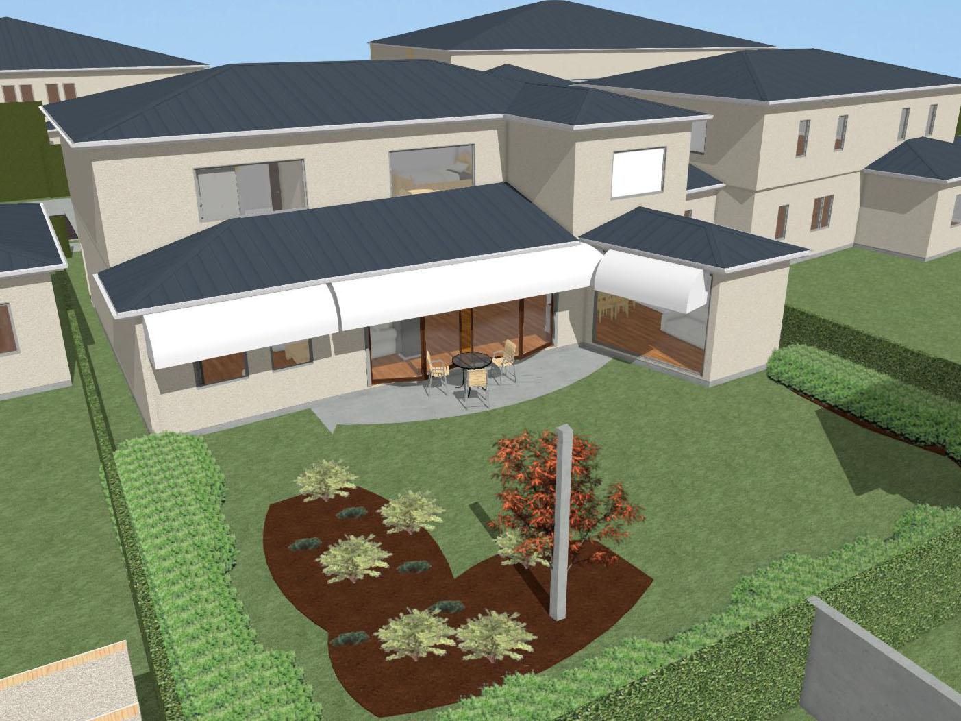

puntloos Posted October 21, 2019 Author Posted October 21, 2019 On 21/10/2019 at 16:48, scottishjohn said: to me looks like you have added extensions to an exsisiting box shaped house --not part of an actual design Expand Not the case though, which - ha - is worrying. That said this design is not my architect's - it's her job to do it 'properly' - my stuff is just playing around with what's possible. Can you elaborate though? Here's the full overview picture: Granted, if you think away the single-story bits and the small dual-story 'tower' I guess you're close to a 'box' design, but uh, at some point you have to have a functional house. What would you do to create something that looks 'built from scratch' then? @mvincentd your comments are a bit tough to parse for me, let me respond inline" On 21/10/2019 at 12:37, mvincentd said: Whilst I’m quite anti going to the trouble of building an aesthetically bog standard house Expand OK agreed - what's the point if you do something bog standard. 9 hours ago, mvincentd said: I do think that if this is the only ‘divergent’ angle it may prove visually awkward/pleasing in equal measure. Expand Do you perhaps have an example of a modest house with more consistent divergent angles? My main purpose of the divergent angle was indeed to have the house 'hug the corners' a little and back away to give maximum garden space while retaining decent floorspace. 9 hours ago, mvincentd said: You could look at flipping to a contemporary bay window there Expand You mean replace the 'box' to the far right with a large bay window? Sure, that could work fairly well, the idea of actually sitting in that 'box' to catch the last light was quite appealing. 9 hours ago, mvincentd said: , possibly even at a ‘cheese wedge’ angle Expand Not sure I understand, are you suggesting to turn the 'box' into a 'cheese wedge'? Perhaps not a bad idea but of course the tip of the wedge would be next to useless, no? Also mind that we have some local regulations that disallow facing windows to be closer than 27m. The side of the box can be a blind window in my design, preventing overlook windows looking inside. 9 hours ago, mvincentd said: thereby maintaining the constructionally simpler oblong at floor and roof intersections. Expand Given that I don't see how a cheese wedge shape can be rectangular oblong I think I lost your meaning somewhere - do you have a sample picture to illustrate?

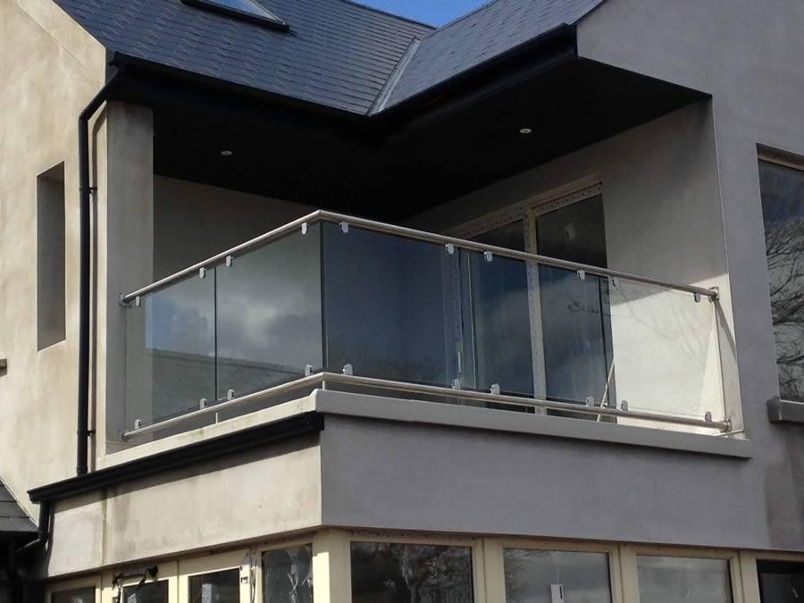

scottishjohn Posted October 21, 2019 Posted October 21, 2019 (edited) can we have a front view you seem to be cramming a very large house on that plot -- no garage or space to come round side of house how many bedrooms are they other houses in drawing real and factual ? Main roof shape looks odd to me and why have sloped roof at rear right up to upper windows,maybe making the rear roof flat and making it a walk on sun area from large upstairs window ,glass barrier balcony etc would add some style ? and in that location will such a size house be over developing the plot -which means it will not get best resale price ,cos of its location how much is the plot --how much budget for build --what is average house price on that street less than that should be your target price to build it Edited October 21, 2019 by scottishjohn
puntloos Posted October 21, 2019 Author Posted October 21, 2019 On 21/10/2019 at 22:21, scottishjohn said: can we have a front view Expand This is a rough version, but see here: Again, the roof is auto-generated, I don't know why there's a hump above the front door. 1 hour ago, scottishjohn said: you seem to be cramming a very large house on that plot -- Expand "eh" - the plot is 15*27m, and the target house size is 225sqm. It's reasonably 'fair' for this area - a town center. 1 hour ago, scottishjohn said: no garage or space to come round side of house Expand Well, there is a garage, as you can see. And there is about 1m on both sides to come round. 1 hour ago, scottishjohn said: how many bedrooms Expand 4 1 hour ago, scottishjohn said: are they other houses in drawing real and factual ? Expand Yes, they're accurate (the foot print is very accurate, the actual shape is accurate-ish for sure, the colors, ornaments, window types etc, are all not accurate, I only used the program's defaults). Of course (?) I only drew the houses that are directly relevant to me, I didn't model the entire street further out than direct neighbours. 1 hour ago, scottishjohn said: Main roof shape looks odd to me Expand Frankly this is mostly the product auto-drawing the roof. 1 hour ago, scottishjohn said: and why have sloped roof at rear right up to upper windows Expand "eh" - it seemed like a good idea at the time, else the roof would have to be a lot flatter.. 1 hour ago, scottishjohn said: maybe making the rear roof flat and making it a walk on sun area from large upstairs window , Expand We considered this but it feels like extra maintenance, it would catch water, harder to keep clean.. but maybe i'm wrong? (also- I'm not too convinced we would be allowed to have such an area, privacy of the neighbours etc.) 1 hour ago, scottishjohn said: glass barrier balcony etc would add some style ? Expand Something like this:? 1 hour ago, scottishjohn said: and in that location will such a size house be over developing the plot -which means it will not get best resale price ,cos of its location Expand Well, I think most houses in that area are indeed exactly our target ratio- 200-odd sqm on 400-odd size plots. 1 hour ago, scottishjohn said: how much is the plot --how much budget for build --what is average house price on that street less than that should be your target price to build it Expand Yep, that's roughly what we're aiming for, places near us at 225sqm with similar gardens went for a little more than what we hope to pay after all is said and done. To be clear, resale value is only a secondary motivation for us. We intend to live there for a long time. Of course we don't want to financially shoot ourselves in the foot either, but we'd favor something that works very well for ourselves rather than something that 'the generic buyer' would want. By the way thanks for the detailed responses! Keep em coming

mvincentd Posted October 22, 2019 Posted October 22, 2019 On 21/10/2019 at 21:54, puntloos said: You mean replace the 'box' to the far right with a large bay window? Sure, that could work fairly well, the idea of actually sitting in that 'box' to catch the last light was quite appealing. Expand No, keep oblong box room but make its big window a bay in a cheese wedge shape....bad example here but 1st I could find in a hurry;

puntloos Posted October 22, 2019 Author Posted October 22, 2019 On 22/10/2019 at 07:20, mvincentd said: No, keep oblong box room but make its big window a bay in a cheese wedge shape....bad example here but 1st I could find in a hurry; Expand Ah - I do think I catch your drift, so a square roof, but the window angled towards the light (which would come roughly from the picture's camera position at 1pm, and then moves towards the left of the picture..) Interesting idea, i'll mention it, thanks!
