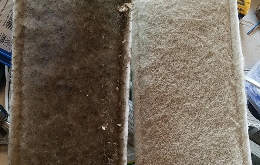

I checked our filters after about four months..
Intake on the left. Loads of tiny tiny flies, and I fear the brown tint is caused by the amount of slurry dispensed locally. Loads of horses nearby too. The exhaust side is all concrete dist off the (unsealed) subfloor.

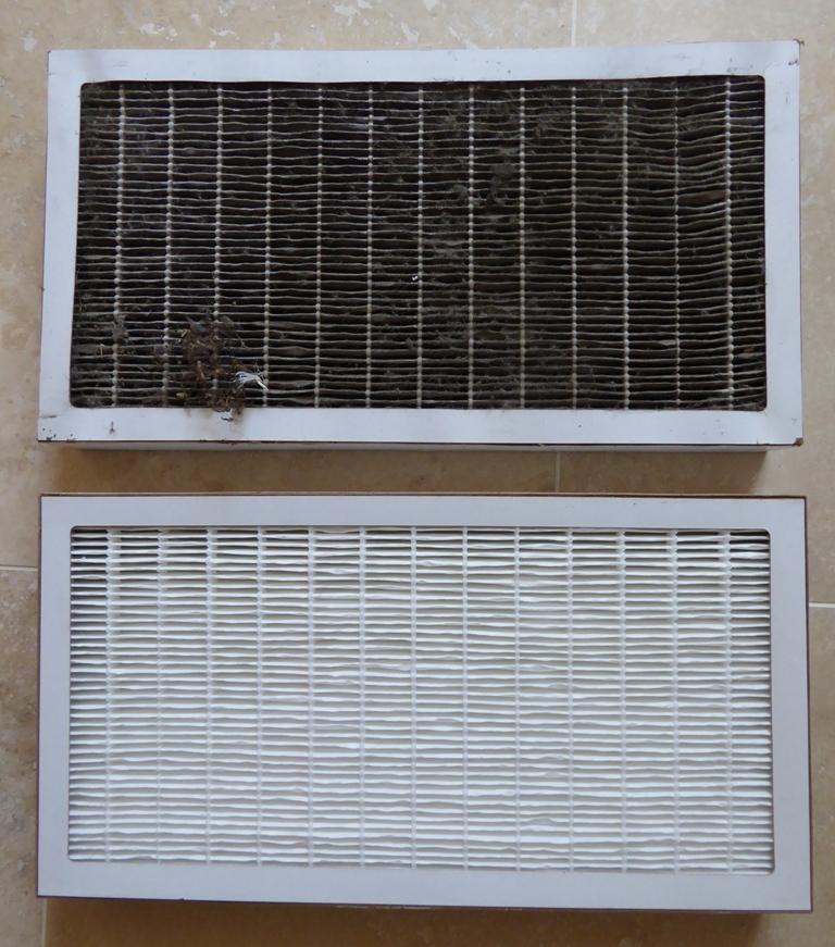

The chamber on the outside of both filters gets a bit grubby, especially the intake side.  The room extract side gets a bit of fine dust in the chamber, but far less than the intake side.  I also find loads of dead flies, spiders etc in the intake side chamber, before the filter, and the filter always looks pretty grim.  Here's a photo comparing a new intake filter with one that's been used for 6 months:
I took the heat exchanger out this summer, to check it and wash it if needed, but found that it seemed very clean, so just put it back.  I suspect that the filters in the Genvex do a good job of keeping stuff out of the heat exchanger, especially the one on the intake side (the intake has an F7 pollen filter, the extract has a G4 dust filter).
@JSHarris wow your intake filter sure working hard/ doing a good job.
