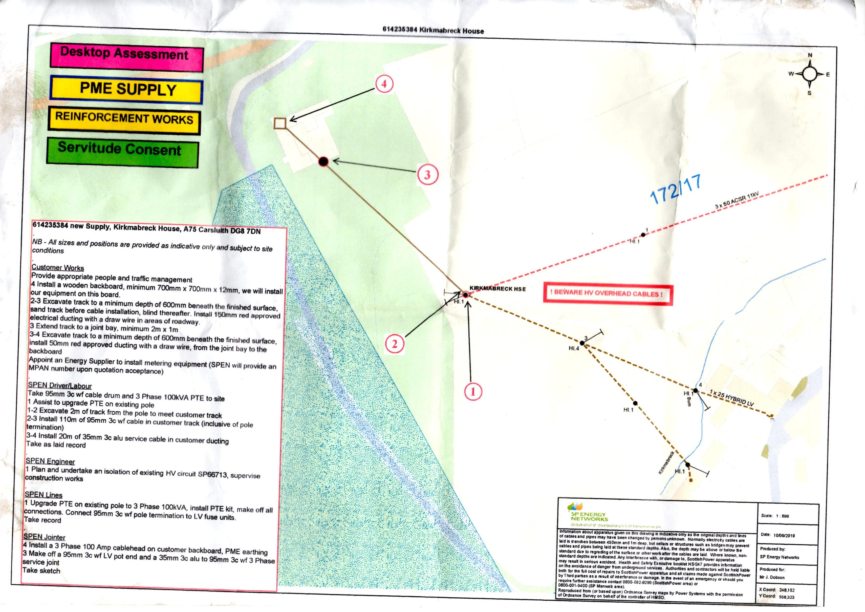

Amateur bob Posted October 25, 2019 Author Share Posted October 25, 2019 progress with the electric estimate today, a strange quote though as ive been given a range The likely connection charge is anticipated to be in the range of £3,500.00 to £9,500.00, which are for indicative purposes only and does not constitute an offer of terms by Scottish and Southern Electricity Networks. The lower range is based on Scottish Hydro Electric Power Distribution plc providing 1x supply at 1 phase (minimum load) for the entire development based on customer carrying out all excavations on site. The higher range is based on Scottish Hydro Electric Power Distribution plc providing 1x supply at 1 phase and upgrading the existing transformer to accommodate new load request (based on 100amp supply) on site, based on customer carrying out all excavations on site. Link to comment Share on other sites More sharing options...
scottishjohn Posted October 25, 2019 Share Posted October 25, 2019 assume you will need and upgraded transformer Link to comment Share on other sites More sharing options...
Amateur bob Posted October 25, 2019 Author Share Posted October 25, 2019 1 minute ago, scottishjohn said: assume you will need and upgraded transformer just to be safe with budget or is it a likely scenario? for some reason in the quote theyve sent me the cable runs from a pole towards my plot but stops about 30m short of my plot, do i run a seperate cable from there to the house myself or is it more likely an error theyve made? i marked clearly on the map exactly where house plot would be, thanks! Link to comment Share on other sites More sharing options...
scottishjohn Posted October 25, 2019 Share Posted October 25, 2019 (edited) 8 minutes ago, Amateur bob said: just to be safe with budget or is it a likely scenario? for some reason in the quote theyve sent me the cable runs from a pole towards my plot but stops about 30m short of my plot, do i run a seperate cable from there to the house myself or is it more likely an error theyve made? i marked clearly on the map exactly where house plot would be, thanks! i would happily have you a bet that when they come to do it --they will decide it would be good if you paid to renew their old transformer . LOL so yes take the higher quote as being the right one --only good news if its the lower one the last distance i am guessing they will want you to supply a ducting for the cable that can be replaced later ,if needed without having to dig up anything-- last 20m always has to be ducted on any supply If you know where and what why not get an actual quote that is fixed for 6 months If that is not inside new house then you will need to make a meter house for them and then you run from that to your house Edited October 25, 2019 by scottishjohn Link to comment Share on other sites More sharing options...
scottishjohn Posted October 25, 2019 Share Posted October 25, 2019 with proper quote you will get a plan that looks like this Link to comment Share on other sites More sharing options...
Amateur bob Posted October 25, 2019 Author Share Posted October 25, 2019 4 minutes ago, scottishjohn said: with proper quote you will get a plan that looks like this what are points 3 and 4 on the map? Link to comment Share on other sites More sharing options...
Amateur bob Posted October 25, 2019 Author Share Posted October 25, 2019 heres the quote sent back, ive put a red cross where the plot will be, they rectangle with red circle is where elec company have quoted to run cable to for some reason! Link to comment Share on other sites More sharing options...
