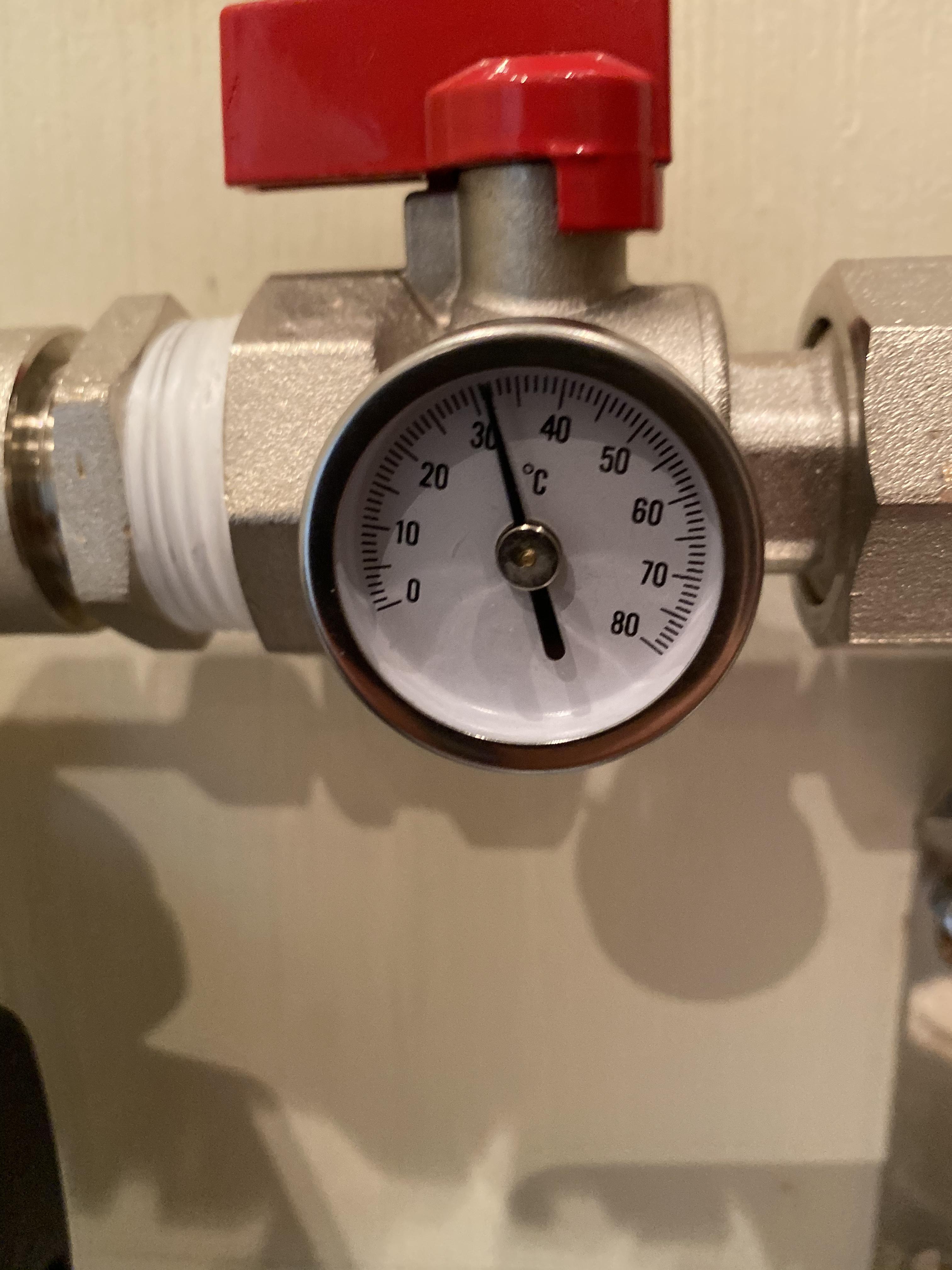

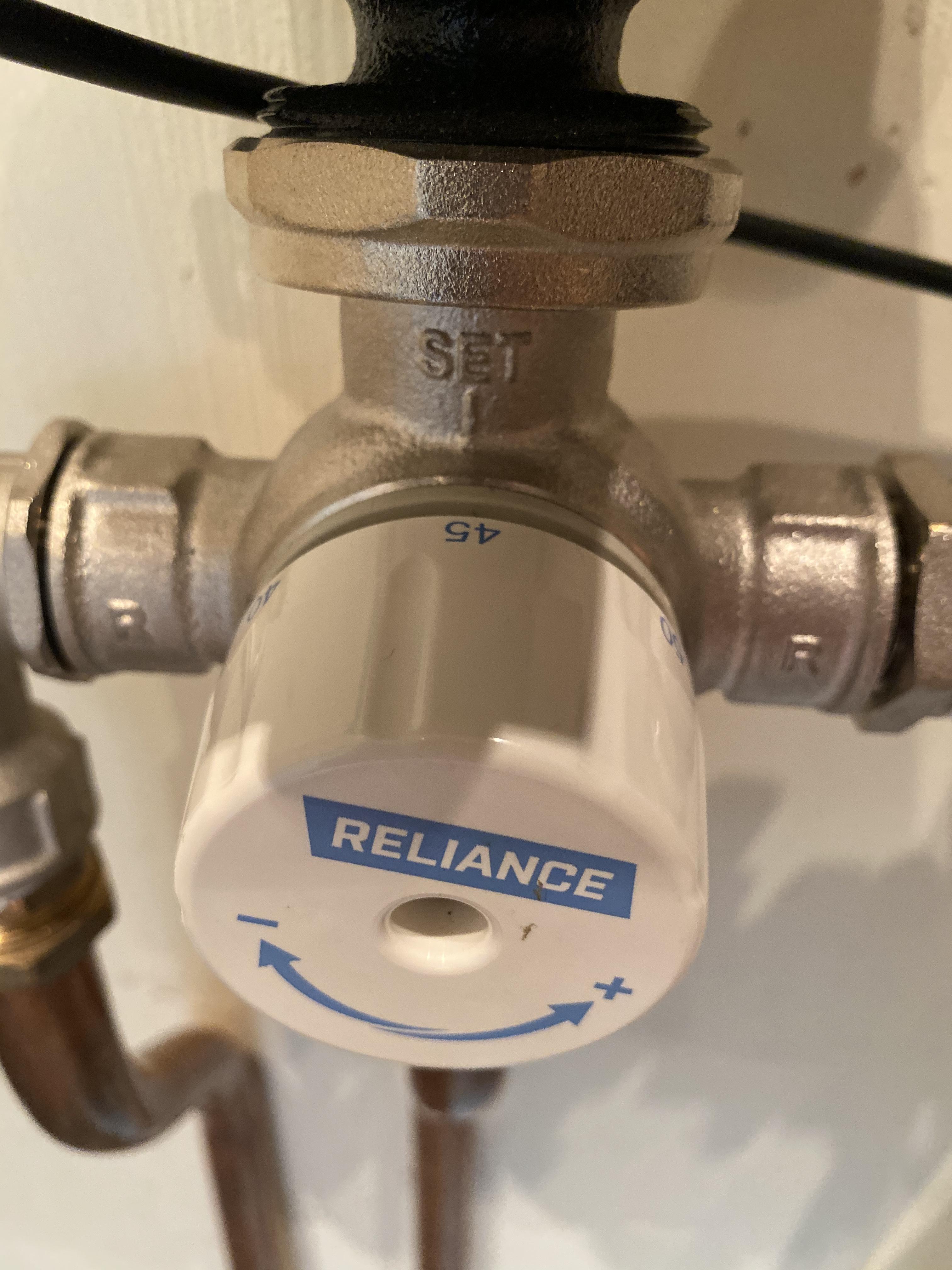

Benjseb Posted October 6, 2019 Posted October 6, 2019 I have an ASHP which runs UFH and rads the flow temp from the heat pump is usually 38-45c Wr can run the UFH at a lower temp than this. However, the valve seems a bit... shit. if I set to 35c I only get flow temp of 25. If I set to 45, it gets to about 30-35. However that 10c difference changes depending upon the heat pump flow temp. The instructions for the valve state that for it to work correctly the incoming hot flow needs to be approx 15c higher than the desired temp. is that normal? Or have a just got a cheap mixing valve? ideally I’d like the UFH to stay at about 35 as it’s only really the rads that need a higher temp when it’s cold. 1
ProDave Posted October 6, 2019 Posted October 6, 2019 I just set the flow temp I want as the "heat pump water leaving temperature" and let the HP control it. the mixing valve is then irellevant. Not many of them work properly at low temperatures.

Temp Posted October 6, 2019 Posted October 6, 2019 1 hour ago, Benjseb said: The instructions for the valve state that for it to work correctly the incoming hot flow needs to be approx 15c higher than the desired temp. That sounds like the valve might have a limited range. Eg it can't mix 100% flow and 0% return but limits at say 90% flow and 10% return? 1 1

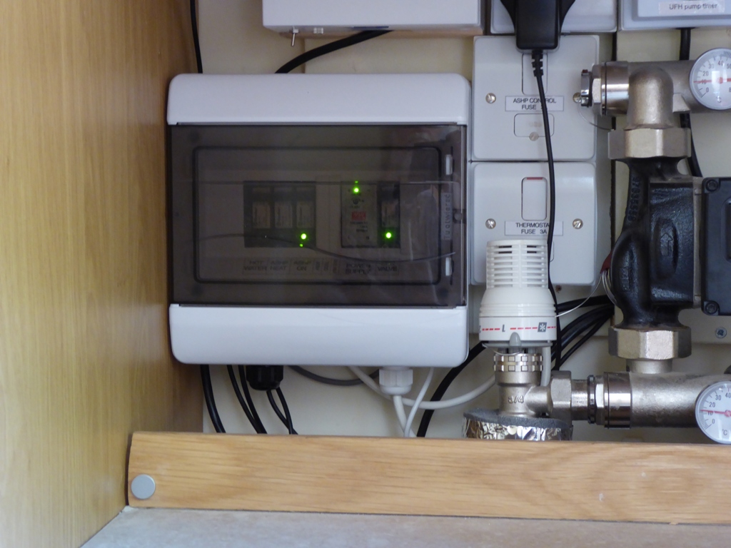

Jeremy Harris Posted October 7, 2019 Posted October 7, 2019 17 minutes ago, ProDave said: Nope totally confused. Diagram needed. Every blender I have seen has 4 ports and does not have a removable actuator with an M30 thread. So I am now at a complete loss to know where you would put one of these Salus proportional actuators. This is the thermostatic valve and hot feed into the UFH manifold: Hot water from the ASHP/buffer comes in at the bottom of that valve. Temperature controlled water comes out of the right hand arm. The tee where the pump connects is key, as that causes the pump to be able to recirculate return water (coming from the return manifold at the lower right). The output from the pump is at the top, and only feeds the flow manifold. The temperature sensor for the thermostatic valve is in a pocket inside the end of the flow manifold. The Salus actuators just fit where normal actuators fit, each with a flow and return sensor clipped to the UFH pipes.
