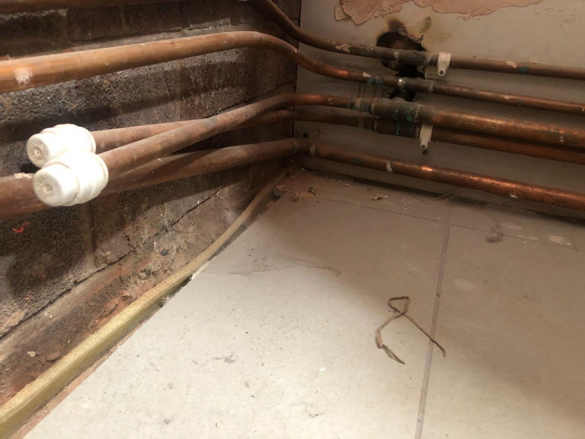

daiking Posted June 27, 2019 Author Share Posted June 27, 2019 I have some areas(won’t be visible) I can’t finish with a tiled upstand. As this is an area where there could be leaks/spillages, I’d like some sort of other solution. I’m thinking that an aluminium angle profile, approx 25mm high, stuck to the tiles around the perimeter will do the job? Link to comment Share on other sites More sharing options...
