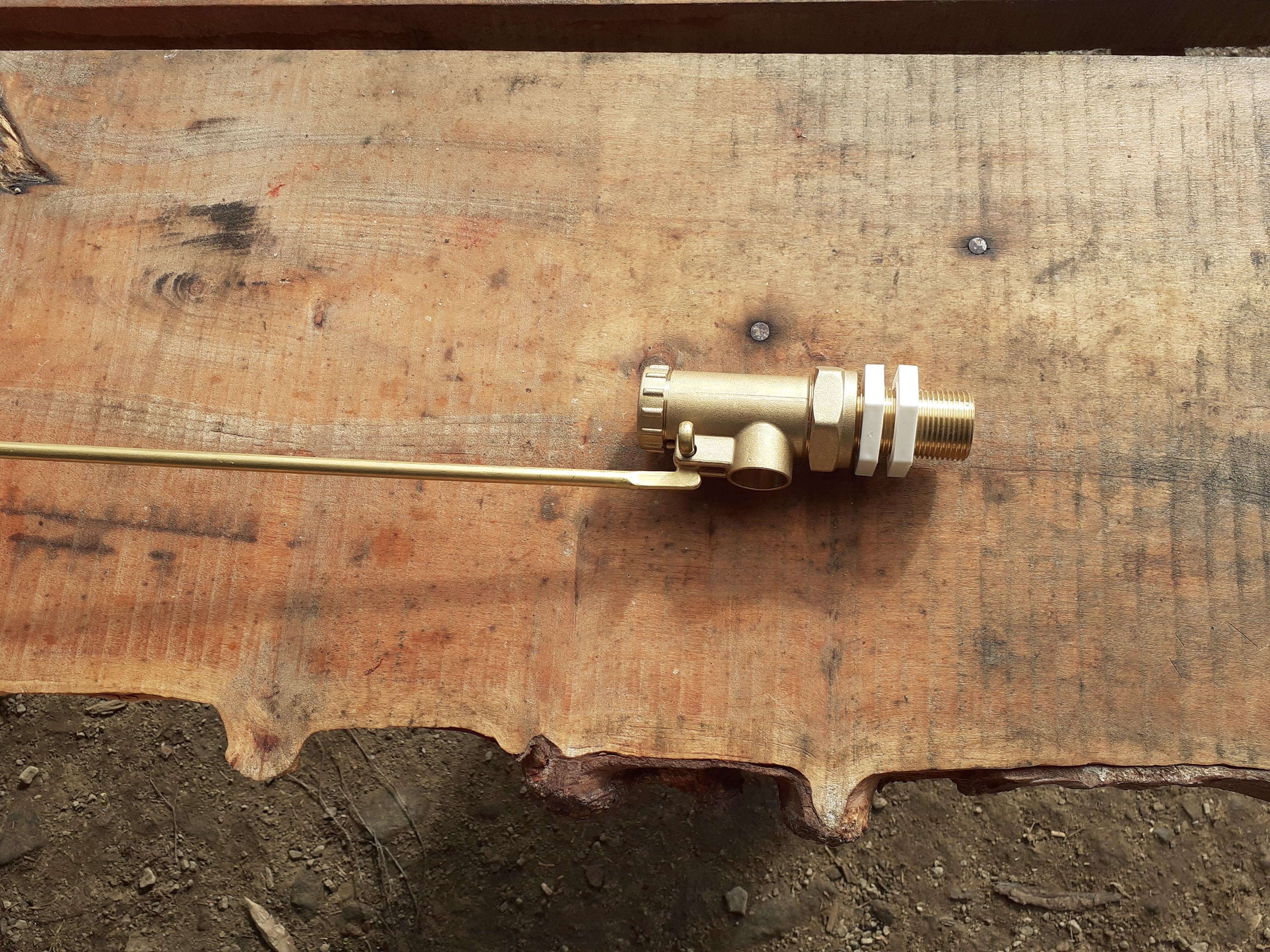

jamieled Posted September 23, 2019 Posted September 23, 2019 I have a float valve for our water tank, used for our private supply: It has two plastic nuts on the brass thread. I am assuming that one nut ends up on either side of the tank wall, but that doesn't seem like it would give a great seal. Then again, maybe it doesn't need to as the tank water level shouldn't reach the level of the valve inlet. Any insights from those in the know?

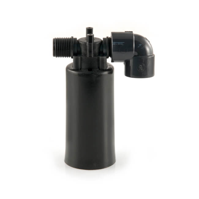

Jeremy Harris Posted September 23, 2019 Posted September 23, 2019 Yes, just one nut either side. No, they don't provide a totally watertight seal, but they shouldn't need to, as the overflow pipe will be lower. As an aside, my preference is to use magnetic servo float valves for this job, as they are a heck of a lot more reliable, and are pretty foolproof, as there is no exposed float, lever arm, moving valve piston etc, they are essentially identical to a diaphragm operated solenoid valve but with the solenoid replaced by a magnet within a float, with that float inside a tube, so it can't get fouled up on anything. Here's an example of one: https://www.bes.co.uk/abertax-magnetic-water-inlet-valve-21341 1
jamieled Posted September 23, 2019 Author Posted September 23, 2019 @JSHarris many thanks, as well as the tip about the servo valve. Hadn't come across that before.
Jeremy Harris Posted September 23, 2019 Posted September 23, 2019 1 minute ago, jamieled said: @JSHarris many thanks, as well as the tip about the servo valve. Hadn't come across that before. I found them by accident, years ago, when we had a really difficult to get at header tank in the loft, that made adjusting the ball cock a job for a contortionist. The Abertax valve just worked out of the box, and was dead reliable. It also has a very quick shut-off when the right level is reached, with none of the slow dribbling you sometimes get from a ball cock.
