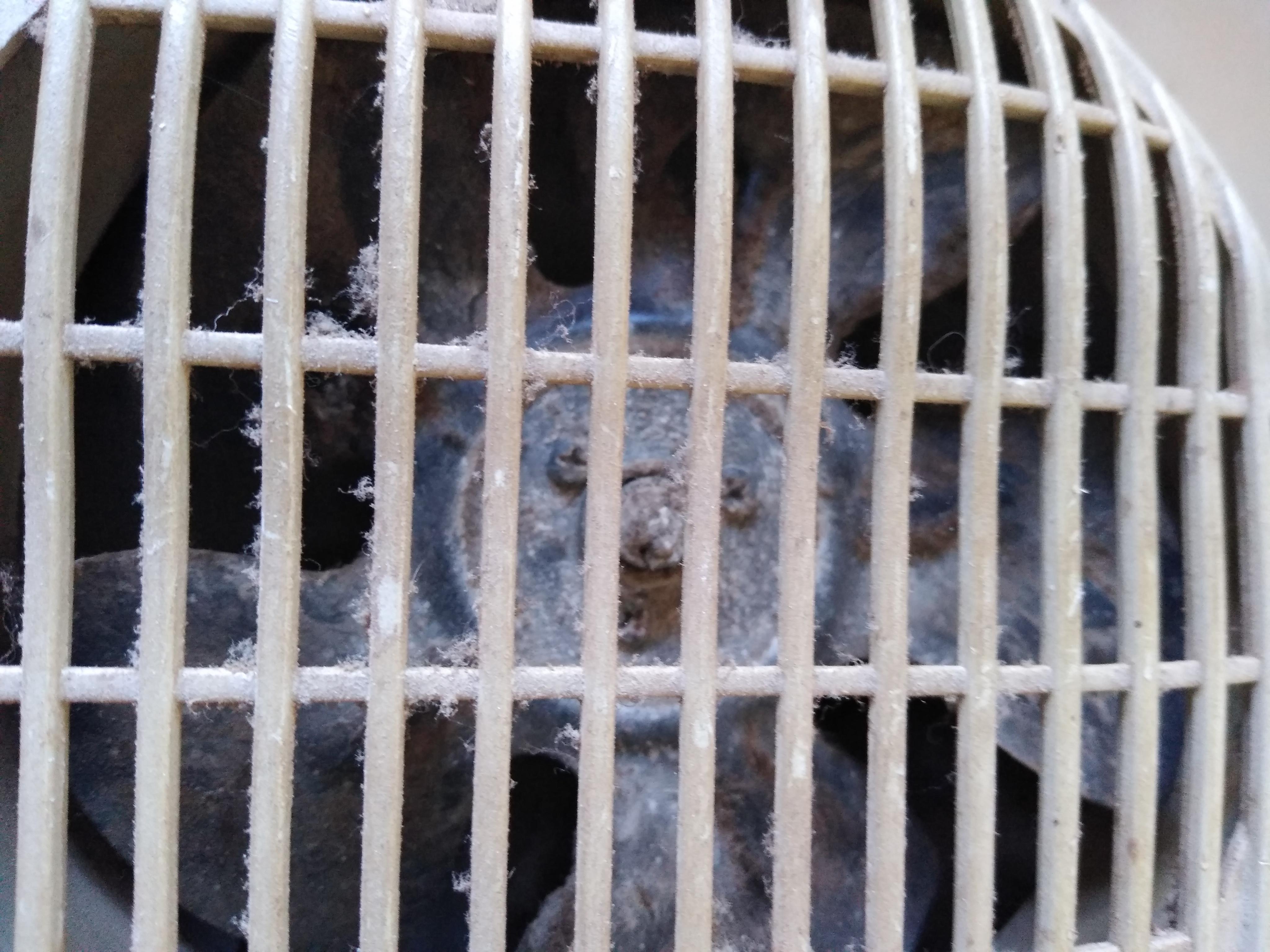

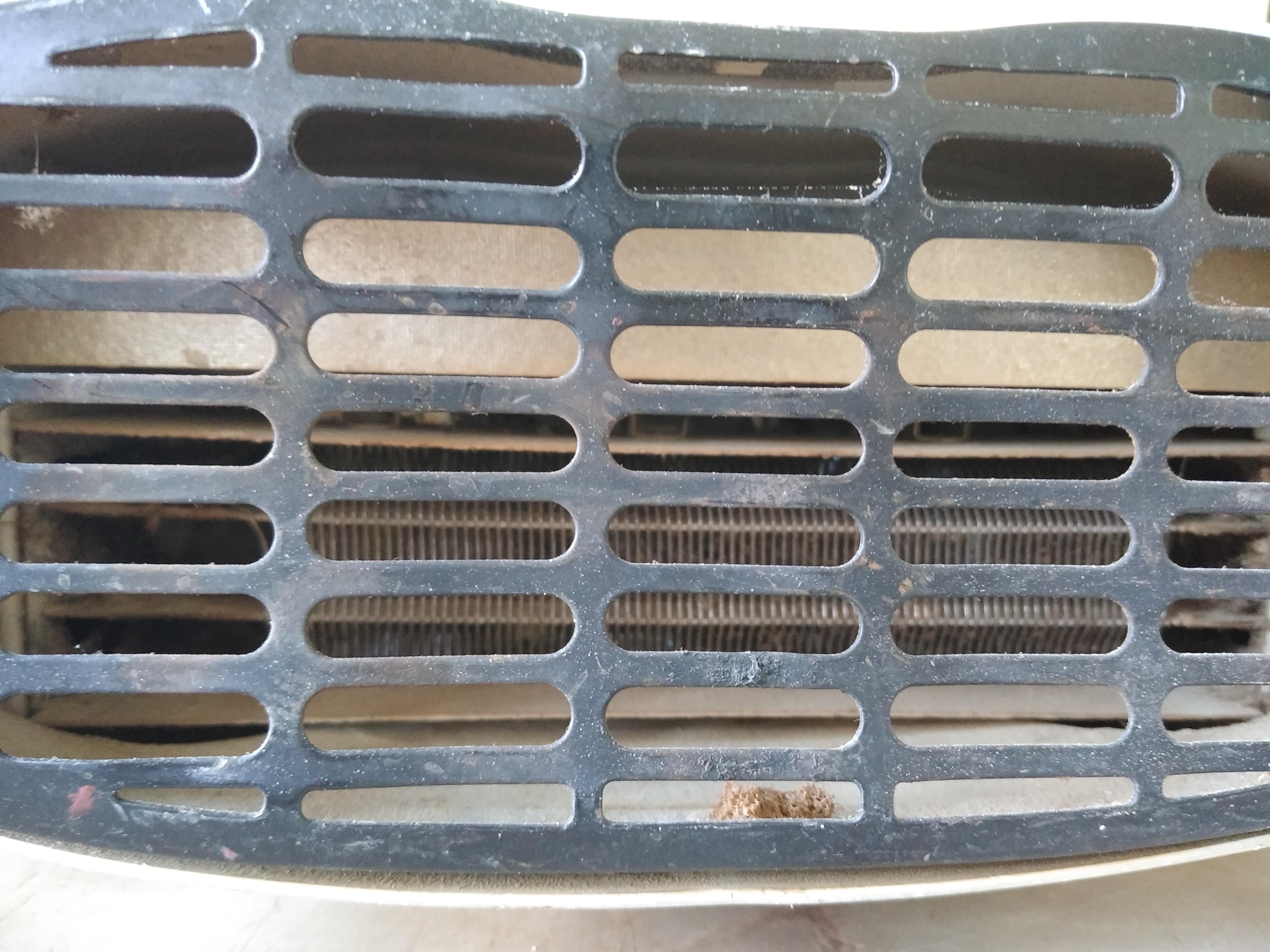

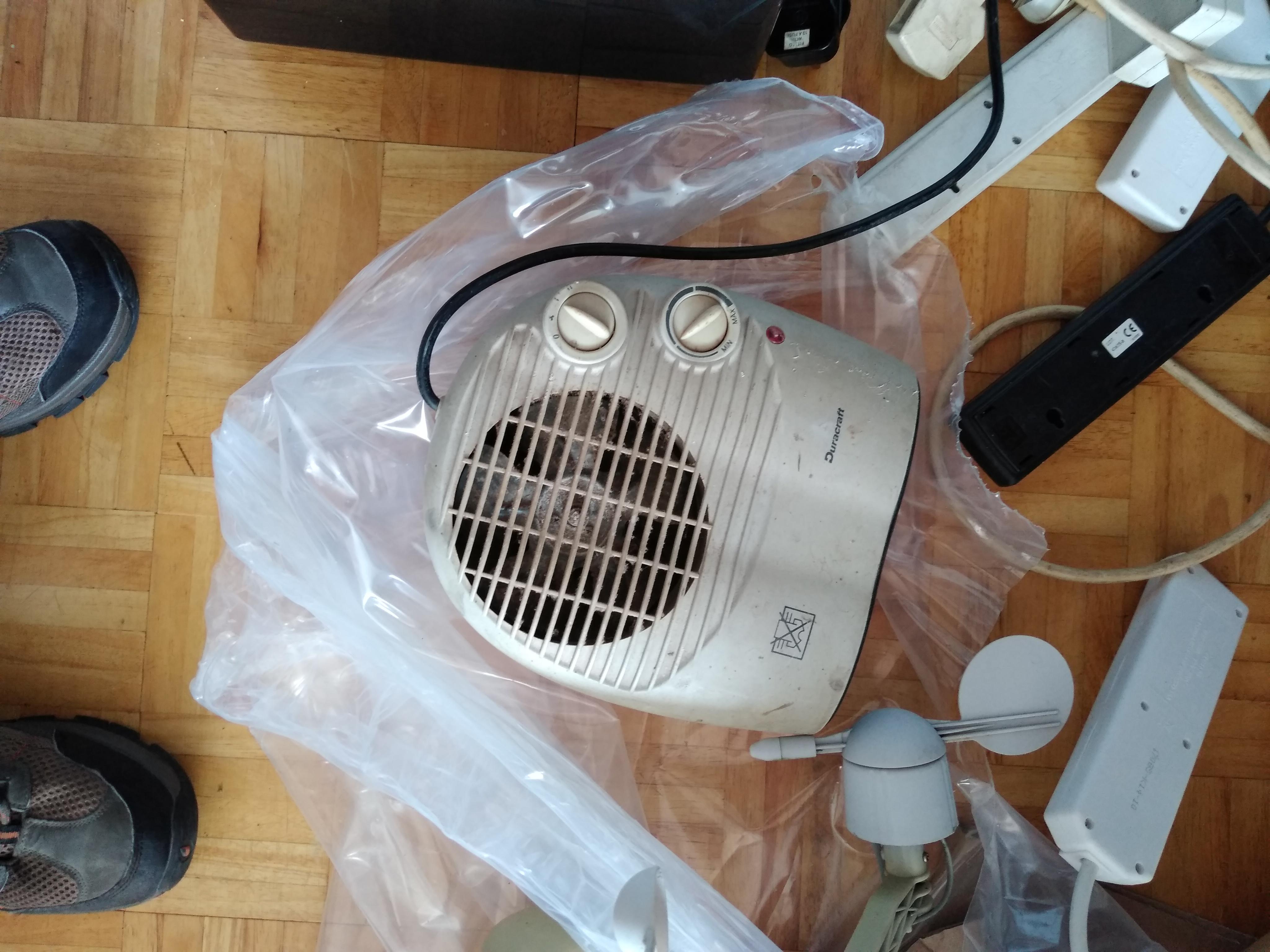

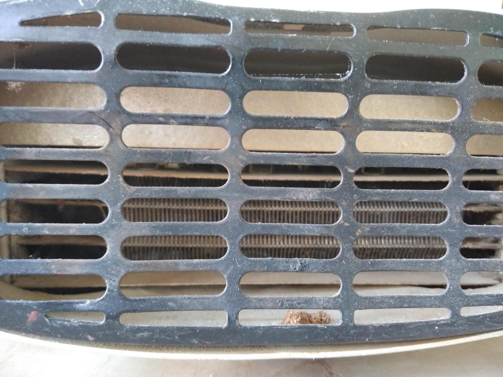

The problem is they can create a slight burnt smell in a room due to the exposed element.
Not my experience, unless the thing hasn't been turned on for ages and has got a bit dusty.  I still have one here that I used to try and speed up the drying of the plaster, as we had water running down the windows for a couple of weeks afterwards.  I'll dig it out and try it to see if there's any smell.
