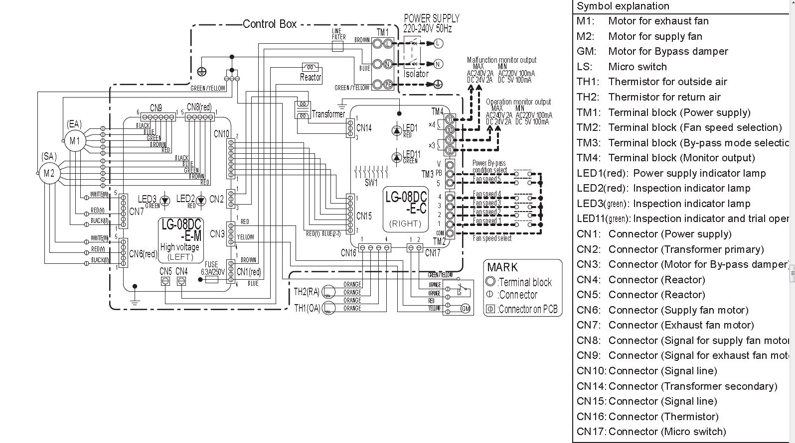

sphannaby Posted June 29, 2016 Author Posted June 29, 2016 2 hours ago, PeterW said: Can you take the cover off the main control box and take a photo of the board ..?? I can tell you which connections are which from that. I am away with work at the minute so can't get a picture but I've took an exert from the manual which shows how the 50RSDCE is supposed to be wired. As you will see the TM2 and TM3 are the terminals for speed selection and bypass mode, these are just dry contats but have to share the same common so I'm not sure how the PZ-60 could work with this as it only has a 2 wire communication cable for all signals from what I can gather.
PeterW Posted June 29, 2016 Posted June 29, 2016 Ok this is pretty simple - look at TM2 and TM3 and you can control most things. The common needs to connect to one or more of the speed pins - these are NO volt free contacts. If you connect TM3 PB to ground then it opens the summer bypass Not sure what logic it applies to seeing ground on more than one speed pin. You can control the boost switching at what level by just choosing which pairs you use
sphannaby Posted June 29, 2016 Author Posted June 29, 2016 3 minutes ago, PeterW said: Ok this is pretty simple - look at TM2 and TM3 and you can control most things. The common needs to connect to one or more of the speed pins - these are NO volt free contacts. If you connect TM3 PB to ground then it opens the summer bypass Not sure what logic it applies to seeing ground on more than one speed pin. You can control the boost switching at what level by just choosing which pairs you use Yeah I've got all that figured but I will just have to use some home made switches rather than something like the PZ-60 as from what I can see about the PZ-60 there is no way to get a volt free signal from the PZ-60. I don't really have an issue with this but it would be much neater if I could have used something like the PZ-60. For the logic with having ground on more than one pin it just uses the highest speed.
PeterW Posted June 29, 2016 Posted June 29, 2016 OK so looks like these are much simpler than their commercial cousins in operation from the manual - I had expected they had the 2 wire connector but obviously not ! Ideal for integration with something like a PIC or Arduino based solution but not for interfacing with an off the shelf controller. http://planetaklimata.com.ua/instr/Mitsubishi_Electric/Mitsubishi_Electric_LGH-50RSDC-E_User_Manual_D_Eng.pdf

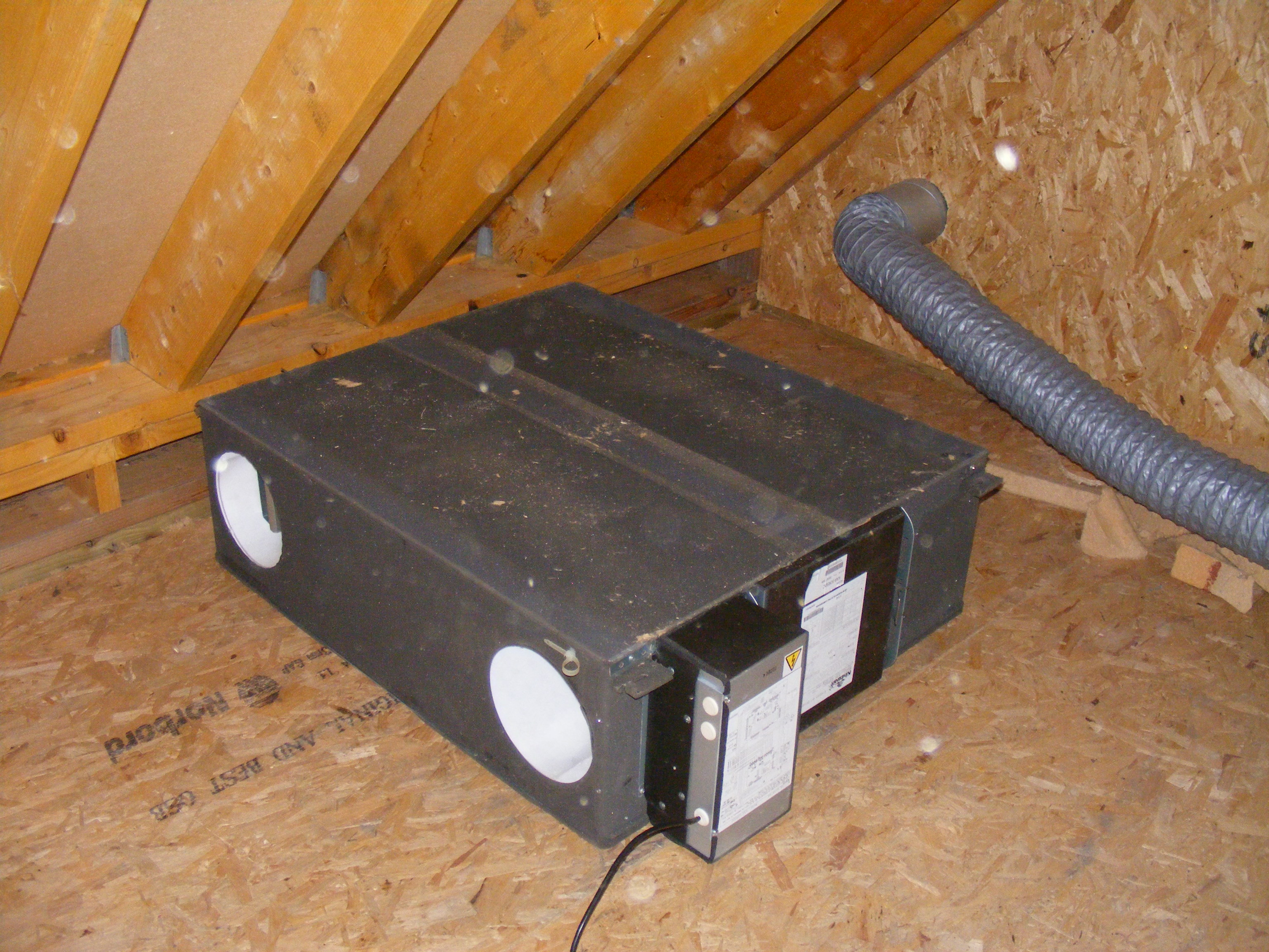

ProDave Posted November 6, 2016 Posted November 6, 2016 Ah, I hadn't appreciated the Misubishi unit and the Kingspan unit were one and the same. I have offered it up into position and it works out a bit awkward. It is fitting into the loft space above the garage, and to get inside and outside ports the right way round ends up with the filter access being in towards the eaves of the loft space. so I have to leave rom to get behind it, down in the low part of the loft to withdraw the filters. Oh how much more convenient it wold be if the filters were on the other side. Lateral thinking mode. What if I put it "upside down" that would put the filter facing out into the loft and would mean I could put it closer into the eaves. It's only a fan after all, I can't believe that would object to running upside down? Or is that just plan daft?
sphannaby Posted November 6, 2016 Author Posted November 6, 2016 You can change the position of the OA and EA spigots. Its only 4 screws which hold them in place and you just swap with the corresponding blanking plate You only get to move them by 90 degrees but this may help. Its a beast of a unit and I had to move the OA to give me a decent chance of getting in at the filters.
PeterW Posted November 7, 2016 Posted November 7, 2016 21 hours ago, ProDave said: Ah, I hadn't appreciated the Misubishi unit and the Kingspan unit were one and the same. I have offered it up into position and it works out a bit awkward. It is fitting into the loft space above the garage, and to get inside and outside ports the right way round ends up with the filter access being in towards the eaves of the loft space. so I have to leave rom to get behind it, down in the low part of the loft to withdraw the filters. Oh how much more convenient it wold be if the filters were on the other side. Lateral thinking mode. What if I put it "upside down" that would put the filter facing out into the loft and would mean I could put it closer into the eaves. It's only a fan after all, I can't believe that would object to running upside down? Or is that just plan daft? They have to be either horizontal or stood on one edge IIRC from the installation - nothing stopping them being upside down !
ProDave Posted November 7, 2016 Posted November 7, 2016 I think I will put a lead on and power it up. then turn it upside down and see if it makes any funny noises. 2

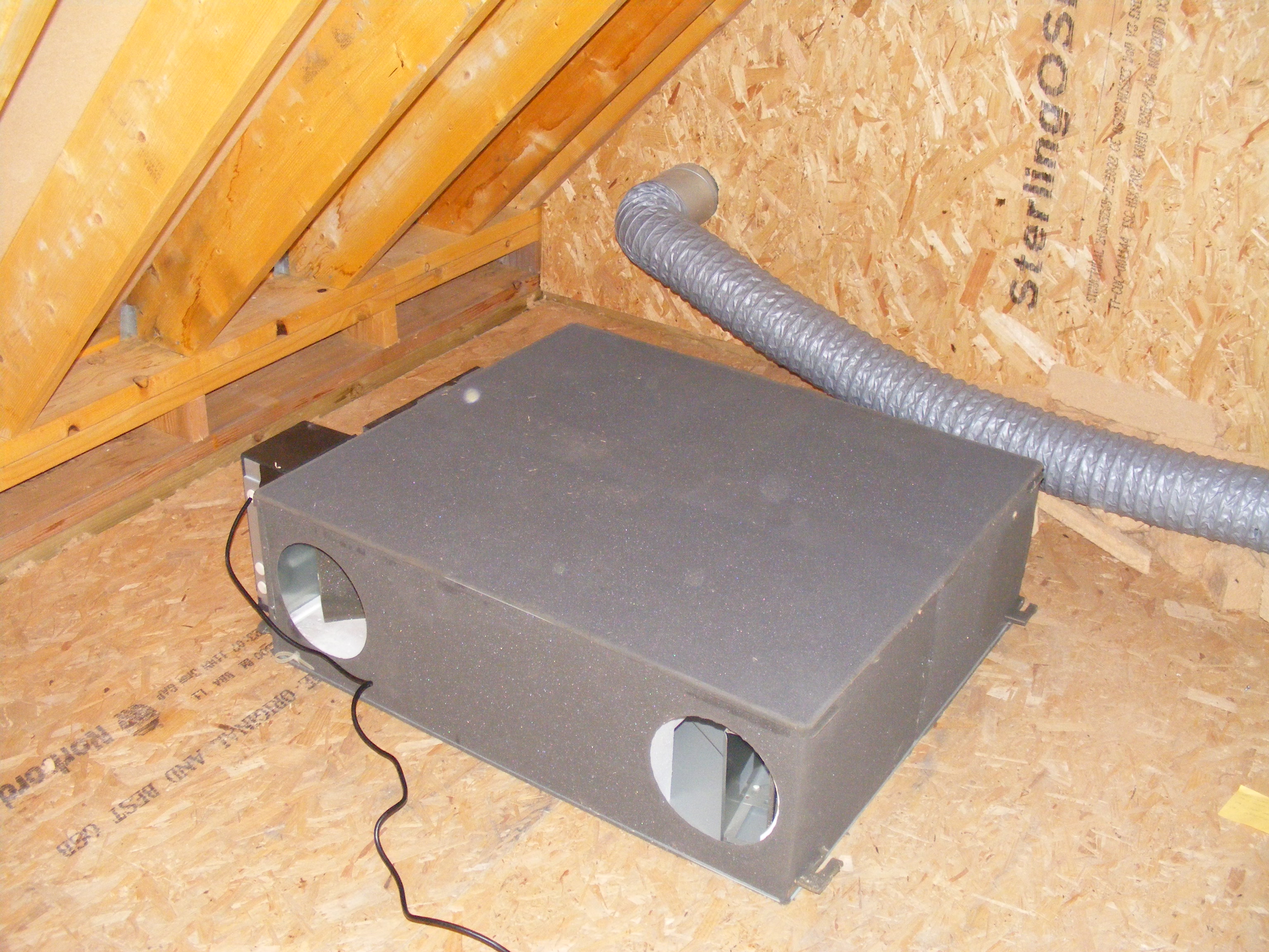

ProDave Posted November 9, 2016 Posted November 9, 2016 I have done the "upside down" test this morning first picture shows how it would have to go the "right way up" leaving just enough space to withdraw the filters while crouching down right in the eaves. The second picture is with it "upside down" that will enable me to push it almost tight into the eaves and you will access the filters from the outside edge. It makes no strange noises when upside down, the fans run just as they do the right way up, anf the bypass flap also operates correctly upside down. Next question. How are you all mounting these? the manual seems to major on hanging it frm the ceiling via threaded rod to the 4 lugs. That would be very hard to do in this location. I am thinking of still trying to support it from the 4 lugs but on some kind of anti vibration mount?

ProDave Posted November 9, 2016 Posted November 9, 2016 If anyone is interested I have been doing some measurements. When i powered it up in "fan speed 1" for my upside down test, I was surprised how noisy it was and how much air it was pushing out. now as a simple guy, I had expected speed 1 to be the slowest. Don't be silly. Speed 1 is the fastest speed. Also the one I have appears only to have 4 speeds available. So power consumption measurements: Speed 4 = 0.2A = 49W Speed 3 = 0.5A = 122W Speed 2 = 1.1A = 269W Speed 1 = 1.7A = 416W Obviously I will be delighted if speed 4 is sufficient for trickle ventilation but I won't know that until very much later on when the house is sealed and it's all ducted up and flow rate measurements done. Another point is according the the manual SW2 should give you the ability to increase or decrease the motor power, but on my unit SW2 is not fitted, though the pcb has the pads and silk screen labeling for it. On speed 4, the slowest, it is whisper quiet. 2
