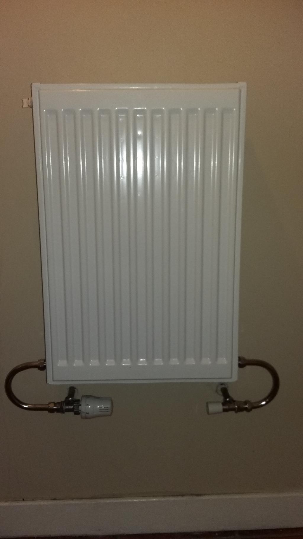

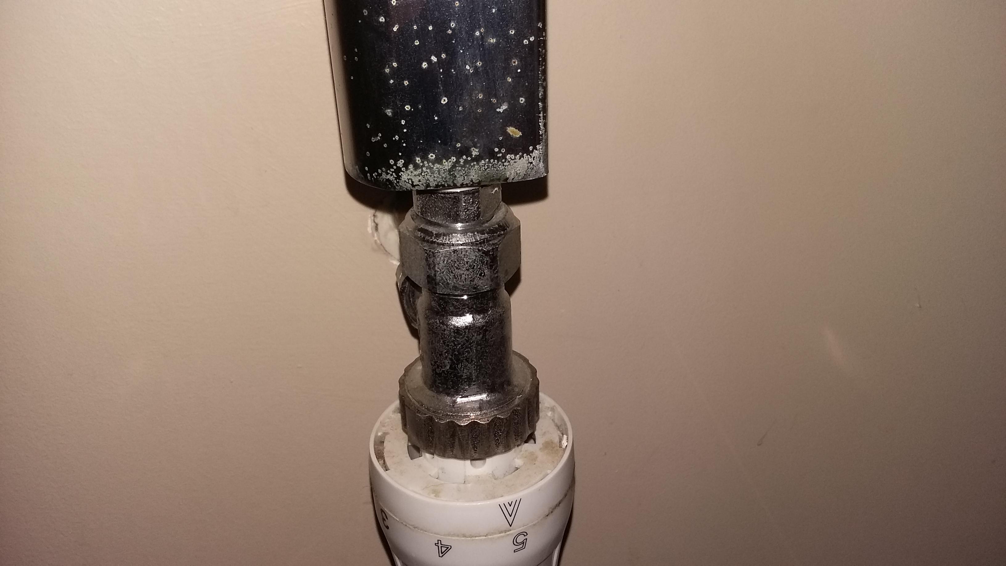

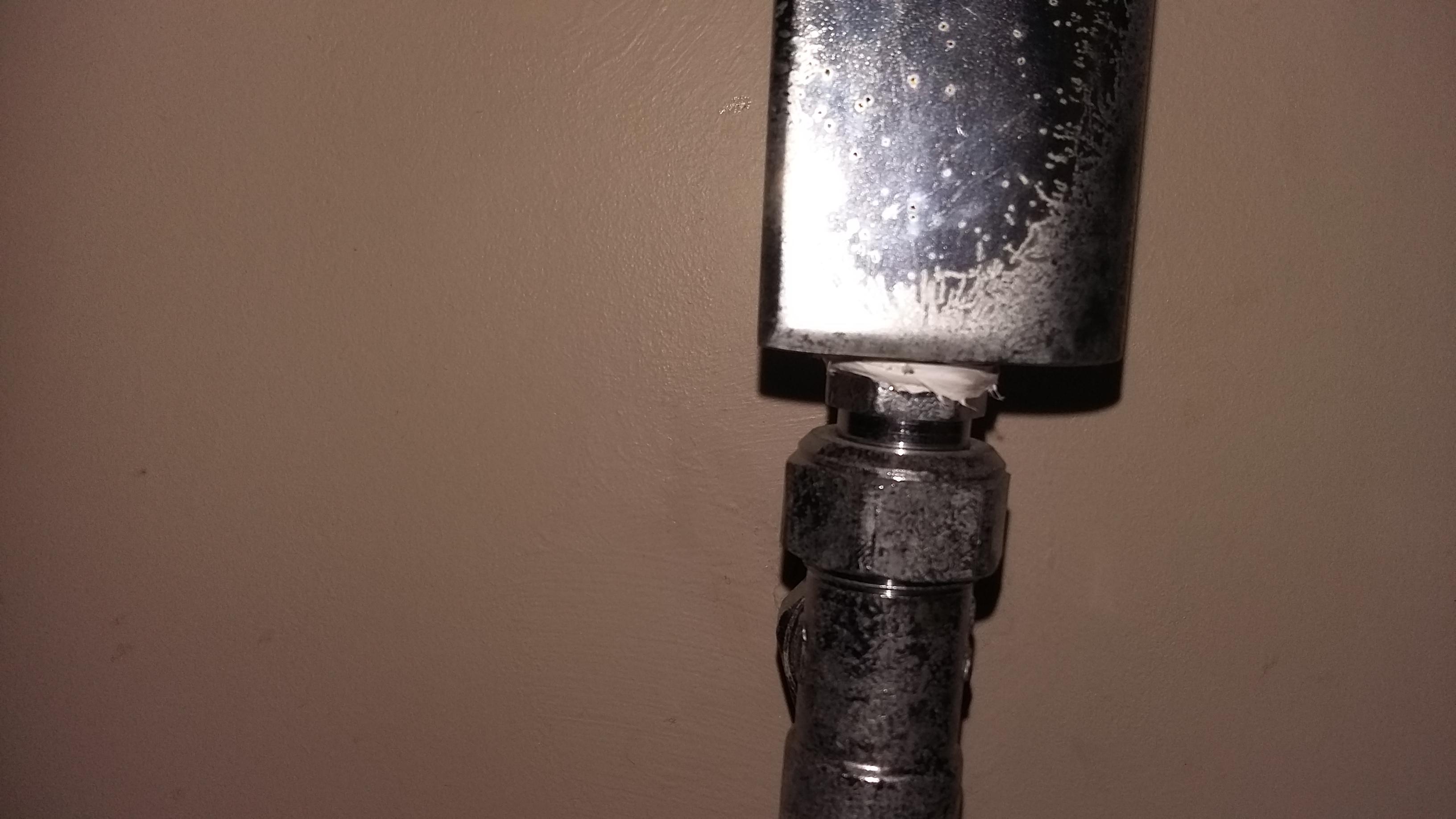

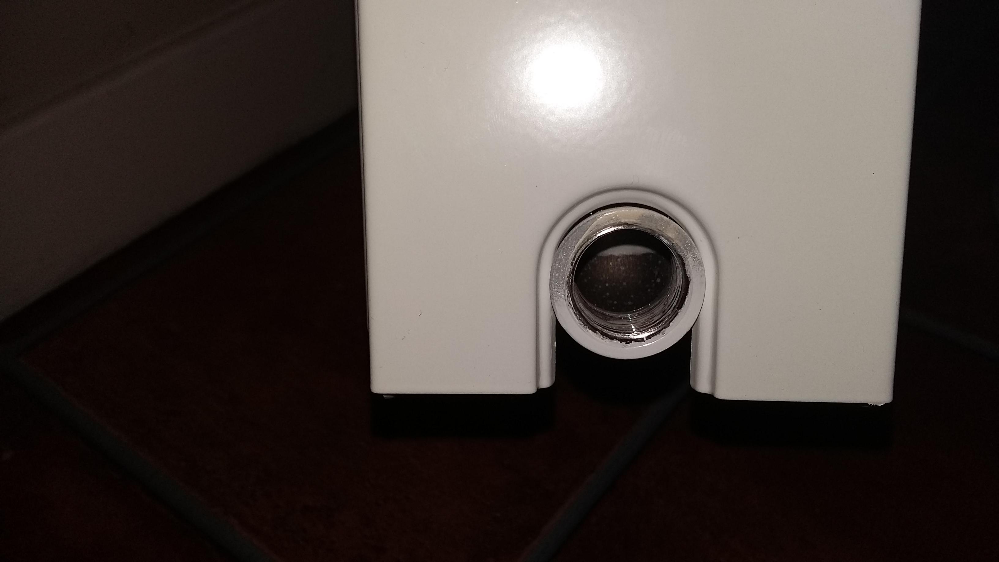

ProDave Posted September 16, 2019 Posted September 16, 2019 I have been asked to do a simple job for a friend. Swap a heated towel rail for a small radiator in their downstairs toilet. I want to do this without completely draining and refilling the entire heating system. These are the two existing valves on the towel rail: So the "plan" is to shut off both valves, remove the towel rail. Slacken the compression fittings and rotate the 2 existing valves on their pipes 90 degrees so they point outwards. This is the radiator, just a little wider than the existing towel rail So what I want is a pipe fitting, female thread to 15mm copper that will go onto the end of the existing valves (the bit that used to screw into the bottom of the towel rail) And a pipe fitting male thread to 15mm copper that will screw into the end of the radiator. Then join the 2 pipe fittings with a U shaped bit of copper pipe. This seems to me a whole lot easier than draining and re filling to alter the pipework before the radiator valves. Just a little unconventional. So what thread are these male and female thread to copper fittings that I need?
Temp Posted September 16, 2019 Posted September 16, 2019 (edited) Google found... https://www.stevensonplumbing.co.uk/radiator-valves.html Quote The tappings in a radiator are usually a standard 1/2 inch BSP female thread but is that BSP or BSPP or ? See that other thread. Anyway that led to... https://uk.rs-online.com/web/p/products/2858716/ Quote 15mm x 1/2 in BSPP Female Straight Coupler Brass Compression Fitting and https://uk.rs-online.com/web/p/compression-fittings/2858687/ Quote 15mm x 1/2 in BSPP Male Straight Coupler Brass Compression Fitting RS may not be the best place to buy them from but at least its a start. Those are chrome plated. Available in brass elsewhere. Edited September 16, 2019 by Temp
Temp Posted September 16, 2019 Posted September 16, 2019 (edited) It looks like there are also solder types..... https://www.ebay.co.uk/itm/End-Feed-to-Female-BSP-Thread-Coupler-Copper-Pipe-Connector-Straight-Adaptor/153046602972?var=452873484642&hash=item23a249d4dc:m:mnrVkHLcUYni5sxJA4mTCVw but take care because after soldering to the pipe you might not be able to screw/unscrew them from/to the rad. eg Pipe has to rotate. Edited September 16, 2019 by Temp
ProDave Posted September 16, 2019 Author Posted September 16, 2019 Same 2 fittings in Screwy's https://www.screwfix.com/p/compression-adapting-female-coupler-15mm-x/76567 https://www.screwfix.com/p/compression-adapting-male-coupler-15mm-x/67110 And link them with a nicely formed bit of chrome pipe? That will be a challenge, can I get a 180 degree bend in one go on my Hilmor? I will have to try it with a bit of scrap pipe first.

ProDave Posted September 16, 2019 Author Posted September 16, 2019 Well I found a bit of chrome plated copper pipe, and got two 180 degree bends in it on the Hilmor. So I should be good to go with this idea. Will post pictures when I do it, though it may not be for a couple of weeks.
