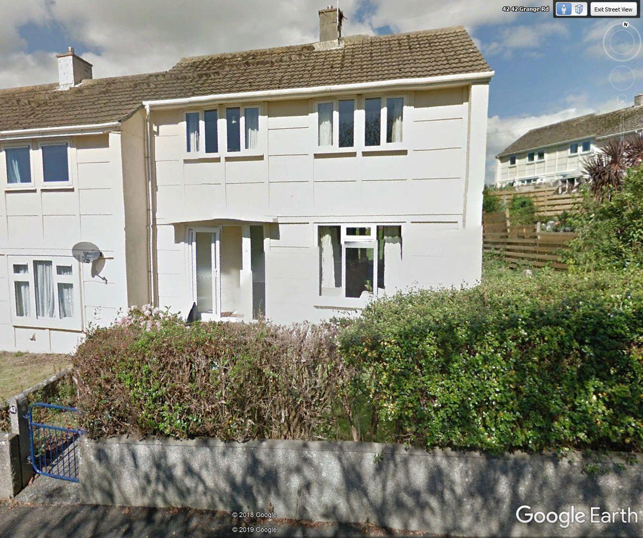

SteamyTea Posted September 11, 2019 Share Posted September 11, 2019 An old girlfriend of mine bought a Cornish Unit, got the local builder, who was an expert on them, to do some work. Everything was a surprise to him, he had never seen one like it before. Strange as most were identical copies. So maybe this is something to do with it, hard to get work done on them. Link to comment Share on other sites More sharing options...
Jeremy Harris Posted September 11, 2019 Share Posted September 11, 2019 35 minutes ago, SteamyTea said: An old girlfriend of mine bought a Cornish Unit, got the local builder, who was an expert on them, to do some work. Everything was a surprise to him, he had never seen one like it before. Strange as most were identical copies. So maybe this is something to do with it, hard to get work done on them. My first house was very similar to a Cornish Unit, same sort of prefab concrete panel construction. Many of them had proper walls built to replace the pretty dreadful precast concrete slabs (which used to rattle in a strong wind). Out of curiosity I've just had a look on Google Earth and that house is still pretty much as it was in 1976, when I moved in. The only obvious difference is that the old crittal windows have been replaced. The steel front gate is the same as it was then, though. I liked the fact that it was the answer to the meaning of life, the universe etc. Link to comment Share on other sites More sharing options...
