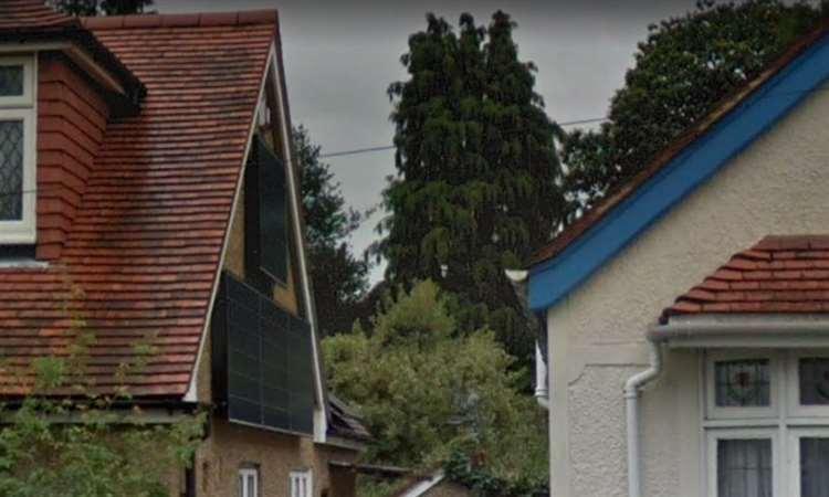

SteamyTea Posted September 6, 2019 Share Posted September 6, 2019 Just had a quick scan of the article. A similar case happened in the US about a decade ago. But the picture amazed me, how does that produce 11 kW as claimed by the article. Maybe there is more hidden away on the other walls and under the shed. Link to comment Share on other sites More sharing options...
ProDave Posted September 6, 2019 Share Posted September 6, 2019 29 minutes ago, SteamyTea said: But the picture amazed me, how does that produce 11 kW as claimed by the article. Maybe there is more hidden away on the other walls and under the shed. Sloppy Journalism I expect, they probably mean 11KWh in a day not 11KW instantaneous. But even on mid summers day with a completely clear sky all day, I would be very surprised if those 4 panels could produce that much in that orientation. EDIT: Is that another one showing it's edge on the back sloping roof? so there could be more on that sloping roof? Link to comment Share on other sites More sharing options...

Onoff Posted July 7, 2020 Share Posted July 7, 2020 (edited) House wanting to extend to the right of the white van. Mr McLennans property...the gable he has his panels on faces due South plus those on the rear. https://www.google.co.uk/maps/@51.3647629,0.5120271,45m/data=!3m1!1e3 Edited July 7, 2020 by Onoff Link to comment Share on other sites More sharing options...
Onoff Posted July 7, 2020 Share Posted July 7, 2020 I must really grate that his neighbour's roof is so much better suited to solar. Link to comment Share on other sites More sharing options...
