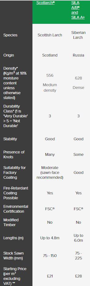

jack Posted September 6, 2019 Share Posted September 6, 2019 56 minutes ago, Patrick said: Paid extra? It was nearly 5 years ago, but I'm certain we paid more for Siberian than was on offer for UK-sourced. That said, I also recall that we went for the higher grade stuff with limited knots (and maybe longer average length boards). Maybe that's where the premium was. Just looked at Russwood's site (that's where we got ours). Siberian is notably more expensive than Scottish: That said, I can't understand why would anyone pay a premium for less dense and less durable English larch when the Siberian stuff is of notably better quality (assuming similar grade)? 1 Link to comment Share on other sites More sharing options...
Visti Posted September 6, 2019 Share Posted September 6, 2019 Varsten's timber has a premium of about 6-10% on Siberian over British. Not surprising give the generally denser property and extra logistics to get it here. Spruce is a good choice, but needs to be factory treated ideally in addition to paint which can negate it's affordability. Same with other types of softwoods such as fir and pine. Only larch or cedar from the softwoods can really get away with less TLC, making them a good balance between cost, longevity and maintenance. 1 Link to comment Share on other sites More sharing options...
