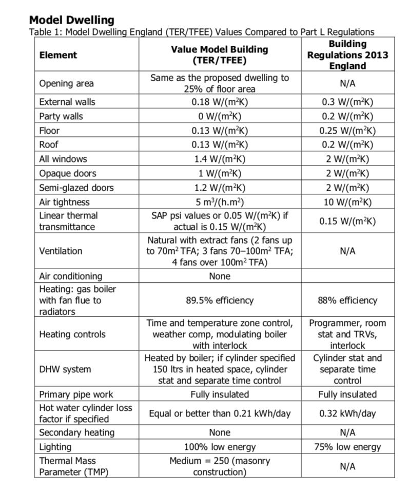

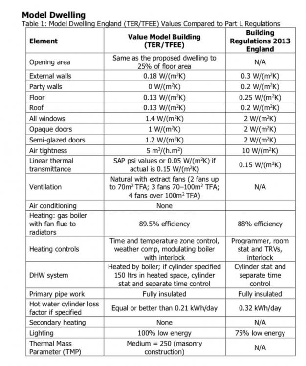

epsilonGreedy Posted September 5, 2019 Author Posted September 5, 2019 6 hours ago, JSHarris said: I have to question quite why anyone self-building would deliberately choose to build to the minimum allowable spec, basically the same as a crap volume build house, though. The sequence of events was. I purchased a plot with planning permission in the middle of a highly regarded village subject to conservation area design restrictions. The heritage design approved for my plot was the outcome of a bitter local planning process and there is no realistic chance of any exterior changes, even the front door colour is a planning condition. Given the relatively small'ish house size of 1500 sq ft, a ridge height limit, Georgian sash windows and zero chance of PV there is little opportunity for a substantial revision to the thermal design. 6 hours ago, JSHarris said: The standard in building regs isn't high, and it's pretty easy to exceed it, and get a more comfortable and easy to heat house, for barely any increase in build cost. Although much maligned on this forum, a faithful cheat-free implementation of minimum 2013 building regs equates to a home that performs better than 80% or 90% of British homes. The annual heating cost differential for a minimum 2013 regs build and the Passiv standard for my size of home is about £500. I hope to close the gap between 2013 regs and Passiv by: Setting myself an air change target of 2.0. MVHR Exceeding a typical 2013 reg specifications house by 10% for roof, walls and floor.
PeterW Posted September 5, 2019 Posted September 5, 2019 But 2013 is the wrong version of the regs unless you got applied for Building Regs approval prior to 10th April 2016. After that, irrespective of the design or planning approval, you have to meet the 2016 regulations. This isn’t a choice ..! It’s a requirement ..!!
ProDave Posted September 5, 2019 Posted September 5, 2019 13 minutes ago, epsilonGreedy said: Although much maligned on this forum, a faithful cheat-free implementation of minimum 2013 building regs equates to a home that performs better than 80% or 90% of British homes. The annual heating cost differential for a minimum 2013 regs build and the Passiv standard for my size of home is about £500. What is the annual predicted cost of heating this house? Planning conditions can stipulate what a house looks like but not how the walls are built and how much insulation is fitted. Having to have sash windows will impact air tightness, but that is about all.
epsilonGreedy Posted September 5, 2019 Author Posted September 5, 2019 (edited) 24 minutes ago, PeterW said: But 2013 is the wrong version of the regs unless you got applied for Building Regs approval prior to 10th April 2016. After that, irrespective of the design or planning approval, you have to meet the 2016 regulations. This isn’t a choice ..! It’s a requirement ..!! This is incredible. Those new target fabric figures represent a near doubling of insulation in the all the major components of a house. In comparison the jump from 2001 to 2013 regs was a raising of insulation targets by just 6%. Your table is showing targets rising by 80%. Something does not add up here because your table would show that with a stroke of the legislative pen the Government mandated Passiv new homes for all. Edited September 5, 2019 by epsilonGreedy
