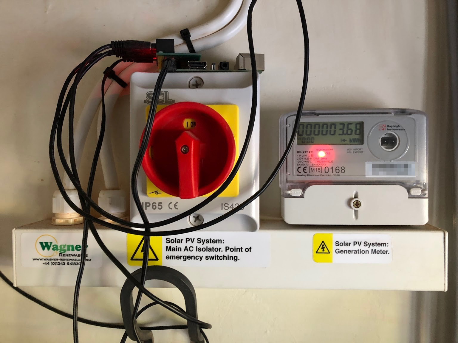

MrMagic Posted September 5, 2019 Posted September 5, 2019 Happy Wagner customer here - the install is very tidy IMO. Please excuse the RPi balanced on top with its spiders web of wires! 1

MrMagic Posted September 5, 2019 Posted September 5, 2019 Wagner are very amenable chaps - speak to 'Mark the spark', I'm sure he can suggest some options for you. His tales of much larger PV + battery installs will make you jealous! 1

MrMagic Posted September 5, 2019 Posted September 5, 2019 1 hour ago, PeterStarck said: What size system is that and do you have micro-inverters or a standard inverter? 2 x standard inverters - essentially 2 separate systems which are then combined on the AC side and then fed via the export meter and main isolator. 3.9kWp system (13 x 300w panels) but realistically its two smaller systems and never gets anywhere near that peak based on shading and orientation. Export limitation is also in place but never kicks in. 1

SteamyTea Posted September 5, 2019 Posted September 5, 2019 (edited) 13 hours ago, MrMagic said: Please excuse the RPi balanced on top with its spiders web of wires! Why is the RPi not counting the pules off the meter? Edited September 5, 2019 by SteamyTea
MrMagic Posted September 5, 2019 Posted September 5, 2019 At the moment it’s got 3 CT clamps - one for each array and then one on the main tails so I can get the ‘live’ generation, house consumption and import export values. Currently capturing them every 60 seconds. With the pulses I guess you have to guesstimate the power draw based on pulse frequency and time lapsed? I know the export meter also has the IR interface as well but not played with that.
