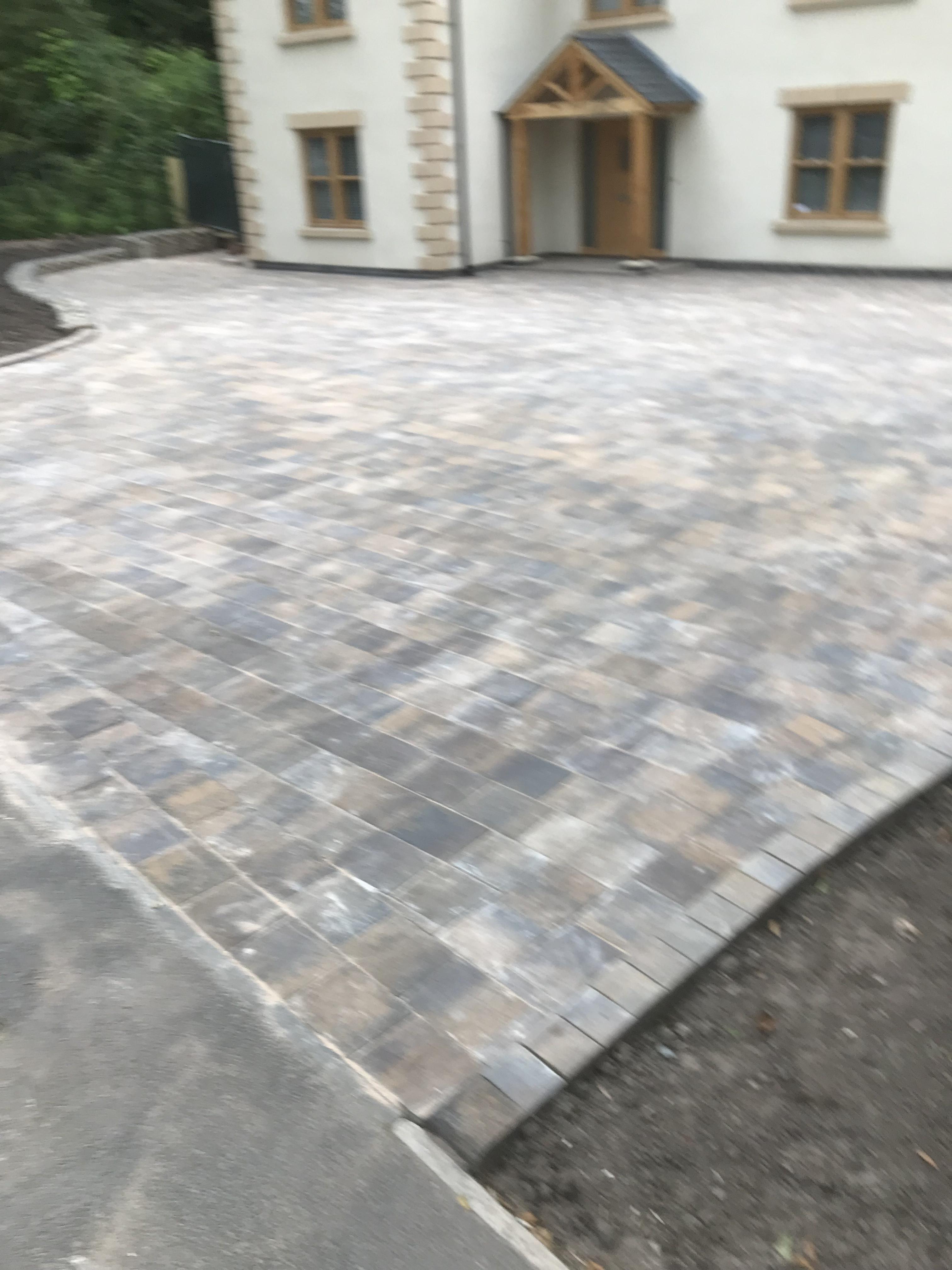

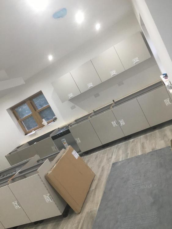

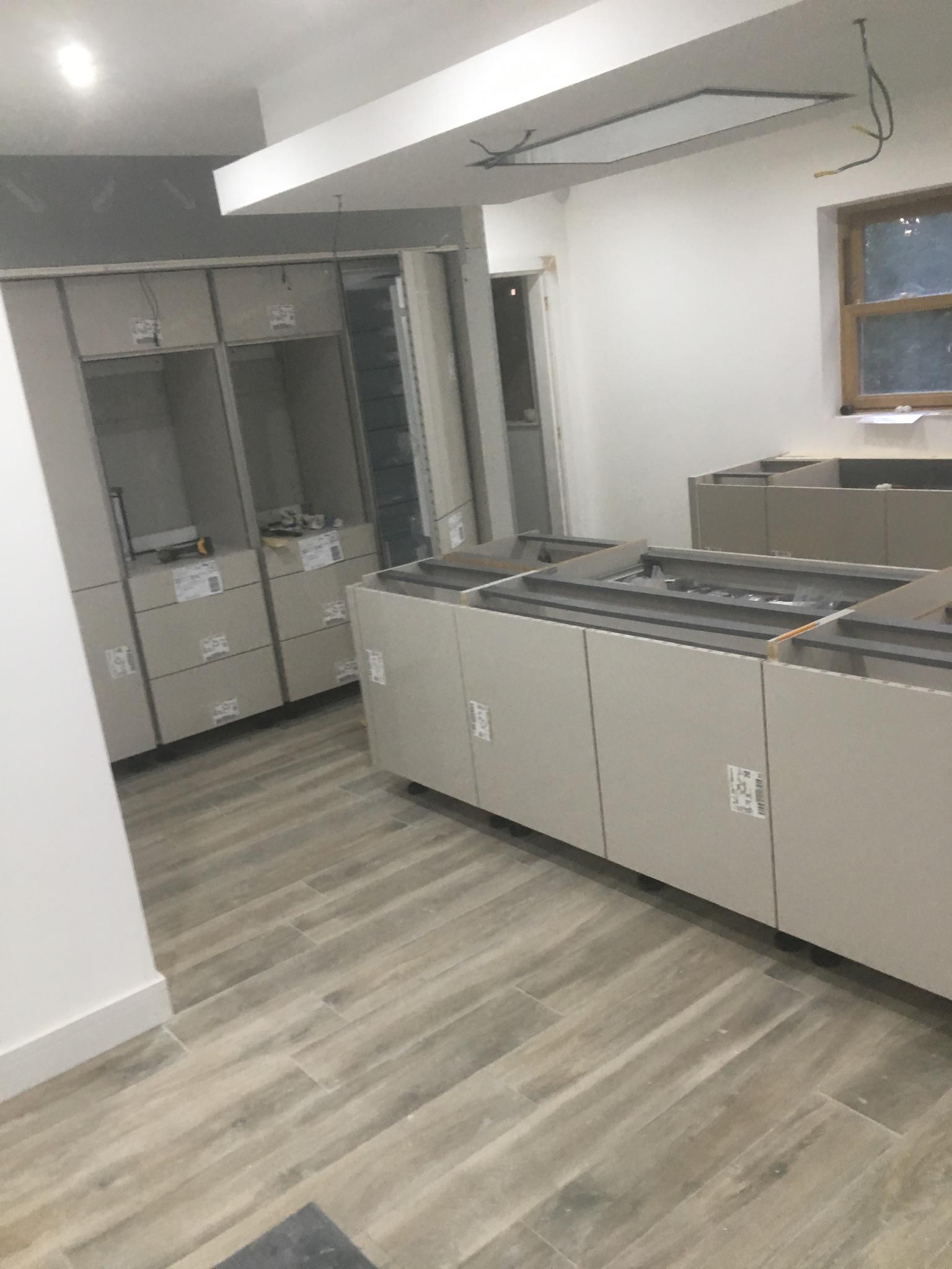

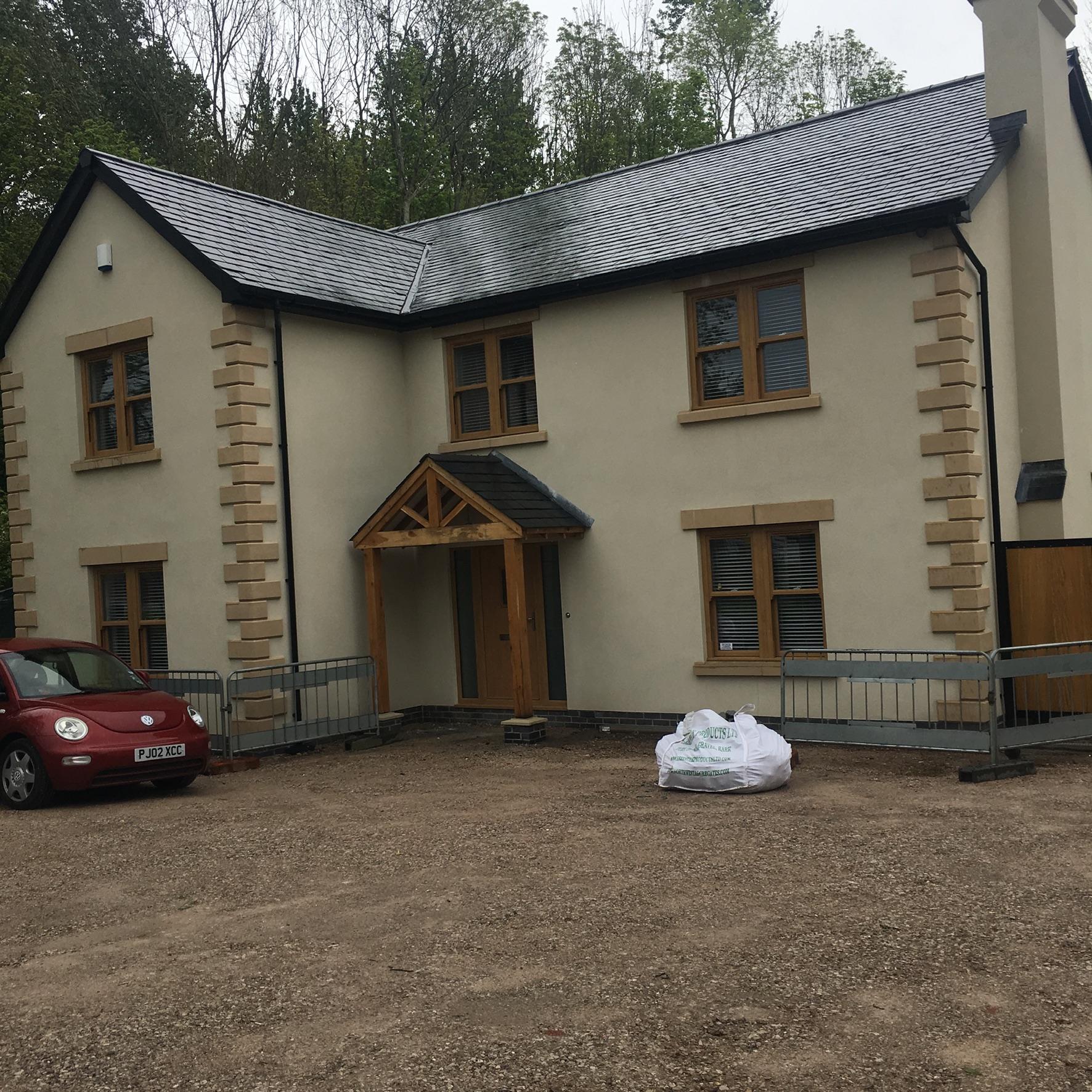

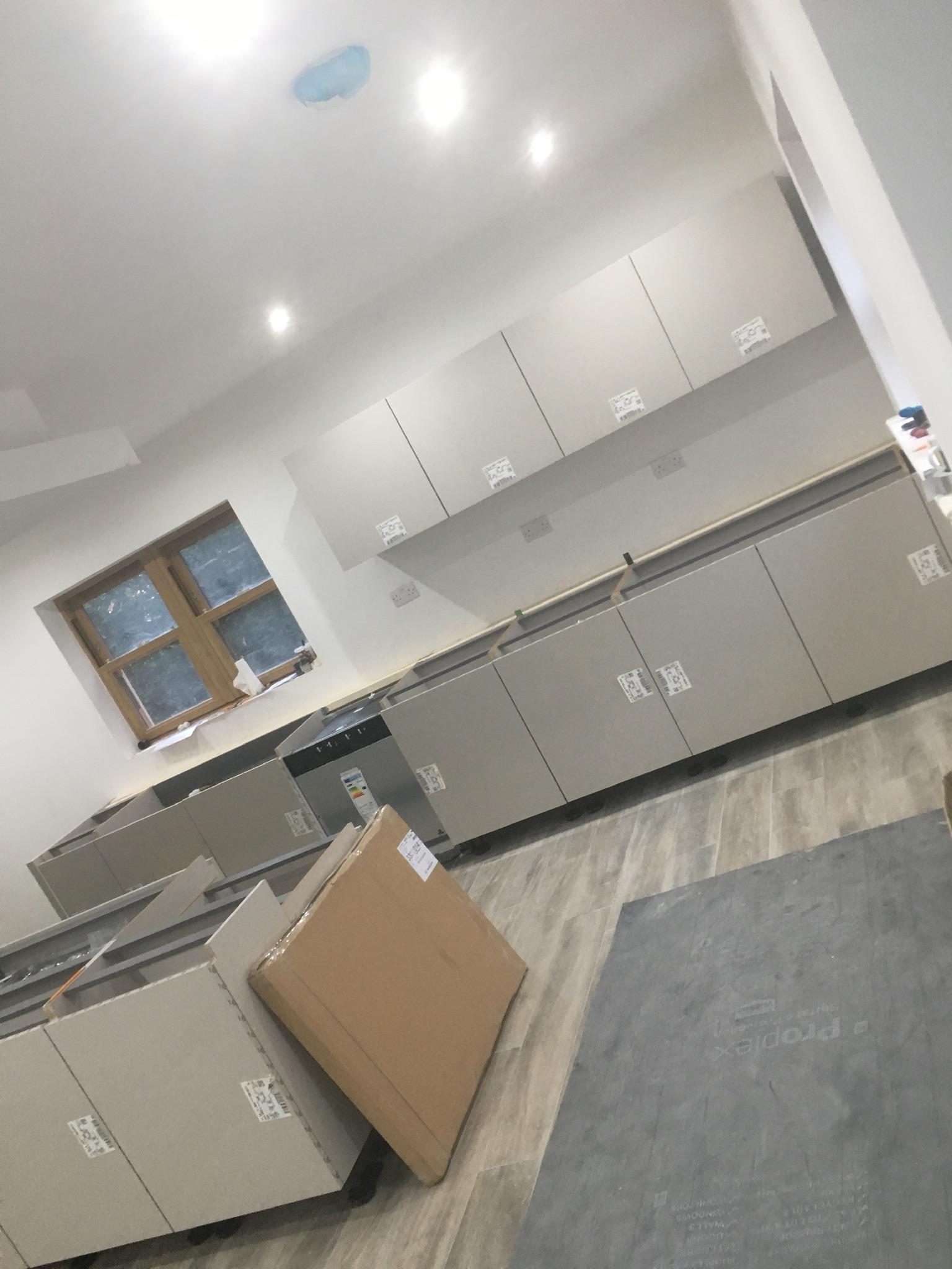

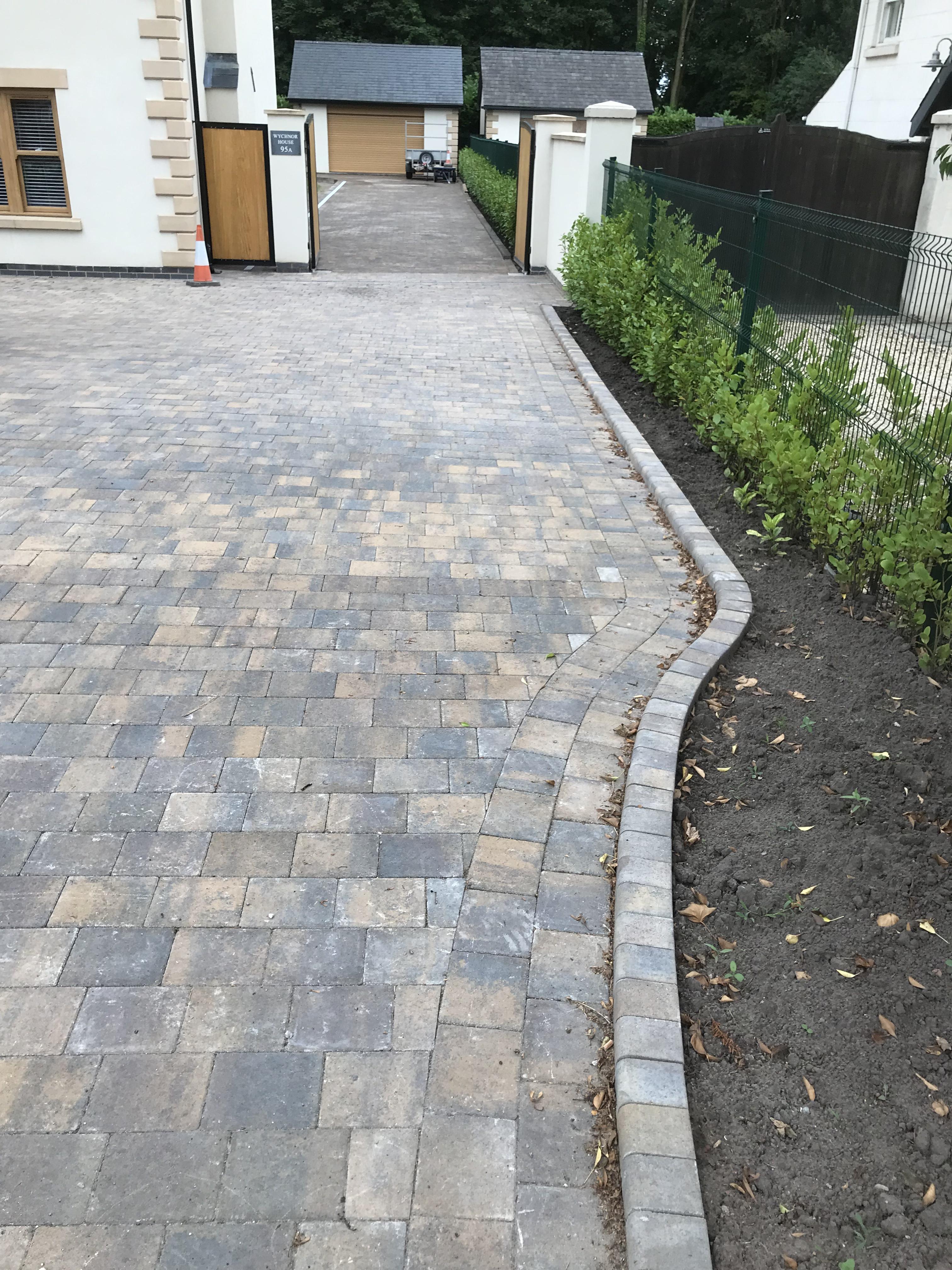

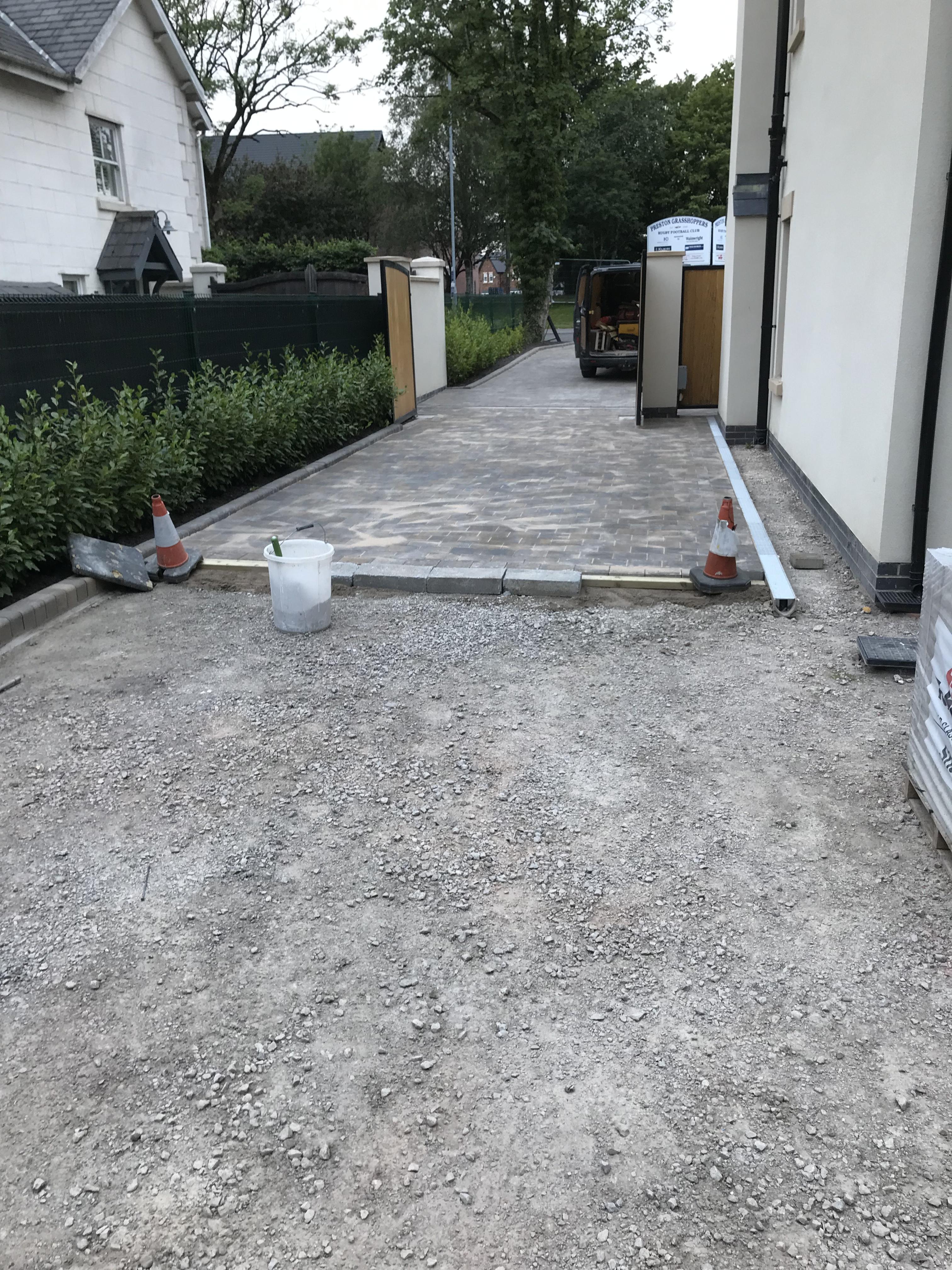

We have recently completed
For slightly over 800 per sq mtr
5 bed 284 sq mtrs Not including land purchase
Still some landscaping to do
and lawn to put down
