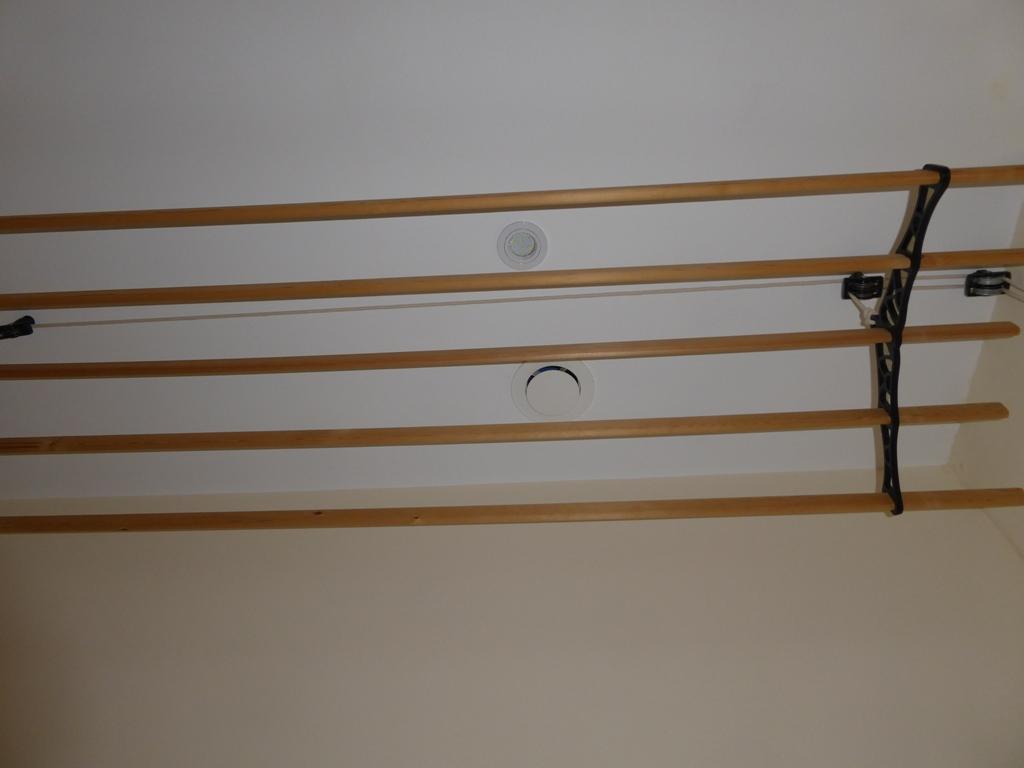

Jeremy Harris Posted September 3, 2019 Share Posted September 3, 2019 Similarly, we have a drying area in the utility room, and I fitted an MVHR extract into the ceiling above one of those hoist up clothes racks. Works extremely well, and dries stuff very quickly: 1 Link to comment Share on other sites More sharing options...
puntloos Posted September 3, 2019 Author Share Posted September 3, 2019 1 hour ago, JSHarris said: Similarly, we have a drying area in the utility room, and I fitted an MVHR extract into the ceiling above one of those hoist up clothes racks. Works extremely well, and dries stuff very quickly: Very nice, I guess even "cold" airflow works better than only natural air movement! 3 hours ago, JSHarris said: Definitely an extremely bad idea. Apart from kitchens being an extract room, with a specified extract rate in the regs, there is a very serious fire issue with supplying fresh air to a room (or garage) that may well be the initial seat of a fire. 3 hours ago, ProDave said: You don't want your house mvhr linked into the garage. I was purely thinking on demand though. It's a fair point that I hadn't thought about that you could, well, fan the flames.. but if the issue is smoke or noxious fumes, being able to turn the fans up to 11 sounds like a very helpful idea.. 3 hours ago, JSHarris said: MVHR does not deliver dry, heated, air normally. Unless there is some form of post-heating in the supply ducting then MVHR delivers air that is always cooler than the room air in cool weather. I'm thinking some system where indeed MHVR is the main source of comfort in the house, but when needed (perhaps triggered by heat sensors, or by 'the projector turning on" the more extreme functionalities switch on. But I also seemed to recall you mentioning 'running the MHVR in reverse' or something.. 3 hours ago, SteamyTea said: This is more a job for air conditioning rather then MVHR. MVHR works on the little and often principle. OK so my idea is not practical? Or are there ways to have "all the air types" (cold, normal, heated) available at all times on demand that are not insane? ? I think the dream would be to have the MHVR be the main system, but having AC be available as backups that can kick in if there's a short term demand for more. Is this doable/feasible? Link to comment Share on other sites More sharing options...
