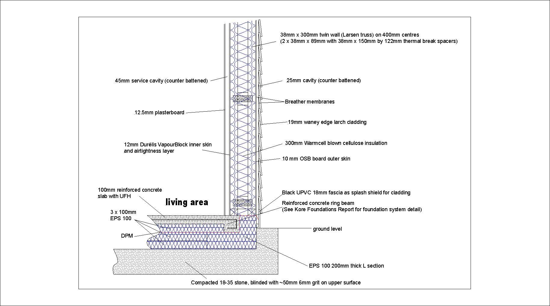

Jeremy Harris Posted August 29, 2019 Share Posted August 29, 2019 3 minutes ago, howplum said: Passive slab foundation- that looks interesting. Another option for the list to be investigated. If I understand correctly, the site is usually excavated to a depth of 600mm, unless conditions dictate otherwise, and a highly insulated raft foundation built up, obviating the need for trenches. Being a self build virgin I find Mark Brinkley's book very useful, and interesting, but to be tempered with questions on this wonderful forum, where real world experiences can be applied. Ours was excavated 200mm below level ground from the site levelling work, and this 200mm was filled with compacted Type 3 stone, with drainage around the edge (just a buried 100mm land drain pipe). There wouldn't normally be a need to excavate as much as 600mm unless the ground conditions were particularly poor. This is the 200mm compacted stone layer which was blinded and levelled with grit for the insulation: Link to comment Share on other sites More sharing options...
howplum Posted August 29, 2019 Author Share Posted August 29, 2019 @JSHarrisEven better! Less work and less muck away. How much above the landscaped ground level is the finished floor? Link to comment Share on other sites More sharing options...
Jeremy Harris Posted August 29, 2019 Share Posted August 29, 2019 3 minutes ago, howplum said: @JSHarrisEven better! Less work and less muck away. How much above the landscaped ground level is the finished floor? This section through the base of our build gives an idea of the relative levels: Because we'd stripped a lot of muck off our site to get it level, and we were left with just subsoil, I imported a fair bit of topsoil (none of the old stuff was re-usable, full of greenstuff and waste). This meant building up the drive level with crushed concrete as well, and when we paved around the house this raised the level by around 200mm above the level of the base of the insulation. We filled the drain area around the periphery of the house with similar coarse stone to the Type 3 used under the insulation, but with the top 100mm being a local decorative aggregate. Ground level ended up being a bit over the 150mm below finished floor level/DPM required (our DPM is at FFL). Link to comment Share on other sites More sharing options...
