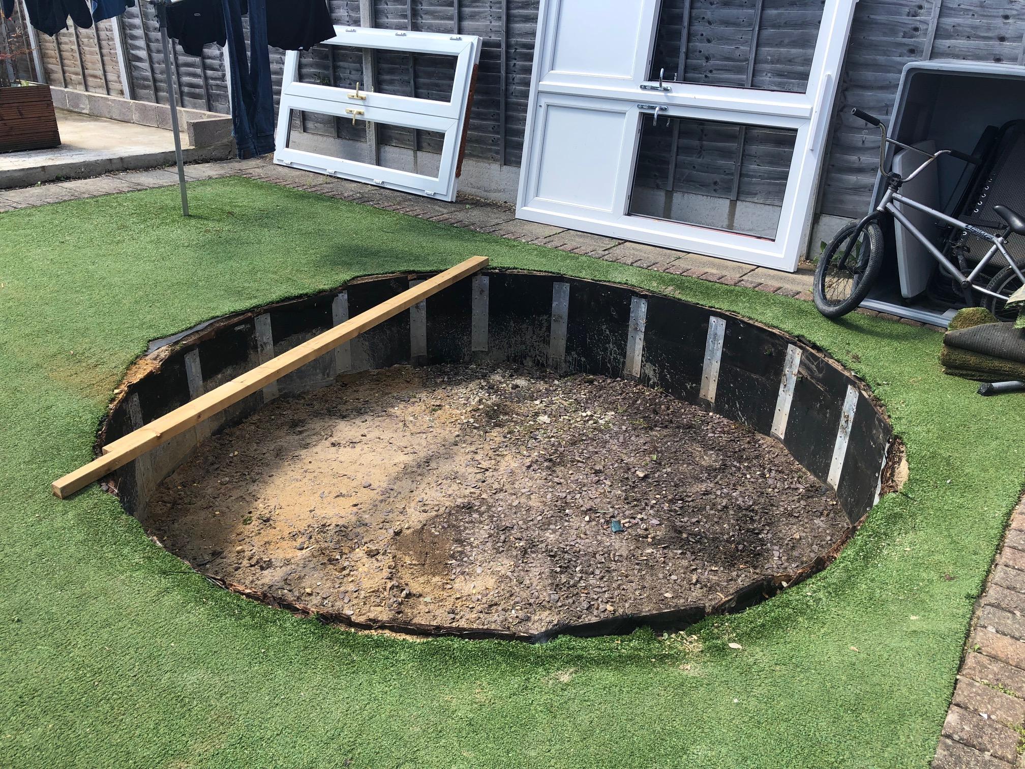

Mark68 Posted August 28, 2019 Share Posted August 28, 2019 I have got a redundant hole in my garden from a sunken trampoline project that has now been out grown. I would like to turn it into a sunken seating area with a fire pit. I am think of pouring solid concrete seats the question is what do I do to keep the earth side dry. Can i just line the hole with a damproof membrane then cut the middle out for drainage when the concrete is done. The middle of the seating area will be gravel. I don't want to end up with permanently damp seats. I also want the render the seats to give them a finish. Any help would be great or any idea where to look. Thanks Link to comment Share on other sites More sharing options...

Gone West Posted August 28, 2019 Share Posted August 28, 2019 Hi and welcome to the forum. I would add waterproofer and not worry too much about the concrete being wet. There are some useful videos using a shiny board in the mould to create a smooth finish. Link to comment Share on other sites More sharing options...

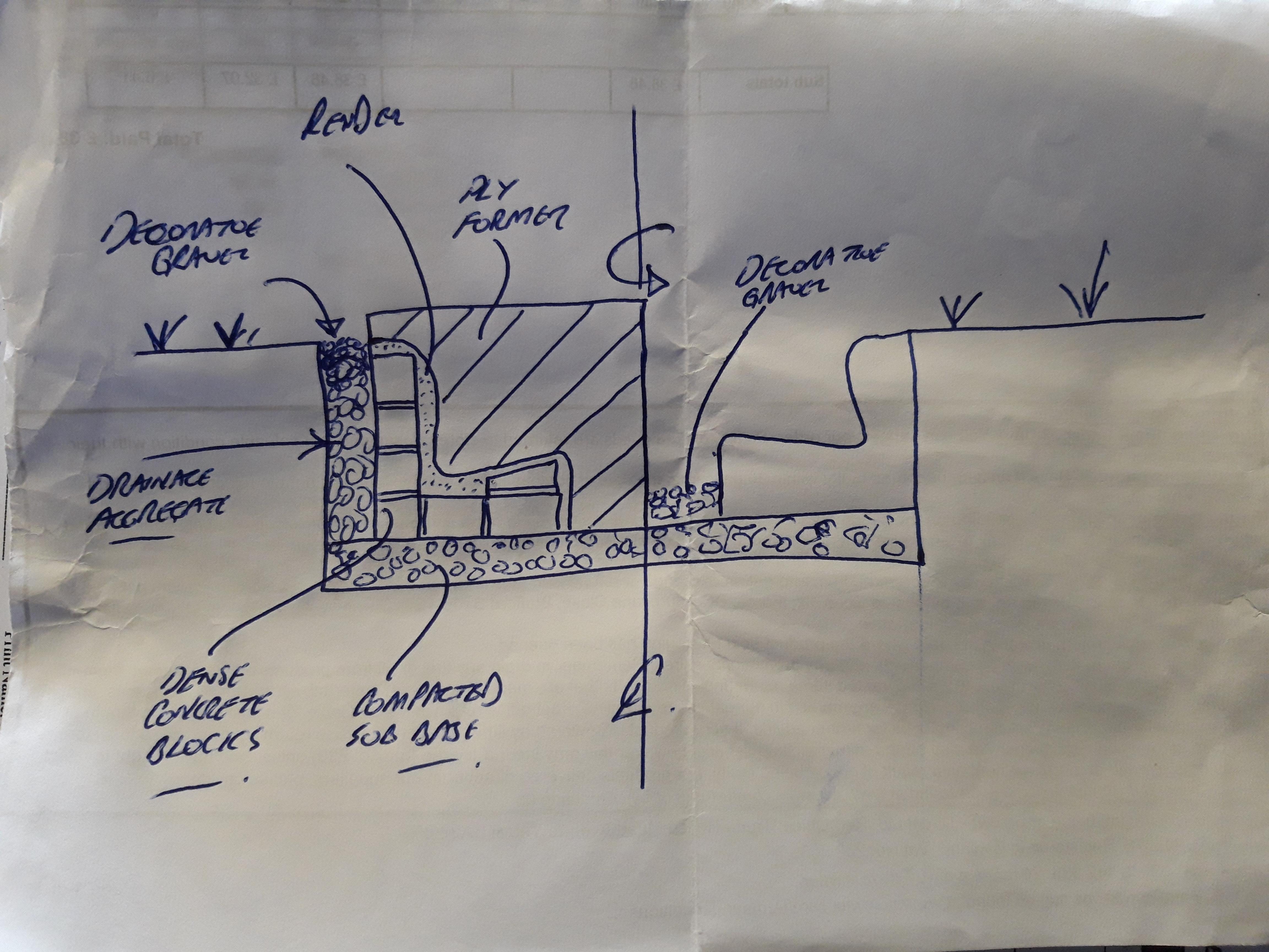

Onoff Posted August 28, 2019 Share Posted August 28, 2019 If it were me...I'd over complicate things! Make a big ply board cut to the seating profile to shape the render. Rotate around a dead square central pole - use that for a parasol later if required. I've mulled doing similar for a home brew hot tub. Would need some drainage tubes down from the seat to shed standing water. A nice set of concrete steps too. Link to comment Share on other sites More sharing options...
Ferdinand Posted August 28, 2019 Share Posted August 28, 2019 May be relevant whether it has ever flooded or had standing water In it, in any form. Also needs to be designed to make it possible or impossible to use as a drunken-bicyclist wall of death facility. Ferdinand Link to comment Share on other sites More sharing options...

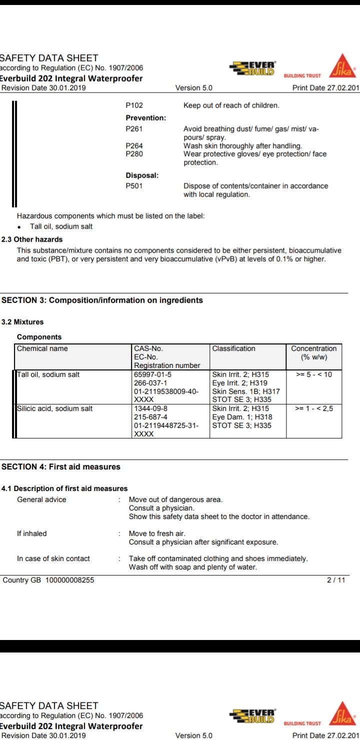

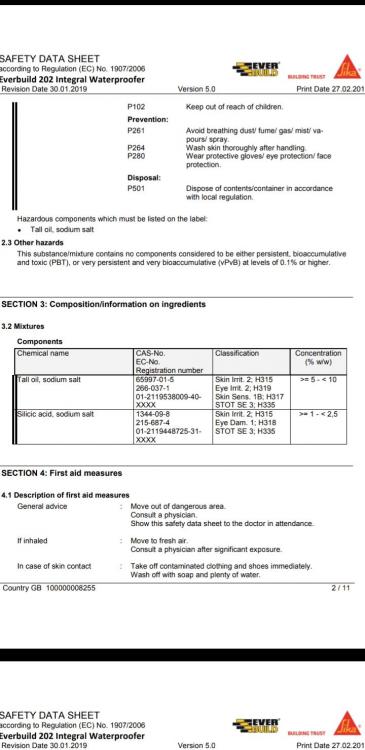

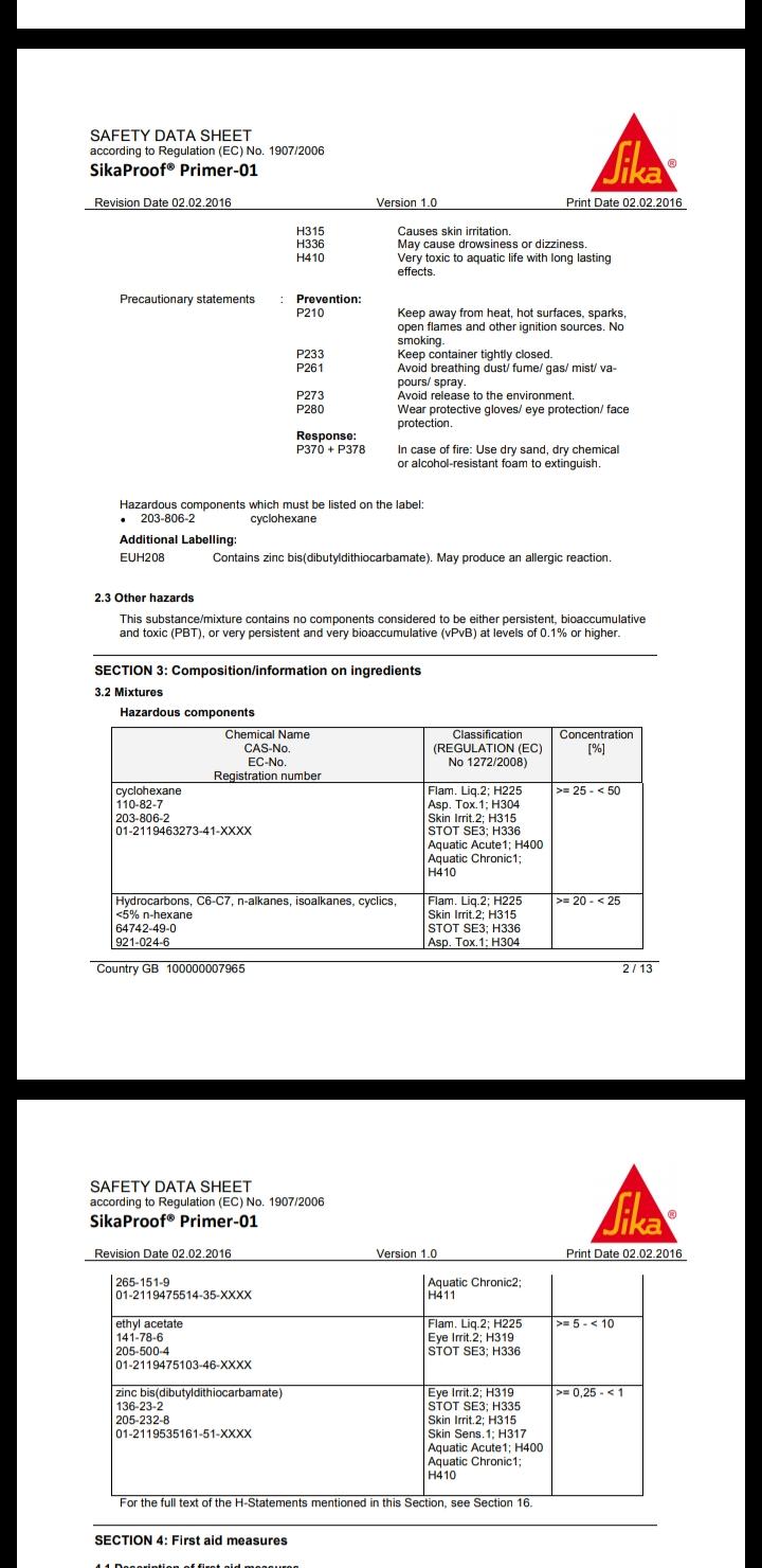

Onoff Posted August 28, 2019 Share Posted August 28, 2019 12 minutes ago, Mark68 said: Thanks Guys It has never flooded Does a waterproof additive really work in the concrete mix. I have seen an everbuild product at £5 for 5 litres and a sika product for £50 for 5 litres I wondered at the difference. I've been using the Everbuild Integral Waterproofer from Toolstation for years and its really good imo. Makes you wonder as Everbuild is a Sika company. Interesting to compare the dmsafety data sheets: Then SikaProof: Link to comment Share on other sites More sharing options...
