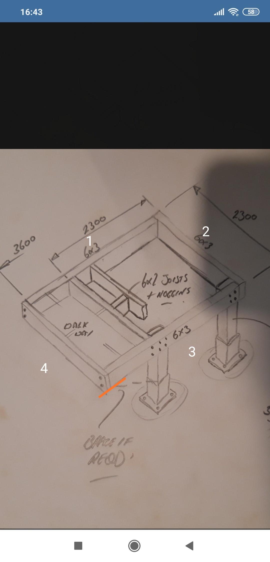

Onoff Posted September 20, 2019 Share Posted September 20, 2019 Something like this? ? 1 Link to comment Share on other sites More sharing options...

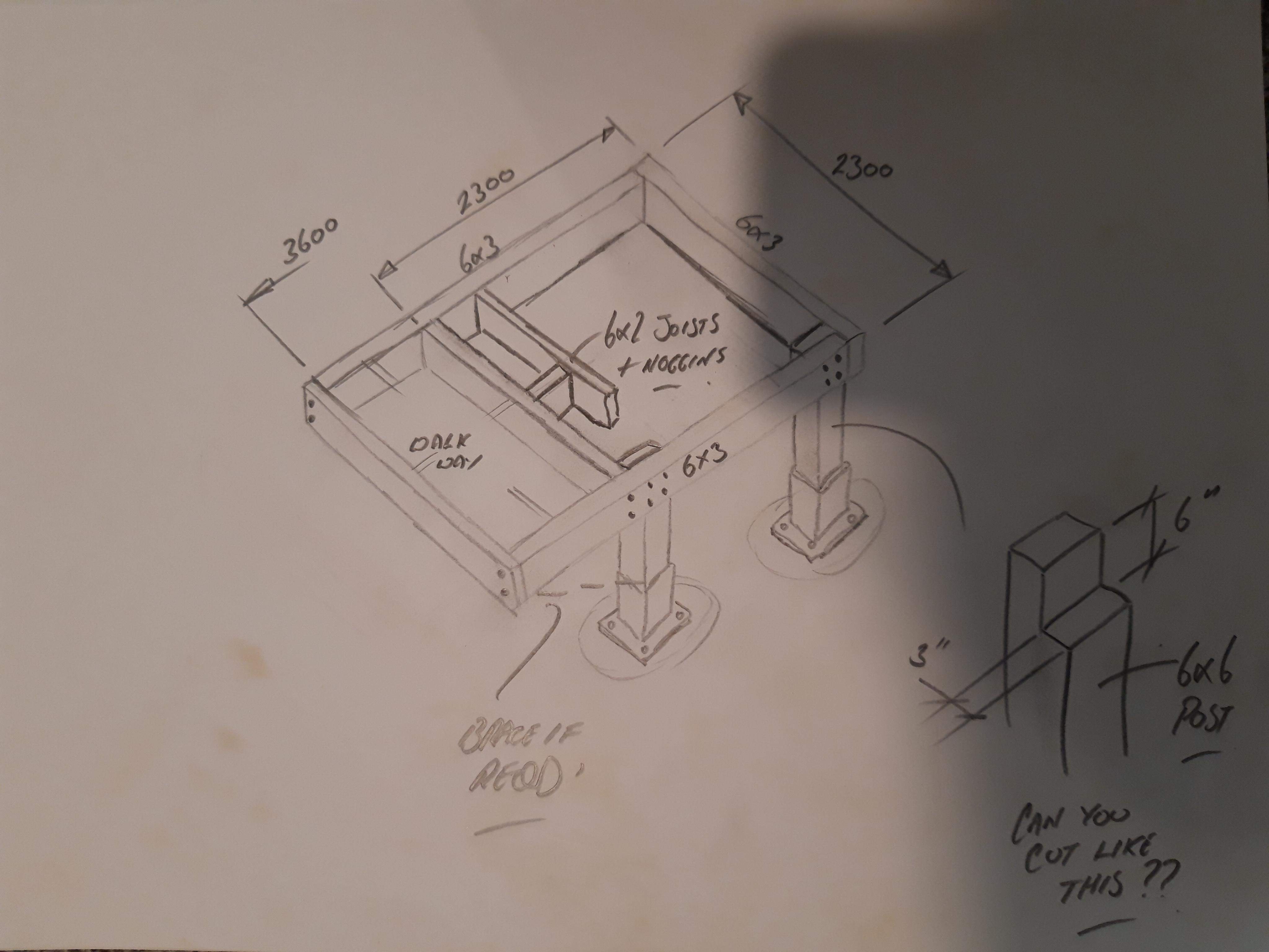

zoothorn Posted September 20, 2019 Author Share Posted September 20, 2019 (edited) @Onoff Yes, correct drawings there thanks. 10cm excess: cabin corners like a "+" you see (stacked horizontals sections). No it isn't big.. which is why I ask if 6x3's couldn't be used. You see its the only s/h one I find & cheap £550 + £50 deliv. Plus I'm really constrained to small due to steep slope & stream. Alternative was a 3msq cabin: alot more tricky plinths even just 0.25 wider wider (esp upper bank side/ may be bank collapse- & another 0.25m stream side Id be encroaching into stream a tad too much). Its more sensible to go a bit undersize, than to push it for the optimum/ biggest/ best use of every inch = asking for trouble. Plus a new 3msq cabin = £1300 min. Use.. cabinet faff (spring-summer), sitty sunny decky, poss squeeze a temp bed in, twerking practise(sundays 2-4pm). Edited September 20, 2019 by zoothorn Link to comment Share on other sites More sharing options...

Onoff Posted September 20, 2019 Share Posted September 20, 2019 Are you proposing to use 6x3 everywhere instead of 6x2? Link to comment Share on other sites More sharing options...
zoothorn Posted September 21, 2019 Author Share Posted September 21, 2019 19 hours ago, Onoff said: Are you proposing to use 6x3 everywhere instead of 6x2? No, was thinking 6x3 only for the 4 beams/ ones the walls' weight goes on (cabin Co's say 4 walls are only where the load happens.. IE not floor). Then 6x2's for joists/ noggins. What do you think? its 6x3 asopposed to 6x4 as it were. Link to comment Share on other sites More sharing options...
Onoff Posted September 21, 2019 Share Posted September 21, 2019 25 minutes ago, zoothorn said: No, was thinking 6x3 only for the 4 beams/ ones the walls' weight goes on (cabin Co's say 4 walls are only where the load happens.. IE not floor). Then 6x2's for joists/ noggins. What do you think? its 6x3 asopposed to 6x4 as it were. Go for it. ? Link to comment Share on other sites More sharing options...
zoothorn Posted September 21, 2019 Author Share Posted September 21, 2019 @Onoff fantastic.. huge thanks for that. actually what I had vaguely in my head.. but to get it sketched is fab/ & big relief tbh. I've been mulling over how to cut the 6x3 notches on pillars. Is handsaw my only option? gotta be accurate or will pull the 6x3 out of kilter an annoying bit t'other end I'd have thought. How best to attatch the back beam onto the 2x looong ones too? joist hanger corner thingy, or not the best method (or these n/a even)? very grateful- zoot Link to comment Share on other sites More sharing options...
Onoff Posted September 21, 2019 Share Posted September 21, 2019 1 minute ago, zoothorn said: @Onoff fantastic.. huge thanks for that. actually what I had vaguely in my head.. but to get it sketched is fab/ & big relief tbh. I've been mulling over how to cut the 6x3 notches on pillars. Is handsaw my only option? gotta be accurate or will pull the 6x3 out of kilter an annoying bit t'other end I'd have thought. How best to attatch the back beam onto the 2x looong ones too? joist hanger corner thingy, or not the best method (or these n/a even)? very grateful- zoot With a DECENT handsaw... I'd mark the cut lines in pencil then with the tip of the saw cut along/into the pencil lines a bit. That'll act as a guide for your saw blade. Apply Mr Sheen to the saw blade. Link to comment Share on other sites More sharing options...
zoothorn Posted September 21, 2019 Author Share Posted September 21, 2019 Damn.. 1 hour ago, Onoff said: With a DECENT handsaw... I'd mark the cut lines in pencil then with the tip of the saw cut along/into the pencil lines a bit. That'll act as a guide for your saw blade. Apply Mr Sheen to the saw blade. Mmm.. dammit it'll have to be a crapone. Ok understand the method- will go super slow. As to the post: the only 6x6 I found was a tannalised softwood gatepost, type with a nice gently-pointy top end you put your hand on & go 'nice'. Was this the right idea? And more importantly is cutting this post into two ~ 90 cm or so (yet to establish precise H). Is a chopsaw the right tool for the job? bit worried its a bit too fkoffbig mind.. Link to comment Share on other sites More sharing options...
Declan52 Posted September 21, 2019 Share Posted September 21, 2019 Mark the post on all four sides and use your new very sharp handsaw and cut it up using your lines as a guide. You will need to cut the point of it as well. Use a 2 L shape brackets to hold the other beams together on the inside and if you want 2 coach screws in from the ends like is marked on the drawing. Not sure if you have bought the threaded bars yet if not you could use the same screws for attaching the beams to the posts. Something like these. They will be much easier to put in with a cordless or an impact driver of you have one. Just go nice and slow and depending on the beams you might need a pilot hole first. https://www.screwfix.com/p/turbocoach-coach-screws-zinc-plated-8-x-120mm-50-pack/2394g Link to comment Share on other sites More sharing options...
Onoff Posted September 21, 2019 Share Posted September 21, 2019 58 minutes ago, zoothorn said: Damn.. Mmm.. dammit it'll have to be a crapone. Ok understand the method- will go super slow. As to the post: the only 6x6 I found was a tannalised softwood gatepost, type with a nice gently-pointy top end you put your hand on & go 'nice'. Was this the right idea? And more importantly is cutting this post into two ~ 90 cm or so (yet to establish precise H). Is a chopsaw the right tool for the job? bit worried its a bit too fkoffbig mind.. One would hope the 6"x6" fence post will fit in the shoe. Sometimes they need a bit of pairing down at the end... IF the 6x6 will fit under your chop saw you can maybe mark a line all round, cut halfway then flip over. You will need some stacked timber a couple of metres away as high as the saw bed is off the ground. This to support the end. Link to comment Share on other sites More sharing options...
zoothorn Posted September 21, 2019 Author Share Posted September 21, 2019 @Declan52 cheers for that/ will get these screws. Ok so these will attatch the beams A to the looong beams B. But in order to fix together (@ 90*) I need to clamp A to B.. how? Is there not a 'corner joist hanger' type alu thing I could use (once Ive got some innitial fixings in)? the cabin load will be as much on A as on the looong ones B/ but afaict the weight will push down on the fixings between. I have 2x (stst) metre bars: 8mm & 10mm. I'll use both, for shoe > plinth fixing.. & for beam > notched pillar fixing. Which to use for what? thanks chaps- zoot Link to comment Share on other sites More sharing options...
Declan52 Posted September 21, 2019 Share Posted September 21, 2019 You use something like these. https://www.screwfix.com/p/sabrefix-heavy-duty-angle-brackets-galvanised-90-x-63mm-25-pack/69361 The weight will be on whatever you intend to use to lift your beam up. What have you chosen for this task.The fixings just hold it all together. Use your bars to fix the posts to the base. If you have some left over then use them for the beams to the post. Don't just be buying all your bits from Screwfix. I just use it as a guide to show you what I mean. Take the info for the coach screws and L shaped brackets and see if you can source them any cheaper closer to where you live. If Screwfix are the cheapest then fine but always try other places. Every penny counts. Link to comment Share on other sites More sharing options...

Declan52 Posted September 21, 2019 Share Posted September 21, 2019 You screw/nail the bracket to one of the beams then offer it up to the other and then fix it. Then put the coach screws in at the ends. Link to comment Share on other sites More sharing options...
Declan52 Posted September 21, 2019 Share Posted September 21, 2019 So make beam 1&2 up to give you the L shape. Have you posts cut and in the shoe but not fixed to the pads. Have your L beam resting on the top pad on the raised bit and your post with shoe and clamp. Move the L till it's level then clamp to the post. Mark with pencil under the beam for one side and use a level for the other edge then cut your notch on both sides. Then lift the L into place and onto the post and put a screw in just to hold it together. Lift beam 3 and rest it on the notch and do the same procedure with clamping it to the post with the shoe, leveling it,marking it and then notching it. Then lift on again to both notched posts and fix with a screw. Then beam 4 . Fix a temp piece of timber underneath beam 3 so it sticks out beyond so you can set beam 4 on the top pad raised bit and on the temp piece of timber. Then using your L brackets fix it in place. That will give you your square shape. Go round and make sure the diagonals are the same so it's square. Move if needed. Check all the beams for level and the posts for plumb. Move any bits that aren't. Once your happy every bit is plumb, level and square then bang the rest of the screws in so it's solid. Then check all again esp the diagonals. Mark the shoe holes in the pads. Slide the frame out of the way and drill your holes and fix the rods in place. Once they are set lift the frame up and drop it over the rods and put the nuts on and tighten it all up. Then that's the main bit all done. After that it's just measure your joist spacing at 400s and put the hangers on. Check and double check every thing. Don't just wack them on. The twist nails are a nightmare to pull out. With all the hangers on then measure and check and check and cut the joists, drop them into the hangers and fix. Deck complete. Open tin of beer and put fresh plasters on all your cuts and then set back and look on with pride. Link to comment Share on other sites More sharing options...
