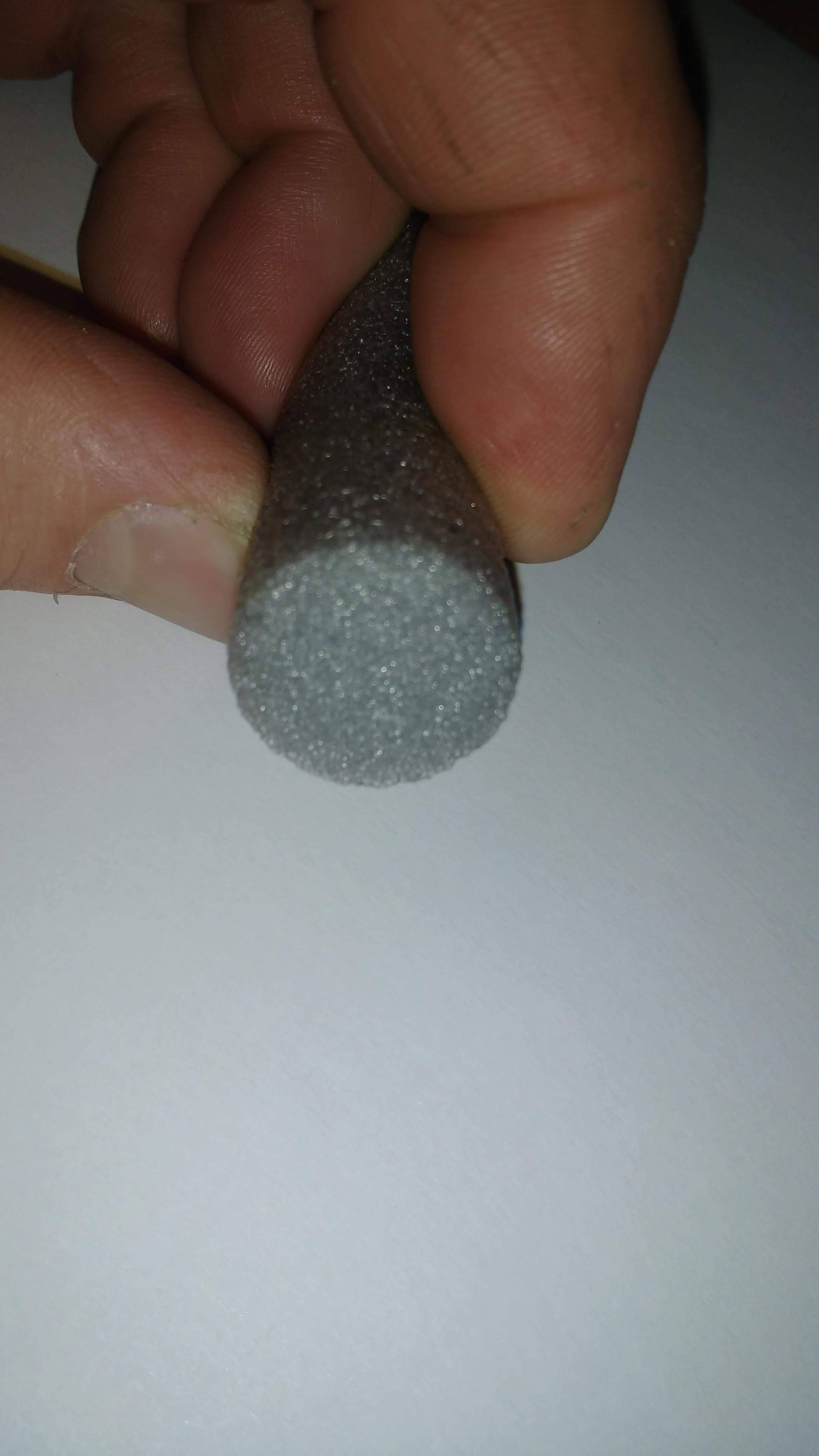

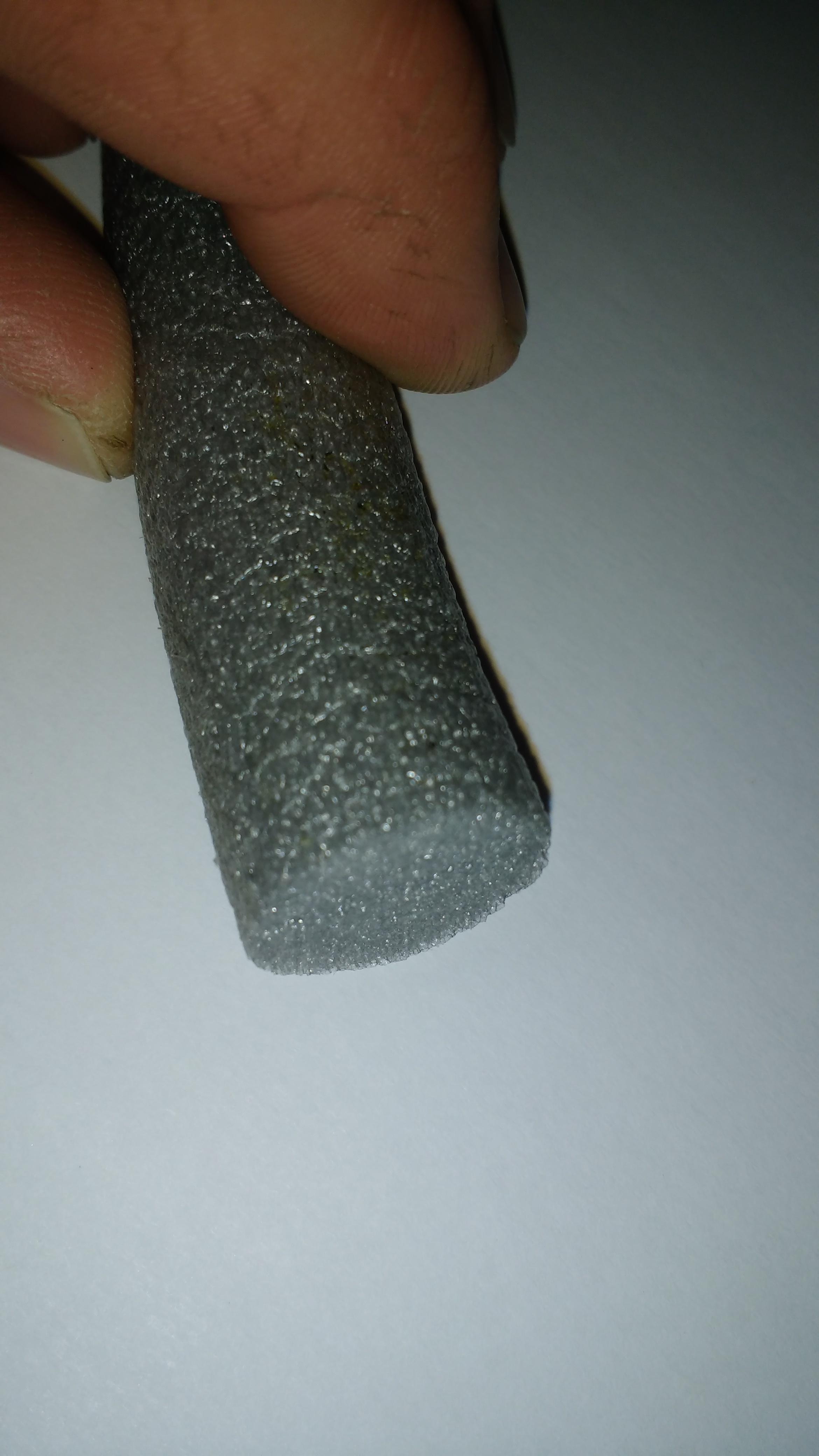

Onoff Posted October 16, 2020 Posted October 16, 2020 4 hours ago, pocster said: Then round the edges with a gloved finger . Just to gently push it in . Like that time we played doctors and nurses! You can get close celled foam strip to pack in gaps and the silicone goes on top. Saves it slumping and cuts down on the quantity needed. Used extensively in commercial curtain walling etc. Wedge in nice and tight then pump your stuff over the top:

Pocster Posted October 16, 2020 Author Posted October 16, 2020 9 minutes ago, Onoff said: Like that time we played doctors and nurses! You can get close celled foam strip to pack in gaps and the silicone goes on top. Saves it slumping and cuts down on the quantity needed. Used extensively in commercial curtain walling etc. Wedge in nice and tight then pump your stuff over the top: Too late for this shower tray . But as @Gav_P has worked out - there are plenty of other uses for such a technique !

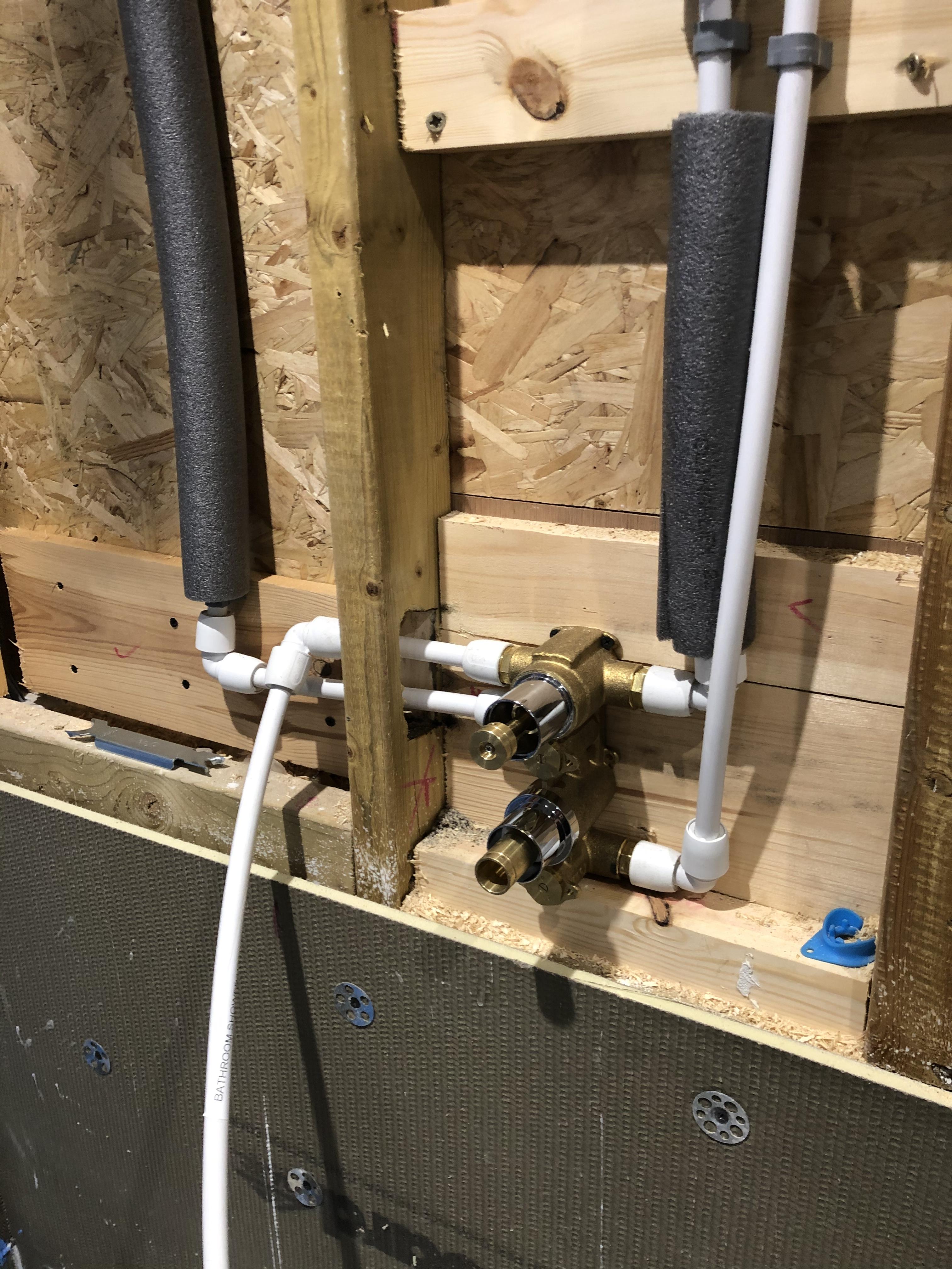

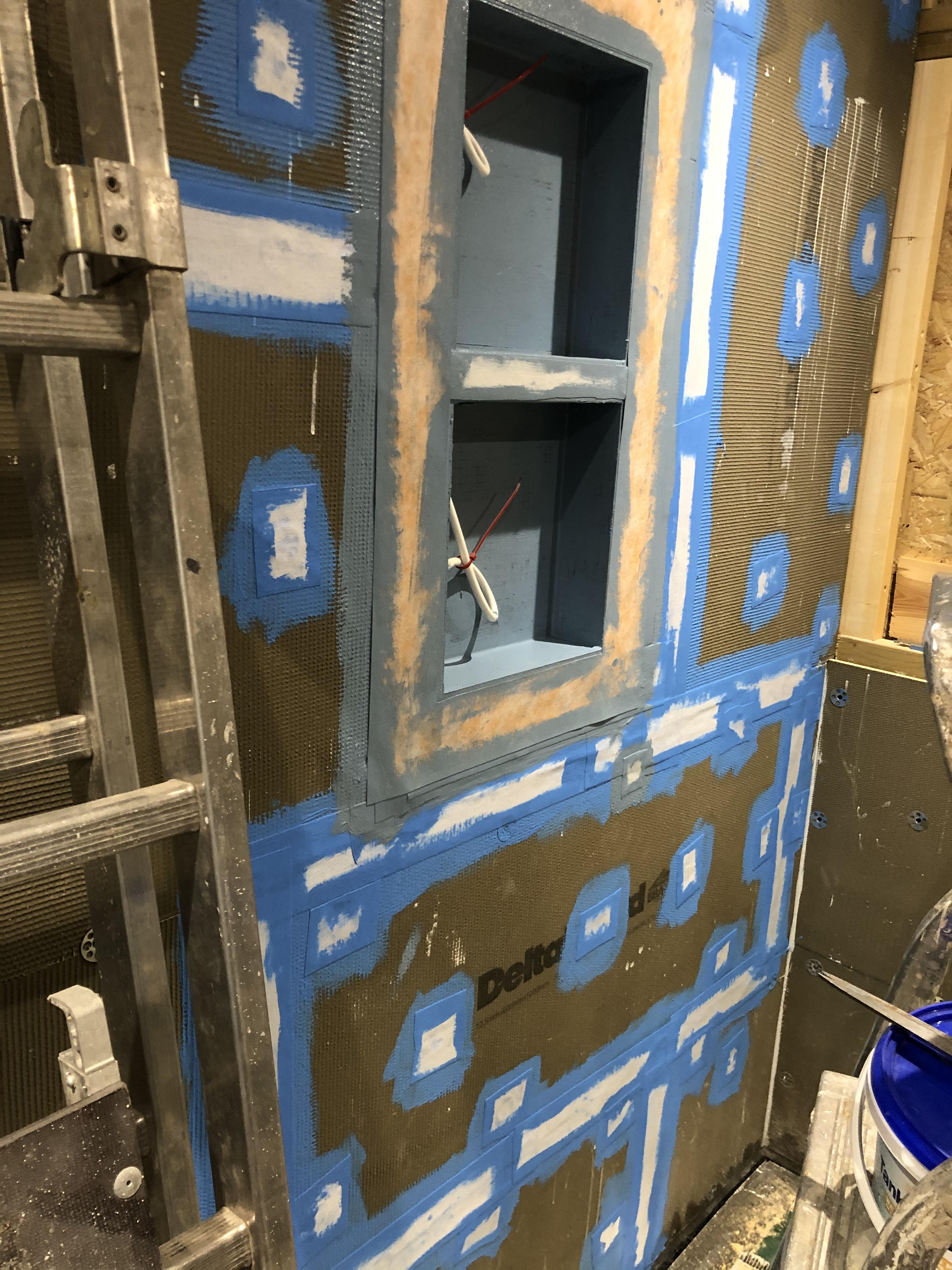

Pocster Posted October 20, 2020 Author Posted October 20, 2020 Main bathroom shower plumbing going in . All good apart from leak on the manifold ? 1

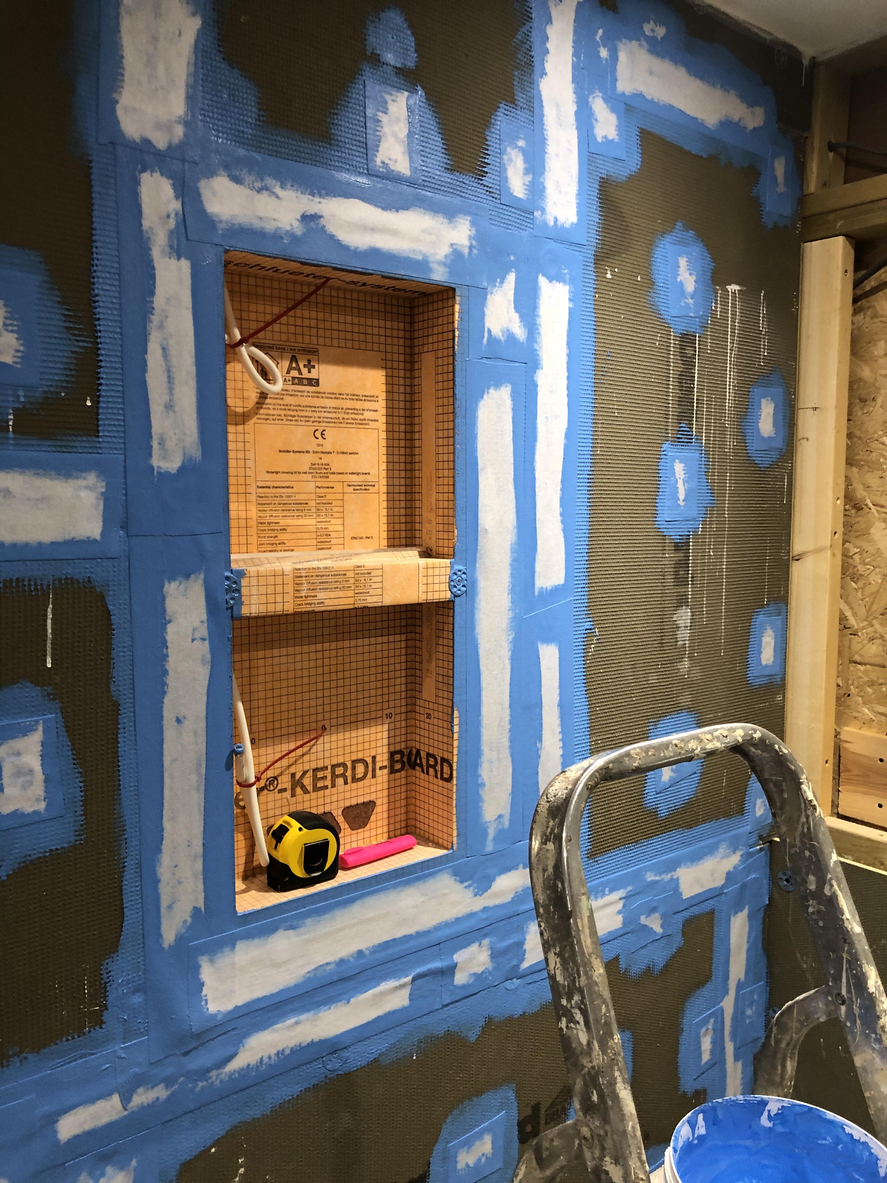

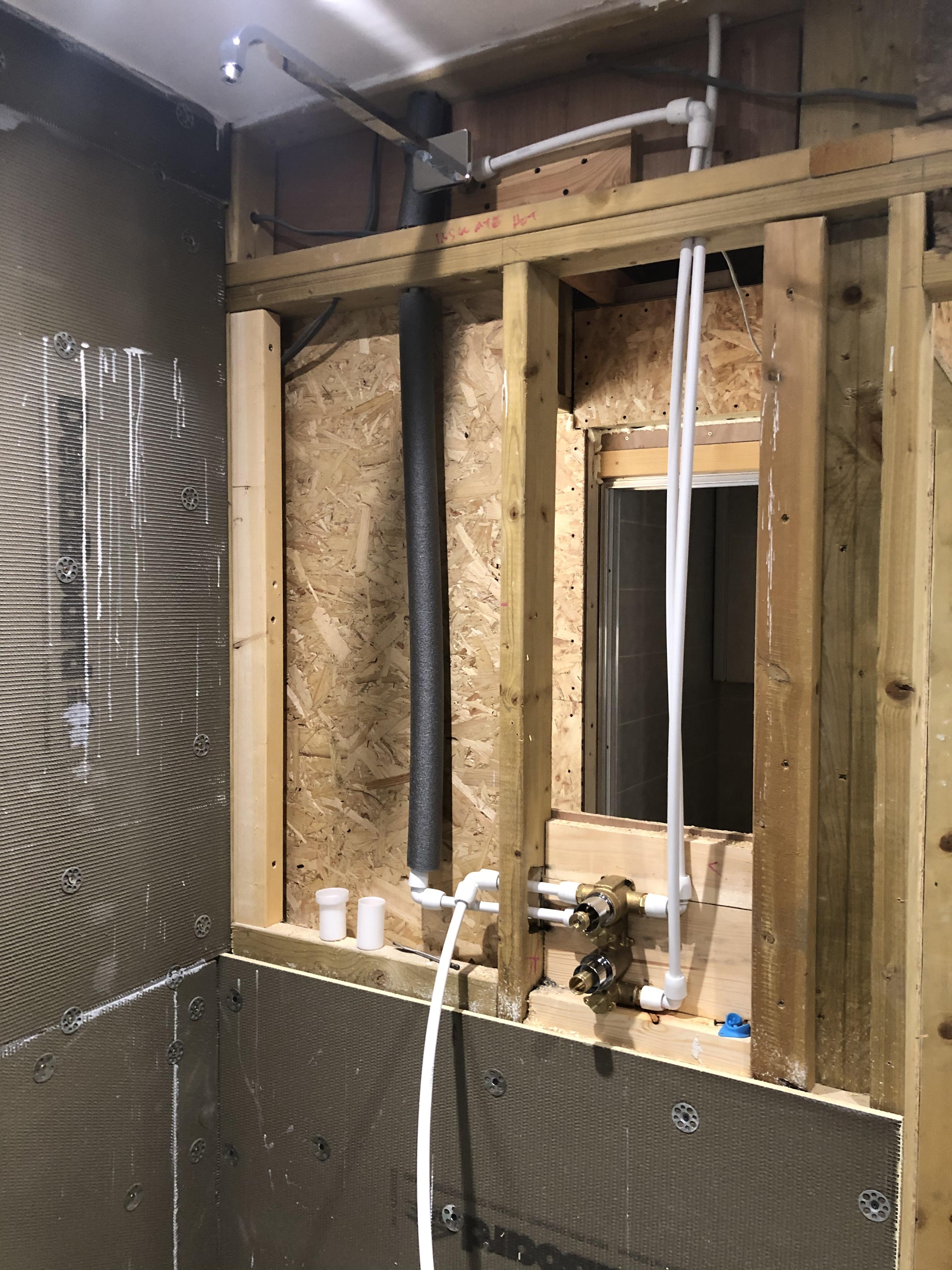

Pocster Posted October 21, 2020 Author Posted October 21, 2020 (edited) Shower has both feeds live ( fixed leak on manifold ) . Not sure if there’s the slightest of leaks though . Will leave pressurised overnight . More tanking on the other wall Edited October 21, 2020 by pocster Doh ! Forgot photos
Onoff Posted October 21, 2020 Posted October 21, 2020 8 minutes ago, pocster said: Shower has both feeds live ( fixed leak on manifold ) . Not sure if there’s the slightest of leaks though . Will leave pressurised overnight . More tanking on the other wall What's leaking, those Speedfits or do I see compressions there also?
PeterW Posted October 21, 2020 Posted October 21, 2020 2 hours ago, Onoff said: What's leaking, those Speedfits or do I see compressions there also? They are Hep2O to brass by the looks of it. https://www.toolstation.com/hep2o-male-adaptor-brass-socket/p54535 1
Pocster Posted October 21, 2020 Author Posted October 21, 2020 2 hours ago, Onoff said: What's leaking, those Speedfits or do I see compressions there also? It’s the brass to hep2o. It’s no biggy . I’ll take the suspect one off - stick 500 rounds of plumbers tape on it and try again .
Onoff Posted October 21, 2020 Posted October 21, 2020 1 hour ago, pocster said: It’s the brass to hep2o. It’s no biggy . I’ll take the suspect one off - stick 500 rounds of plumbers tape on it and try again . A wise man once said: "20 turns and a smear of goop, not a blob. No goop on the female thread " 1
Pocster Posted October 22, 2020 Author Posted October 22, 2020 Leak fixed . Look uncle Nick - I’ve been painting !
