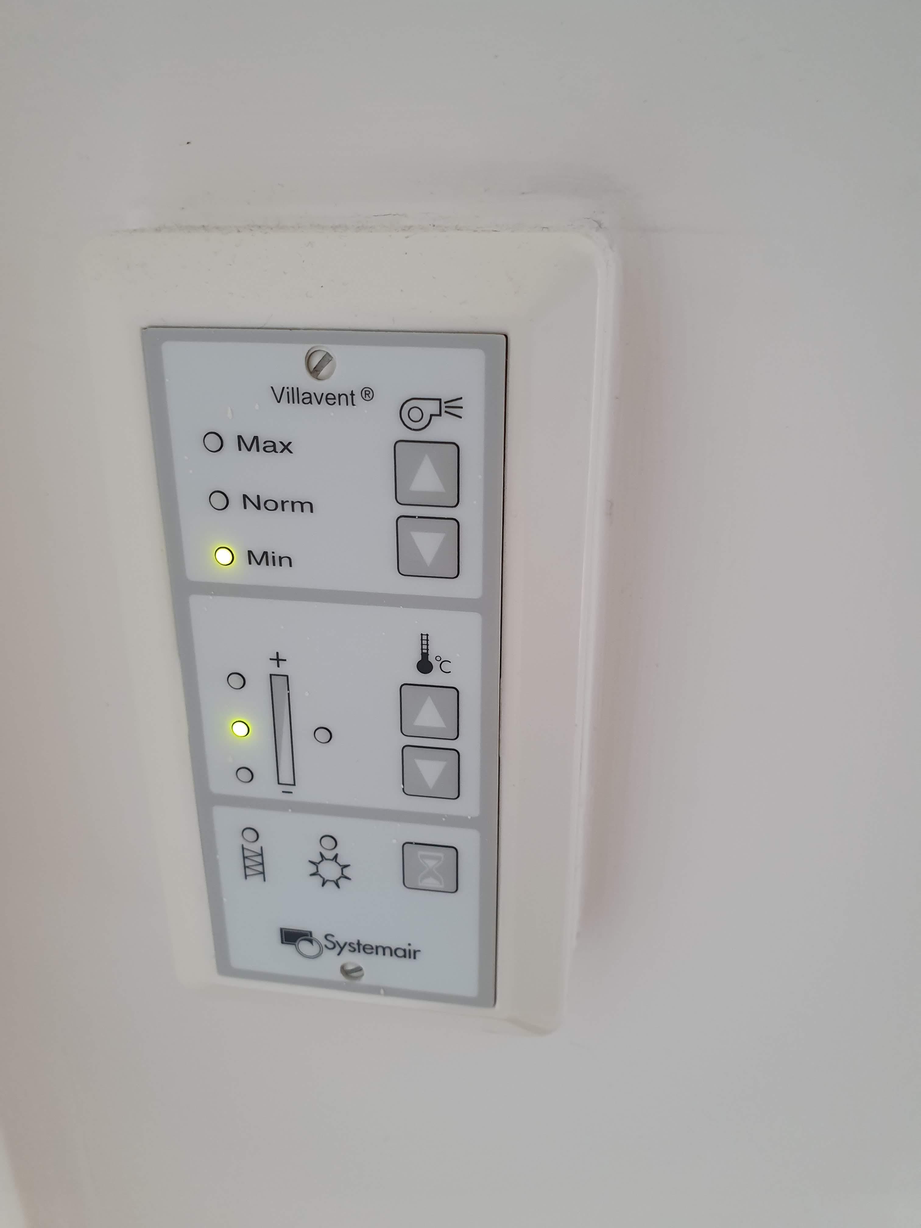

JamesJJJ Posted August 19, 2019 Author Share Posted August 19, 2019 On 17/08/2019 at 09:45, mvincentd said: I guess all units differ but maybe dig around in the menu....mine has status-energy-power consumption-avoided heating/avoided cooling-total savings. That is a nifty feature. The control panel of our Villavent is not as sophisticated: Link to comment Share on other sites More sharing options...
