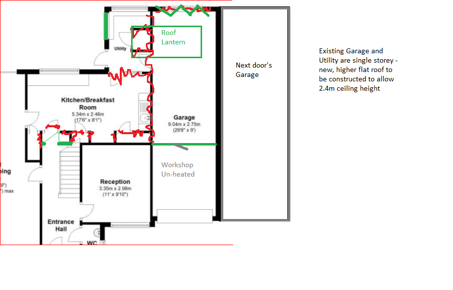

Gooman Posted August 14, 2019 Share Posted August 14, 2019 I'm planning to convert the far end of a double-length garage that's attached to the house on the left-hand side and has a party-wall with next-door's garage on the right-hand side. Most of the far end wall will be gone and replaced with bi-fold doors. At the front end there'll be a blockwork partition wall between the new space and the remaining garage/workshop/storeroom. The left-hand wall will go (in the converted space, not the remaining garage) and it will be open-plan to the kitchen. The party wall is the problem bit. Building Control have told me that as it's a party wall I need to achieve appropriate sound insulation levels, which they recommend doing by erecting a 10mm stud frame. I'll then need 100mm PIR insulation which will be taped to provide a vapour barrier. Then (presumably) I need a 25mm service void, so more battening. Then plasterboard. I hate the idea of battening twice - sounds like a real faff. Any bright ideas? Link to comment Share on other sites More sharing options...
Mr Punter Posted August 14, 2019 Share Posted August 14, 2019 What is the wall makeup for the party wall? Is it 2 x single 100mm skins with a 50mm cavity, a 215mm solid wall or what? What BC are suggesting does not sound outlandish. Link to comment Share on other sites More sharing options...
Gooman Posted August 14, 2019 Author Share Posted August 14, 2019 As we're not in the property yet I'm not 100% certain ... I believe it's just a single 100mm skin as it's just a single storey shared between the two garages. I guess my other alternative is to see if I can avoid having any electricals or rads on that wall and so avoid the need for a service gap. Link to comment Share on other sites More sharing options...

Temp Posted August 14, 2019 Share Posted August 14, 2019 1 hour ago, Gooman said: The left-hand wall will go (in the converted space, not the remaining garage) and it will be open-plan to the kitchen. To me that sounds like the difficult bit. Presumably this wall is brick/block and supports the roof of the house so a steel beam will be needed. Possibly also a brick pier or steel post with foundation in what was the corner? Link to comment Share on other sites More sharing options...
Gooman Posted August 14, 2019 Author Share Posted August 14, 2019 6 minutes ago, Temp said: Have they already converted "their side"? If not did the BCO say anything about what you need to do to prevent fire spread through shared roof? Nope, that's still a double length garage. BCO didn't mention anything about fire spread ... what would be expected there? Link to comment Share on other sites More sharing options...
Gooman Posted August 14, 2019 Author Share Posted August 14, 2019 3 minutes ago, Temp said: To me that sounds like the difficult bit. Presumably this wall is brick/block and supports the roof of the house so a steel beam will be needed. Possibly also a brick pier or steel post with foundation in what was the corner? Yep - I'm expecting both to be required. Link to comment Share on other sites More sharing options...

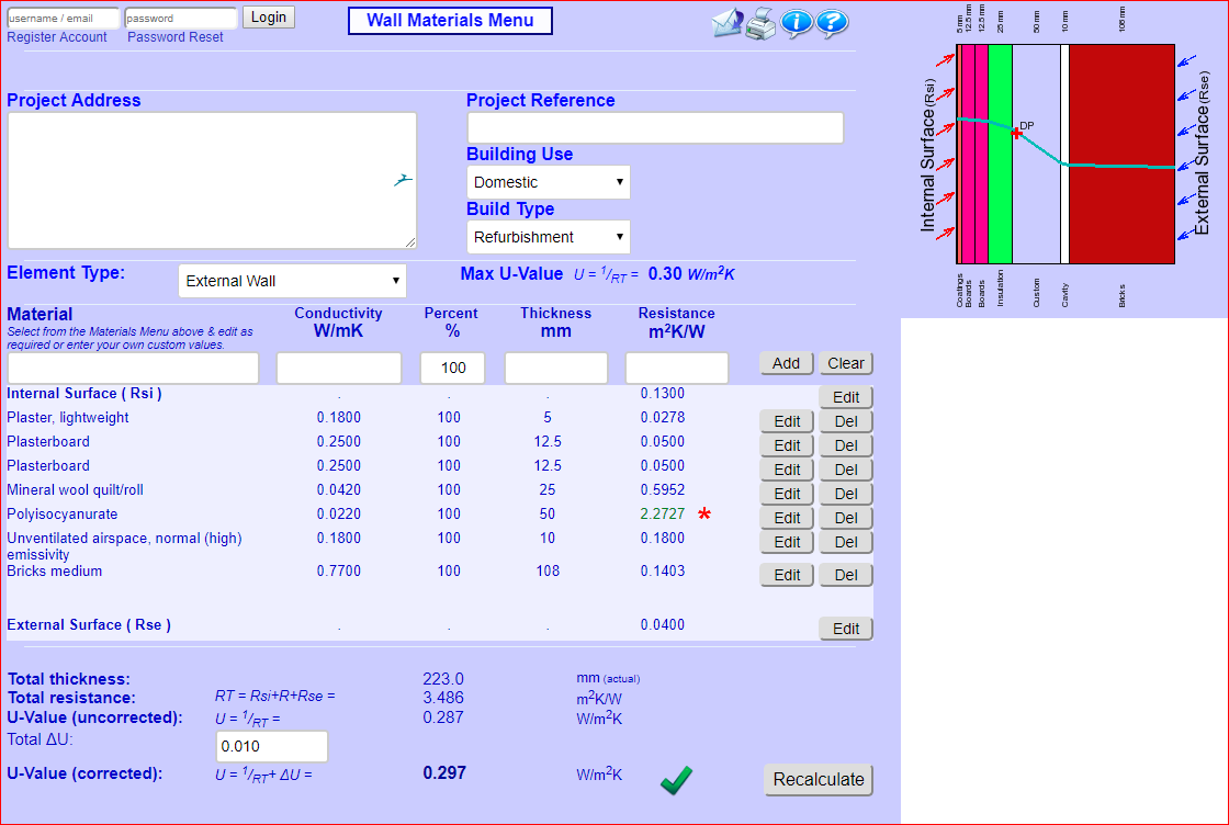

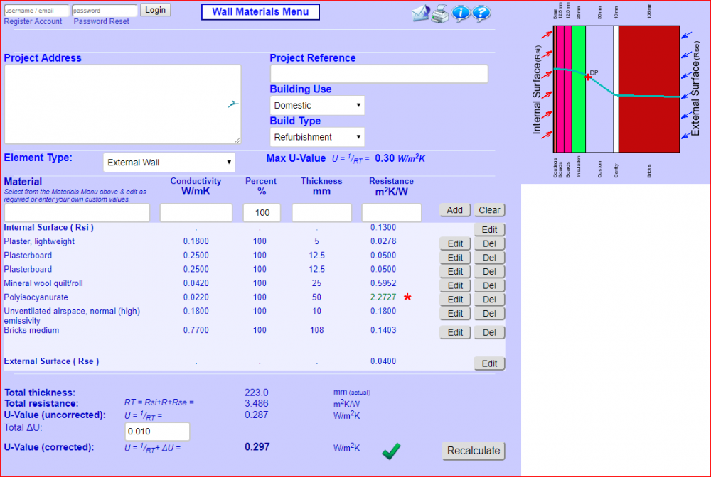

andyscotland Posted August 15, 2019 Share Posted August 15, 2019 This free online calculator allows for fairly comprehensive calcs http://www.changeplan.co.uk/u_value_calculator.php - haven't thoroughly double-checked its accuracy but used it early in my project and results appeared to be about right. If you want to be able to print off something a bit more professional-looking / save things and come back to them later the BRE tool at https://www.brebookshop.com/details.jsp?id=139470 is £60. Only works on Windows PCs though. If there's an enclosed unheated space on the other side of the wall you can include an allowance to reflect that won't lose as much heat as if it was open to the outside air. There's a section on how you can work that out in BR443 https://www.bre.co.uk/filelibrary/pdf/rpts/BR_443_(2006_Edition).pdf which I believe is still valid for use. 1 Link to comment Share on other sites More sharing options...
Gooman Posted August 15, 2019 Author Share Posted August 15, 2019 The Changeplan calculator is exactly what I was after, thanks! That suggests that 50mm PIR (as part of the cross section I proposed above) would give a u-value of 0.286. The enclosed unheated space on the other side is a non-integral garage (as is the space I'm converting) which seems to be specifically excluded by BR443. So now the tricky part is specifying the timber frame. Ideally I want PIR between the studs and a separate layer over to avoid thermal bridging. But with only 50mm PIR that seems tricky, as the timber frame will need to be rigid enough. Any thoughts? Link to comment Share on other sites More sharing options...
PeterW Posted August 15, 2019 Share Posted August 15, 2019 1 hour ago, Gooman said: The Changeplan calculator is exactly what I was after, thanks! That suggests that 50mm PIR (as part of the cross section I proposed above) would give a u-value of 0.286. Not sure that is correct as 50mm doesn't give me 0.286 (using a uValue of 0.022) at 50mm so not quite sure where that is from..? I would go with a 10mm gap with a 90mm stud spaced off the wall using steel studs and nuts, and then 70mm between the studs with 25mm over. A single skin of fireline 15mm plasterboard with skim will be adequate and heavy enough to stop any sound. Minimizing the cold junction at ceiling level will be your issue - what is the design detail for this..? Link to comment Share on other sites More sharing options...

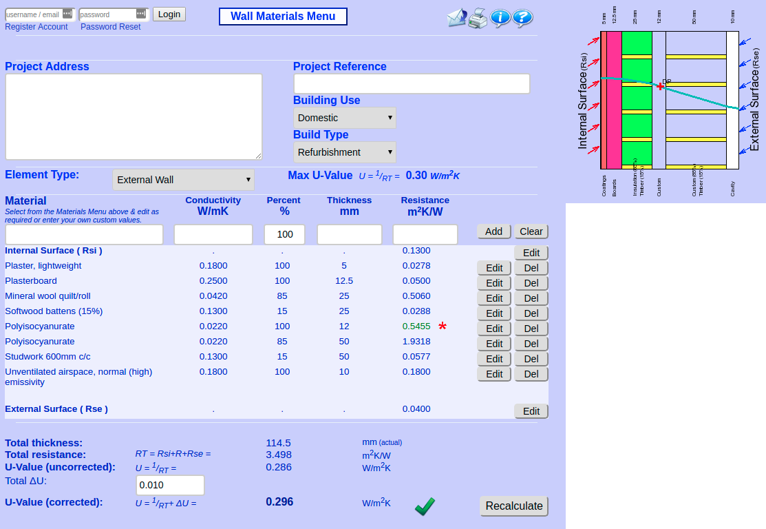

Gooman Posted August 15, 2019 Author Share Posted August 15, 2019 Just occurred to me. If my stud wall is independent from the garage party wall (offset by 10mm) do I need to worry about thermal bridging at all? The footer will be fixed into the concrete floor, but I doubt that's a big deal. If bridging isn't an issue I can have a party wall build-up of: 10mm gap 75mm studwork filled with 50mm PIR and 25mm rockwool 2 x 12.5mm PB Plaster skim According to http://www.changeplan.co.uk/u_value_calculator.php that gives me a u-value of 0.297 and a depth of only 115mm - see image Link to comment Share on other sites More sharing options...
andyscotland Posted August 15, 2019 Share Posted August 15, 2019 The studs will still bridge from the plasterboard through to the cavity, bypassing the PIR/wool so you will need to include both those insulation layers as bridged by an appropriate fraction of timber. Link to comment Share on other sites More sharing options...
Gooman Posted August 15, 2019 Author Share Posted August 15, 2019 (edited) 55 minutes ago, andyscotland said: The studs will still bridge from the plasterboard through to the cavity, bypassing the PIR/wool so you will need to include both those insulation layers as bridged by an appropriate fraction of timber. Good point well made. I've skimmed BR443 and unfortunately I'm none the wiser. I assume I need to account for a timber bridging factor of 15%, but it doesn't seem to explain what that means. Is the R value for the elements that are bridged reduced by 15%, or to 15%? OK, read other stuff on this. Man, this gets complex. My head hurts. A different approach is needed I think. So now I'm thinking: 10mm gap 50mm studwork filled with 50mm PIR 12mm PIR surface mounted, joints taped 25mm batten filled with rockwool 12.5mm PB Plaster skim That seems to give a u-value of .261 on a combined thickness of around 115mm. Edited August 15, 2019 by Gooman Link to comment Share on other sites More sharing options...
andyscotland Posted August 15, 2019 Share Posted August 15, 2019 1 hour ago, Gooman said: That seems to give a u-value of .261 on a combined thickness of around 115mm. I've had a quick go on changeplan (not at my Windows machine so can't double check in the BRE tool). I get 0.296 for that construction: In case you were still unclear on the thermal bridging - unfortunately it's not as simple as just amending the R value by the % area - the heat tends to want to flow through the path of least resistance, so the software essentially has to calculate all the individual thermal paths then work out how much heat will throw through each route. The good news is changeplan will do this for you - you just have to add each material type with the relevant % of the wall area. E.g. as above with the 85% mineral wool / 15% timber battens. Couple of other things to consider: Do you have a source for 12mm PIR? I have a hunch that 25mm is the thinnest generally available - I think you can get slightly thinner mounted on insulated plasterboard but that won't work with your service void detail. I'm not certain but I would suspect a 50mm stud (especially on 600mm centres) might be too wobbly in practice. You could turn thicker timbers sideways, or reduce the centres, or fit extra noggins - but all of that would increase the timber fraction of that layer and reduce the u-value. If you're planning to use PIR as part of the buildup, you might be worth contacting Ecotherm technical. They were super helpful when I was trying to optimise wall thickness compared to u-value and ran off various different options for me (for free). They'd need to know your target u-value and any other constraints. They will potentially also use a higher resistance for the cavity due to the low-emissivity foil coating on the boards, and possibly also a better allowance for the unheated space next door. Also, not sure about England but in Scotland you are allowed to have a component that is worse than the target so long as you compensate for it by increasing the performance of something else. So e.g. your garage wall could have a slightly higher u-value if you "over-insulate" the roof. Or indeed if you just specify a window / door that exceeds minimum building regs values. Obviously the calcs for that are a bit more involved (not too bad - basically multiply each u-value by the area and add them all up) and you don't want to take it to extremes for your own comfort and energy usage. But might be worth considering if you're really struggling to get that wall thick enough. Link to comment Share on other sites More sharing options...
Gooman Posted August 15, 2019 Author Share Posted August 15, 2019 Ah, I hadn't realised that Changeplan handled the studwork and thermal bridging implications. Neat! Celotex PB4012 is 12mm. Not priced it up yet ... that may change my plans again. I'm in England, so unless someone else can comment positively on that route it's not going to be an option. Link to comment Share on other sites More sharing options...
