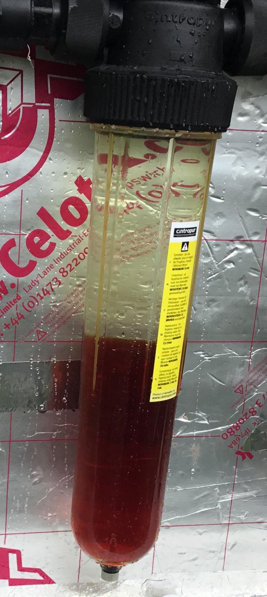

Cpd Posted August 27, 2019 Author Posted August 27, 2019 Well....... it did not go very well, I got some thin bleach but by the time I realised it was not working great it was already to late......... I had a feeling the bleach was not flushing properly through the system so I started again and added some red food dye to the bleach, the top half would then get taken into the system but the lower half remained in the filter in what can only be described as still water. I assume that the bleach was not mixing very well as it was heavier than the water and / or was because of the jumbo filters and the water lower down just did not get pulled up. Anyway what should have been a quick job ended up taking most of the day......... cutting a very long and boring explanation-short I eventually got the whole system filled with red dyed bleach water and let it sit for an hour, I then spent the rest of the day flushing the system out until the water ran totally clear, I then made up a batch of blue dyed water and ran that through the system until I had blue water coming out of every tap, then I flushed this all out until nothing but clear water remained....... you need to remember that this system services three buildings and a cabin..... so lots of running from one building to another....... anyway the moral of the story is to CHECK beforehand that the bleach is readily mixed with water...... due to the way my system works I am confident that everything is flushed out and even went up in the loft with a torch to check the header tank as I was concerned that the bleach may have settled in the bottom below the take of point. But it was fully clear. What a bloody palaver. The photo shows how the first half of the red bleach gets taken but the second half just sits there....... this could have been very dangerous if I had not been a bit suspicious as you cannot see if the bleach has dispersed without the dye.
