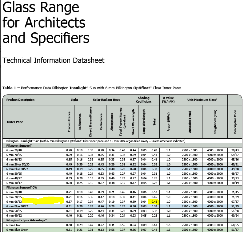

Adam2 Posted August 12, 2019 Posted August 12, 2019 5 hours ago, Mr Punter said: Really? We have several different glass specs on the same elevation - double glazed, triple glazed, toughened, laminated, different gap widths and pane thicknesses and I have not noticed any difference. We're getting solar control glass and ideally want the optiwhite range from pilkington, for the sliding doors a local supplier is fine to provide this but some of the European window companies won't commit to this and state an equivalent will be provided and although they may look similar I want to be 100% sure they will look 100% the same where we have a large window near a sliding door where they come from different companies.
Mr Punter Posted August 13, 2019 Posted August 13, 2019 11 hours ago, Adam2 said: We're getting solar control glass and ideally want the optiwhite range from pilkington, for the sliding doors a local supplier is fine to provide this but some of the European window companies won't commit to this and state an equivalent will be provided and although they may look similar I want to be 100% sure they will look 100% the same where we have a large window near a sliding door where they come from different companies. I have used low iron glass in some 25mm thick external balustrading without handrail and the difference in colour is noticeable, especially when looked at from the edges. It lets all the light through, so make sure you have decent solar control. Does it work OK with low e coatings?
Adam2 Posted August 13, 2019 Posted August 13, 2019 6 hours ago, Mr Punter said: It lets all the light through, so make sure you have decent solar control. Does it work OK with low e coatings? Looking at the marked one below with more info here : https://www.pilkington.com/en-gb/uk/products/product-categories/solar-control/pilkington-suncool-range/pilkington-suncool-ow
