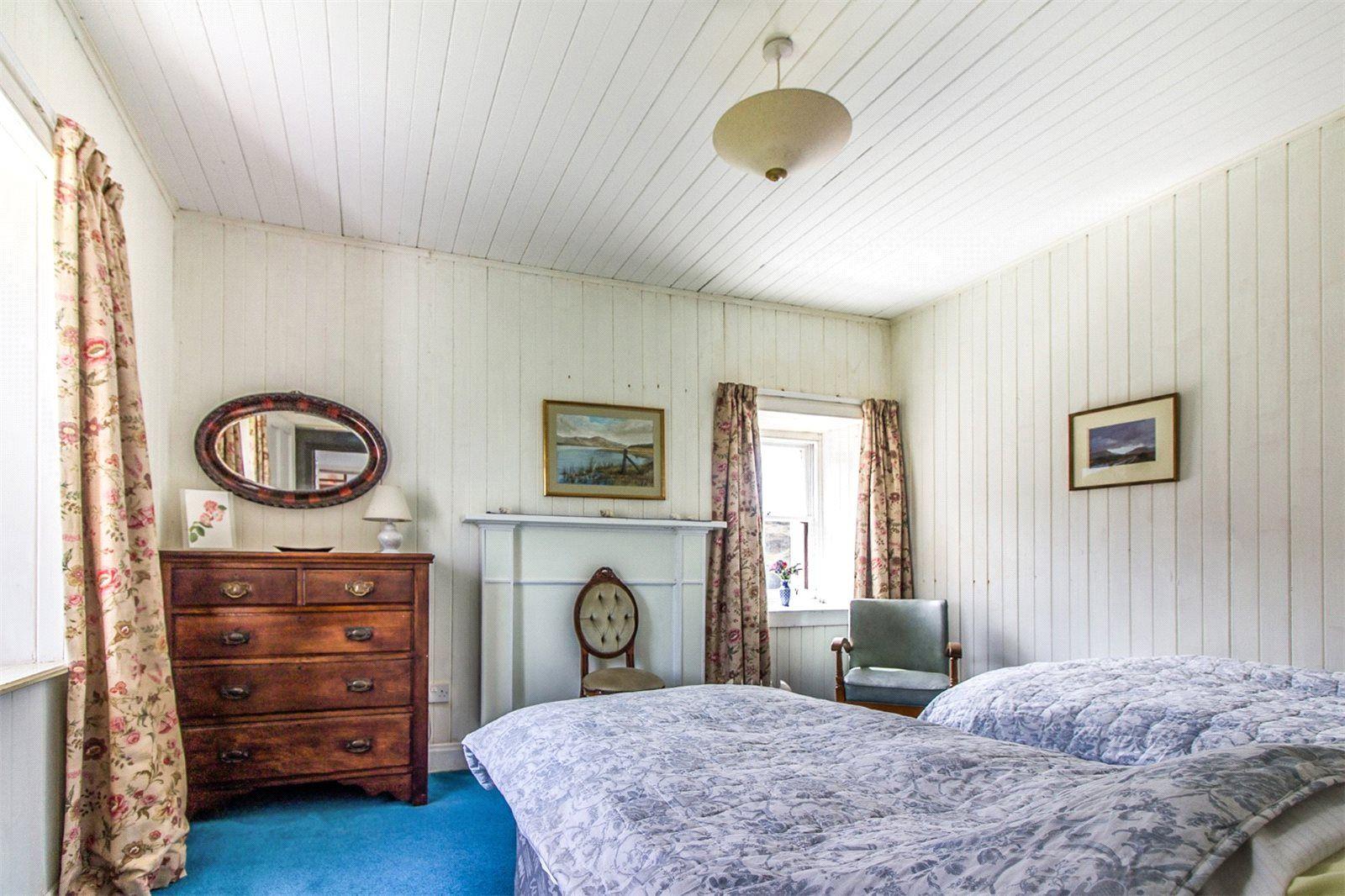

sniederb Posted August 11, 2019 Share Posted August 11, 2019 We've looked at quite a few old buildings in the last few months, "old" meaning build in the area of 1860 - 1920. All of these buildings have issues with damp. My understanding (but this is more speculation) is that these buildings were originally built with an open dirt floor, so the dampness just went into the entire house and ventilated out. Putting in a floor creates a sealed off space where dampness accumulates and then seeps into the floor and walls. We've seen plenty of statements to the like of "that wall just needs some repointing or similar". This doesn't seem to be fixing the problem, just the symptom. How is the dampness problem in these buildings fixed for good? (Attaching image of one room showing the wood paneling of the original outer wall, along with the typical signs of damp, esp. in the far top corner) Link to comment Share on other sites More sharing options...
ProDave Posted August 11, 2019 Share Posted August 11, 2019 I see a lot of these old "croft houses" in my travels as an electrician. The walls are typically 3 feet thick, stone inner and outer, rubble / dust core. Absolutely no damp proof course whatsoever in the walls and anything from poor to no foundations under the walls. That one looks pretty original with the wood paneling. Most have been "modernised" first with lath and plaster, and later with plasterboard. the mistake most people make is they line the inside with timber (usually no more than 2" by 2" and board it. Rarely do they put any insulation in, and almost without fail they leave the gap between the stone walls and the paneling open to the loft space so the gap is open to cold air. On a windy day if you remove a light switch or a socket you are greeted by a howling icy cold blast coming out of the hole. Most of these come with an EPC rating of E or F I have seen various attempts at "damp proofing" them. Some paint the stone walls about 2 feet up with bitumen, On one I installed a "device" that was a small mains powered box that connected to a thin wire laid all around the perimiter at floor level. Quite what that was supposed to do or whether it worked I have no idea. Do you really want an old cold damp house with small windows? There are better properties available or why not build a decent house, plots are a lot easier to find up here than many other parts of the UK. 1 Link to comment Share on other sites More sharing options...

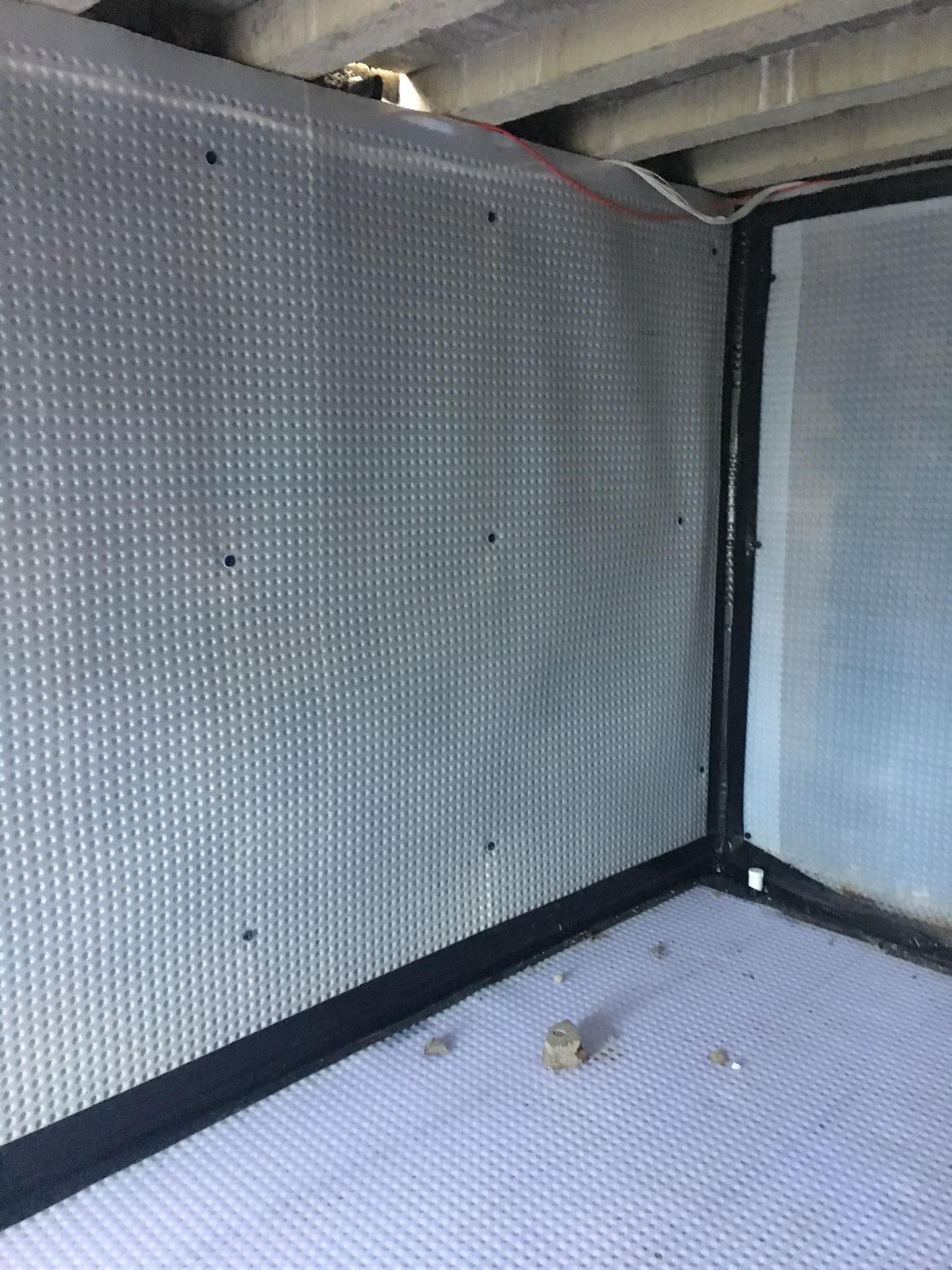

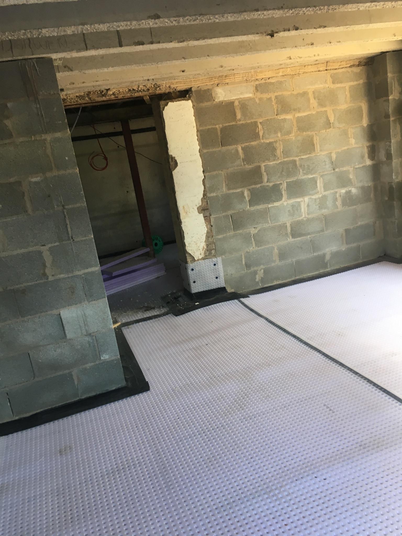

nod Posted August 11, 2019 Share Posted August 11, 2019 The best and 100% way of curing damp is to tank the walls Not the cheapest but not as expensive as you may think Below shows a job that I was doing a few week back Although this was a cellar With a perimeter drain Tanking above ground is quite q quick and simple job Link to comment Share on other sites More sharing options...
