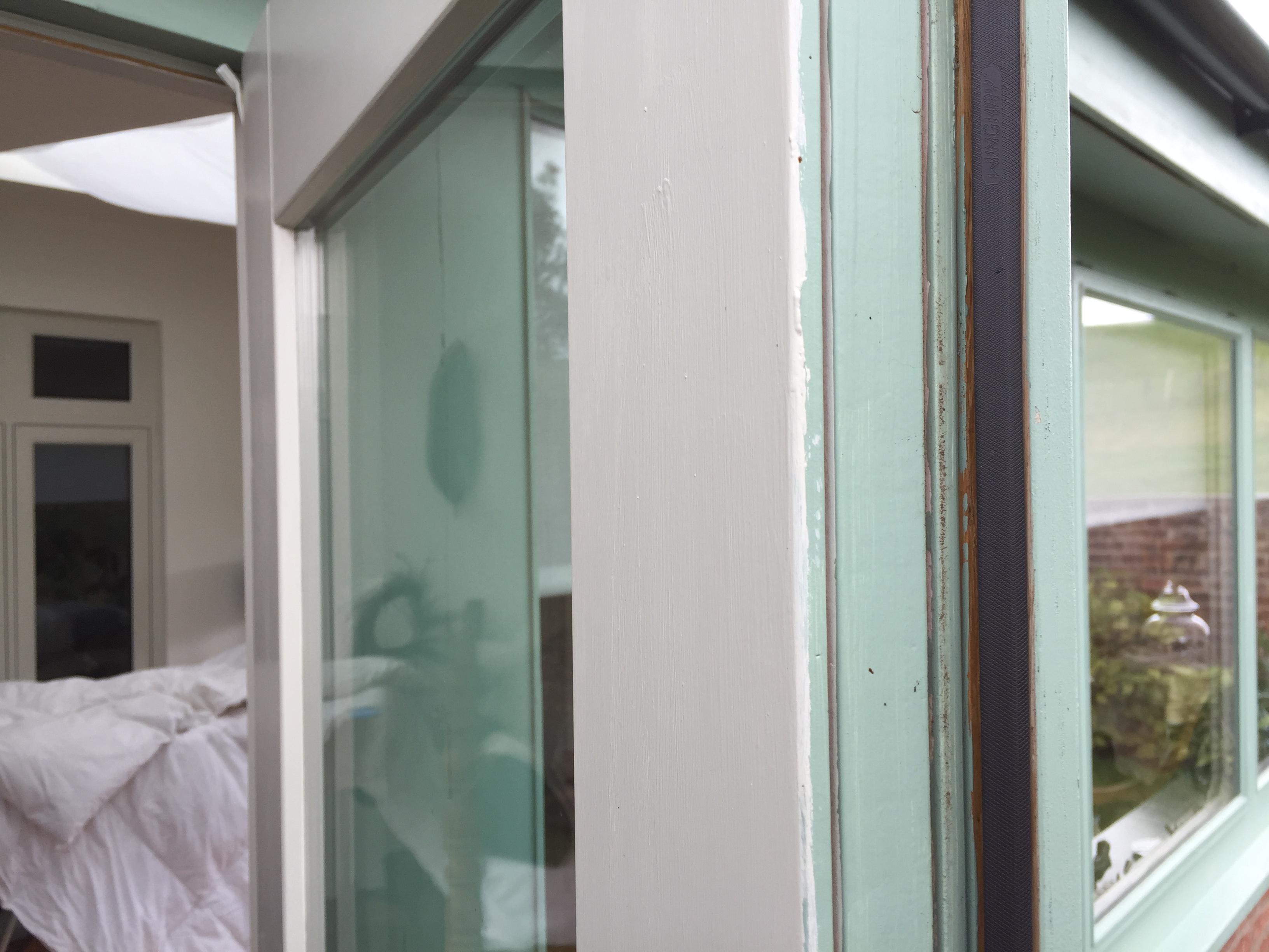

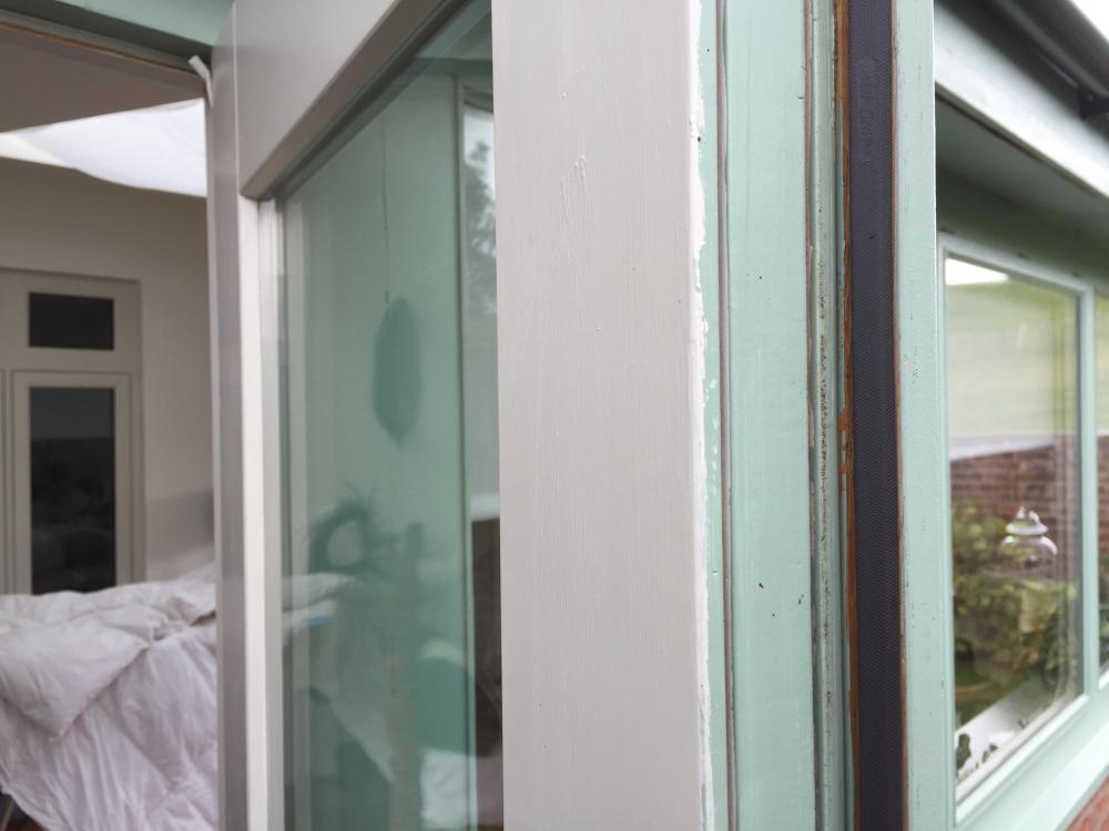

H F Posted August 23, 2019 Author Posted August 23, 2019 12 hours ago, PeterW said: Why are you replacing the beading ..?? Repair may be quicker and easier - is there anything actually wrong with it ..? The beading is shot and was never installed correctly - it’s also a soft wood. They also used lots of short lengths so there are joints everywhere and they have been sealed properly so water can get in. It’s not been the best job in the world.

PeterW Posted August 23, 2019 Posted August 23, 2019 Ah ok. Don’t forget to prime the back of it before you use it to make it last longer.
DavidFrancis Posted August 23, 2019 Posted August 23, 2019 How long since those windows were last painted? If it was four or five years, then they don't look too bad to me. In the pictures of the beading you've posted they look OK too. I've used both Bedec MSP and Johnstones, and think Bedec is much better. Huge faff with the Johnstones, with primer, undercoat and topcoat. I regularly have to repaint our cills and bottom beads on exposed windows. Don't know about the cracks on the wide sections of wood. Could they be plywood?
H F Posted August 23, 2019 Author Posted August 23, 2019 48 minutes ago, PeterW said: Ah ok. Don’t forget to prime the back of it before you use it to make it last longer. We have also received that advice from a surveyor friend and will definitely be doing that.
H F Posted August 23, 2019 Author Posted August 23, 2019 5 minutes ago, DavidFrancis said: How long since those windows were last painted? We think that these windows were last painted 18 months ago. They were never primed and we think they only did one coat. We're thinking of going with Ronseal if they can match colours. 6 minutes ago, DavidFrancis said: Don't know about the cracks on the wide sections of wood. Could they be plywood? They have used plywood in some places and it all needs replacing because its swelled and cracking. As a priority we're going to tackle the beading on the windows, because one of the windows looks to be getting some water in the double glazing and replacing all the windows is a scenario we really need to avoid.
Onoff Posted August 23, 2019 Posted August 23, 2019 1 hour ago, Home Farm said: We think that these windows were last painted 18 months ago. They were never primed and we think they only did one coat. We're thinking of going with Ronseal if they can match colours. You don't need to prime or undercoat with Bedec MSP but it does need 2 to 3 coats. I wonder if they skimped on that? Data sheet for it here: MSP-technical-data-sheet.pdf
H F Posted August 23, 2019 Author Posted August 23, 2019 8 minutes ago, Onoff said: I wonder if they skimped on that? They skimped on a lot of things.

DavidFrancis Posted August 23, 2019 Posted August 23, 2019 If you've got water between one pane and another, it's probably not to do with the beading. More likely the seal on that unit (the material between the two panes) has failed. I've read that using acetoxy silicone to bed the panes can cause this problem, but there's probably a few other causes besides. (Everbuild say their acetoxy silicone should not be used near the edge sealant of double-glazed units.)
