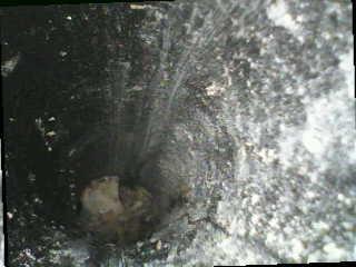

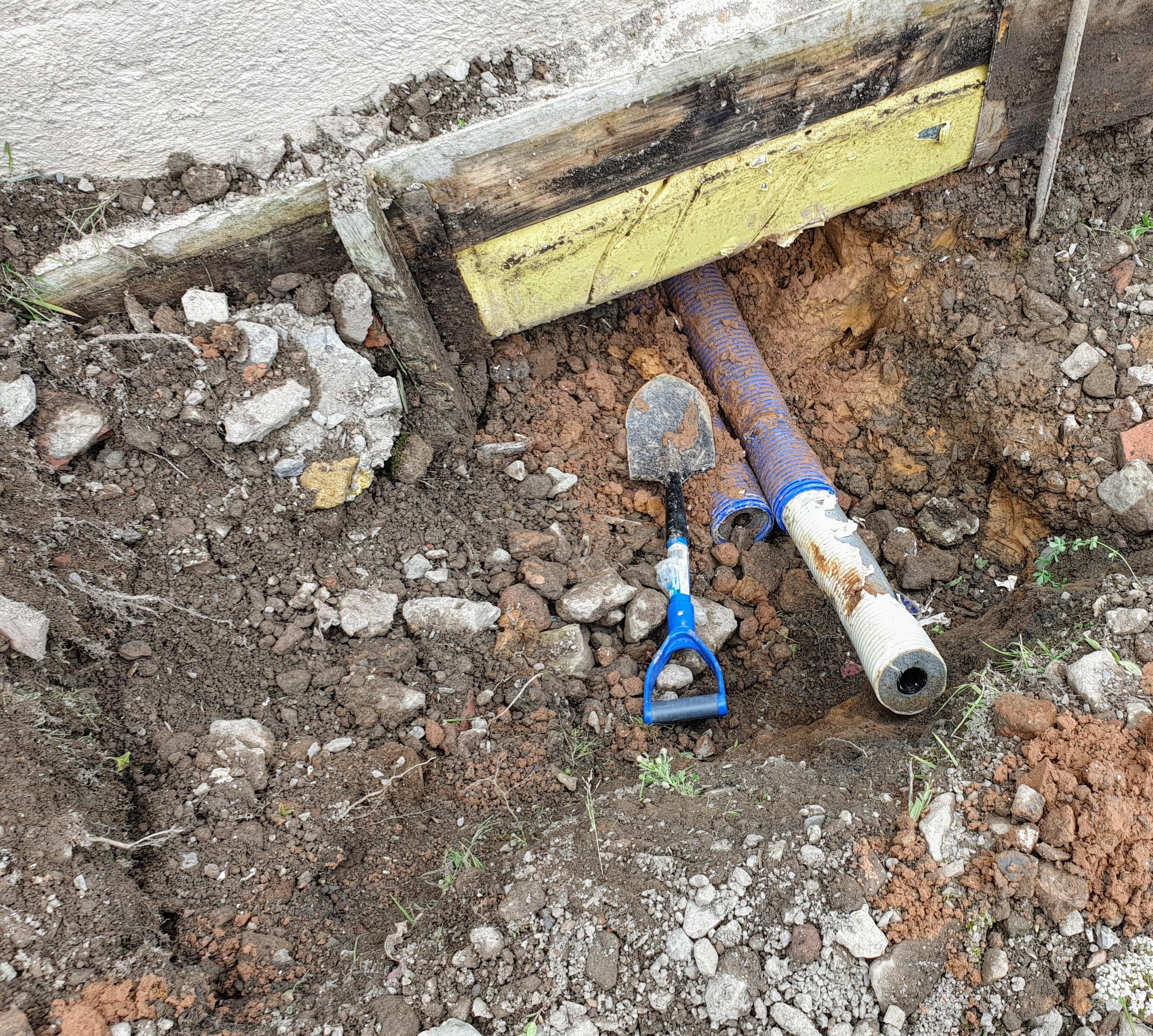

ToughButterCup Posted August 2, 2019 Share Posted August 2, 2019 Why every time I dig a hole do I run into problems? Have a look at this : That, my friends is a stone at the bend in our water services pipe. I was hoping that today's little digging escapade would be easy: dig down next to the house, find the end of the water services pipe (big blue thing with an insulated pipe in it), thread the blue 22mm pipe through it, and all would be well. But. I have threaded some flexible fiberglass rods down the pipe: no joy run water through the pipe: it flows - not freely, but it flows rammed 22mm pipe down the inside of the services pipe to try and persuade the stone to leave : no joy tried threading braided wire through the services pipe - in the hope that if it got past the stone, we could dislodge it. I'm going to have to take the whole pipe out aren't I? Poo. 1 Link to comment Share on other sites More sharing options...
ProDave Posted August 2, 2019 Share Posted August 2, 2019 When you say "water services pipe" do you just mean "duct"? If so, measure where the blockage is, dig down there. CUT the duct, remove the blockage, patch up and thread your pipe. Link to comment Share on other sites More sharing options...

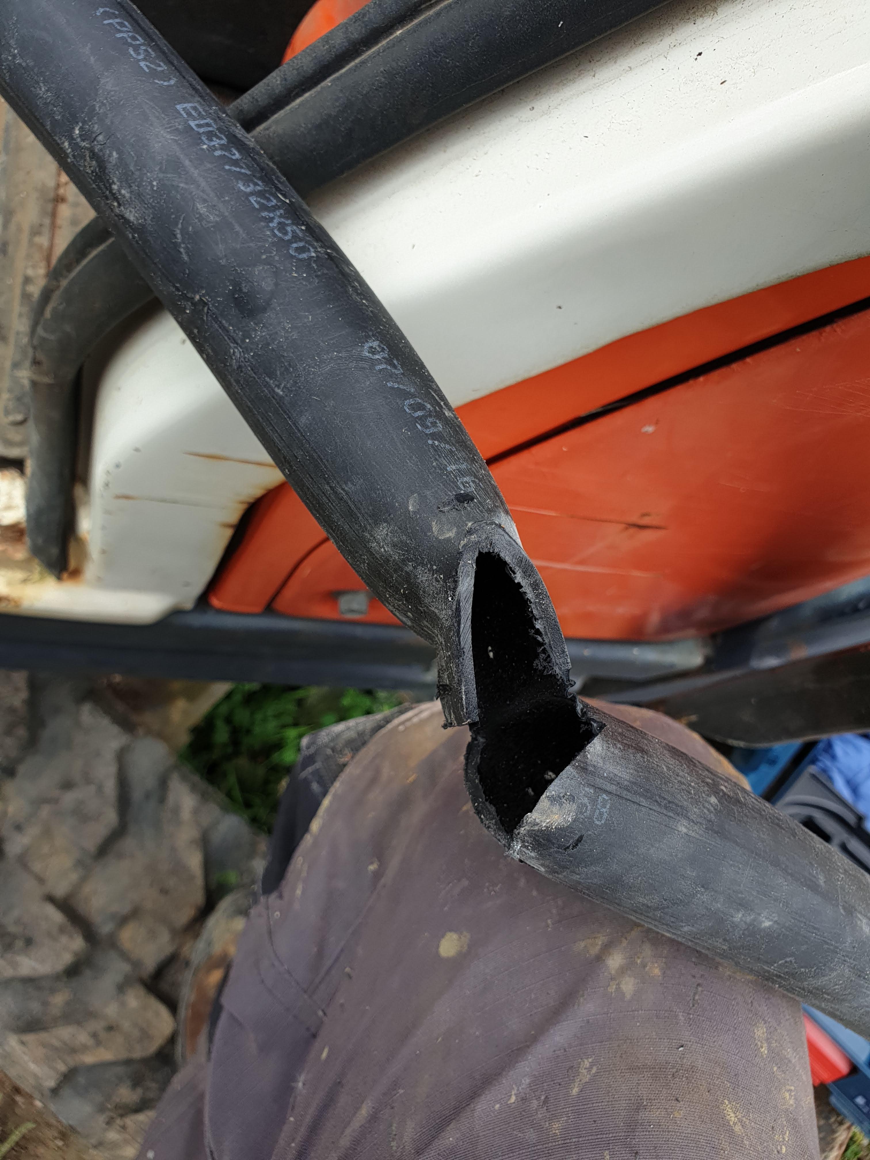

ToughButterCup Posted August 2, 2019 Author Share Posted August 2, 2019 34 minutes ago, ProDave said: When you say "water services pipe" do you just mean "duct"? [...] Yes, I meant duct. Here's how I solved the problem ......... The duct is insulated, and just a bit over 2" wide. I tried thumping the blockage hard by inserting a 22mm pipe inside the sleeve. I noticed that the insulation was moving a bit. Like this. So I grabbed the insulation and out it all popped. And of course, I was desperate to see the damn stone that caused me so much annoyance. So out with the angle grinder.... Nay friggin stone. The bend forced on the duct was so acute that it stopped the 22mm pipe going through. So what was the object in the image above? We'll never know. Presumably now, all I need to do is shove the right amount of 22mm through the the duct , cap it off (mechanical stop-end) fill the blue duct with foam, back-fill the trench and Bob's my Uncle? Do I really need to foam round the pipe in the duct? Link to comment Share on other sites More sharing options...
