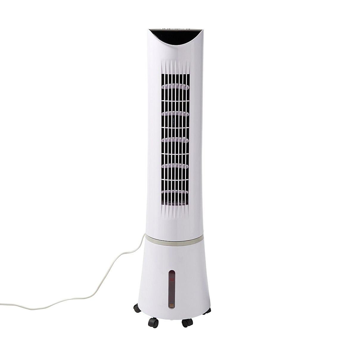

lizzie Posted July 25, 2019 Share Posted July 25, 2019 @Ferdinand if you want cheap then these are a bargain but may take a week for delivery and being water based you do need to be vigilant so as not to let bugs grow but as a temp solution.... https://www.gogroopie.com/deal/15i2f5c1b0u/2-in-1 Portable Air Cooling Unit with Remote Control Link to comment Share on other sites More sharing options...

Ferdinand Posted July 26, 2019 Author Share Posted July 26, 2019 18 hours ago, lizzie said: I am liking the tower one it would fit very neatly in a corner of my room but I cannot find either a price or a spec that says how many sqm room size it suitable for....do you find that info somewhere? My feeling is that it would do it, but that that would depend on everything else being equal. And I do not know if that is the case in your house. Ferdinand Link to comment Share on other sites More sharing options...

Ferdinand Posted July 29, 2019 Author Share Posted July 29, 2019 (edited) Probably wrapping up. So I bought one of these design-led air-redistributors from B&Q ("Evaporative Cooler"), which looks like a cross between a Triffid and something else. It even twists left and right. They call it an air conditioner, which it is not. https://www.diy.com/departments/blyss-white-45-3-speed-variable-air-conditioner/1270235_BQ.prd Comes with nice features like a sleep function which switches it randomly to prevent constant noise, and very good at keeping the place cool once it is cool. Also comes with a basic design flaw in that the water is added through a detachable door on the back at the bottom, and the only way to empty it is to run it for hours or to turn the whole caboodle upside down outside. So it is going back, and I will find one with a jug unit that can be taken out and filled under the tap, like a normal dehumidifier. Ferdinand Edited July 29, 2019 by Ferdinand Link to comment Share on other sites More sharing options...
