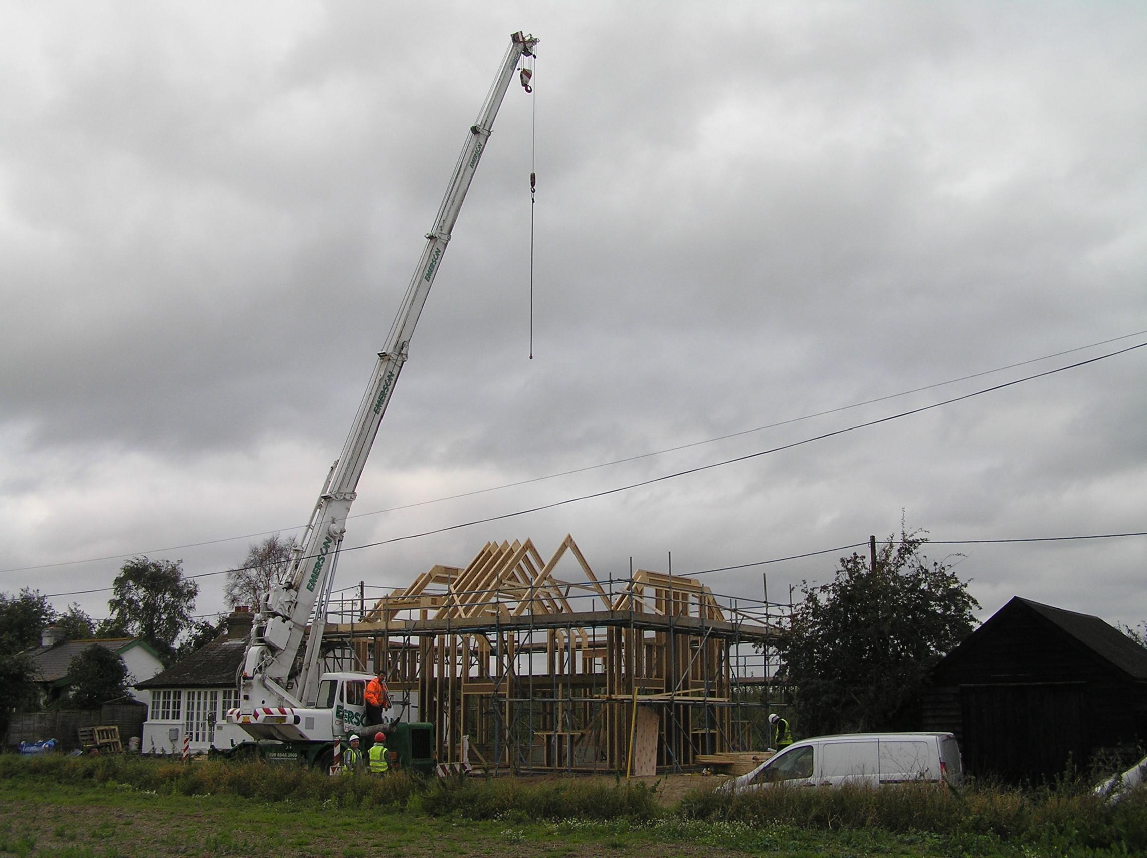

ProDave Posted July 24, 2019 Posted July 24, 2019 That looks like our house build system. Insulated timber frame, racking and air tightness panels on the inside, wood fibre and render cladding. Ours was designed by a local architectural engineer and built by a local firm of builders, and finished mostly by me. 1
Gone West Posted July 24, 2019 Posted July 24, 2019 8 hours ago, K78 said: http://www.phhomes.co.uk/ph15-system/ The ph15 system looks as though it was developed from the construction used for our portal timber I-beam frame erected in 2010. Our house frame was the second of that design built in the country. The frame which consisted of the sole plate, frames, racking and external rafters along with erection was just over £36000. We used Isoquick insulated foundations and Icynene wall and roof insulation along with external Rockwool insulation. 1

K78 Posted July 24, 2019 Author Posted July 24, 2019 I wonder how much it would cost for a timber engineer to design a frame and then source everything yourself? I have been told timberframe construction is easy and enjoyable with half decent joinery skills?
Patrick Posted July 24, 2019 Posted July 24, 2019 51 minutes ago, K78 said: I wonder how much it would cost for a timber engineer to design a frame and then source everything yourself? I have been told timberframe construction is easy and enjoyable with half decent joinery skills? I ve done just that. SE designed the frame. Cost around 800£. I'm not building yet, still stuck in demolition mode. So wouldn't be able to tell on how enjoyable its going to be putting the frame up. I got a company that supplies the timber and they do really bare frame kits a well. (basically just the walls, no roof, no windows, no insulation ), but only as traditional frame, no portal frame. I wanted portal frame and decided to just get materials from them.
