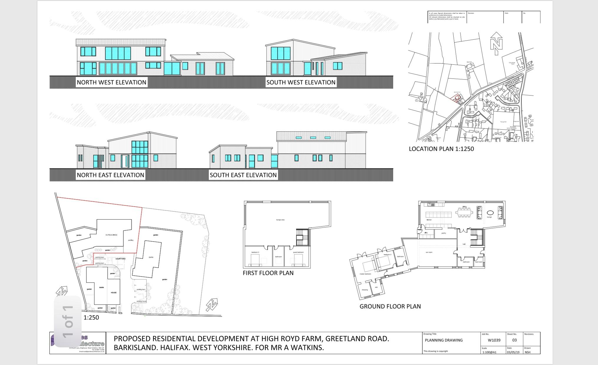

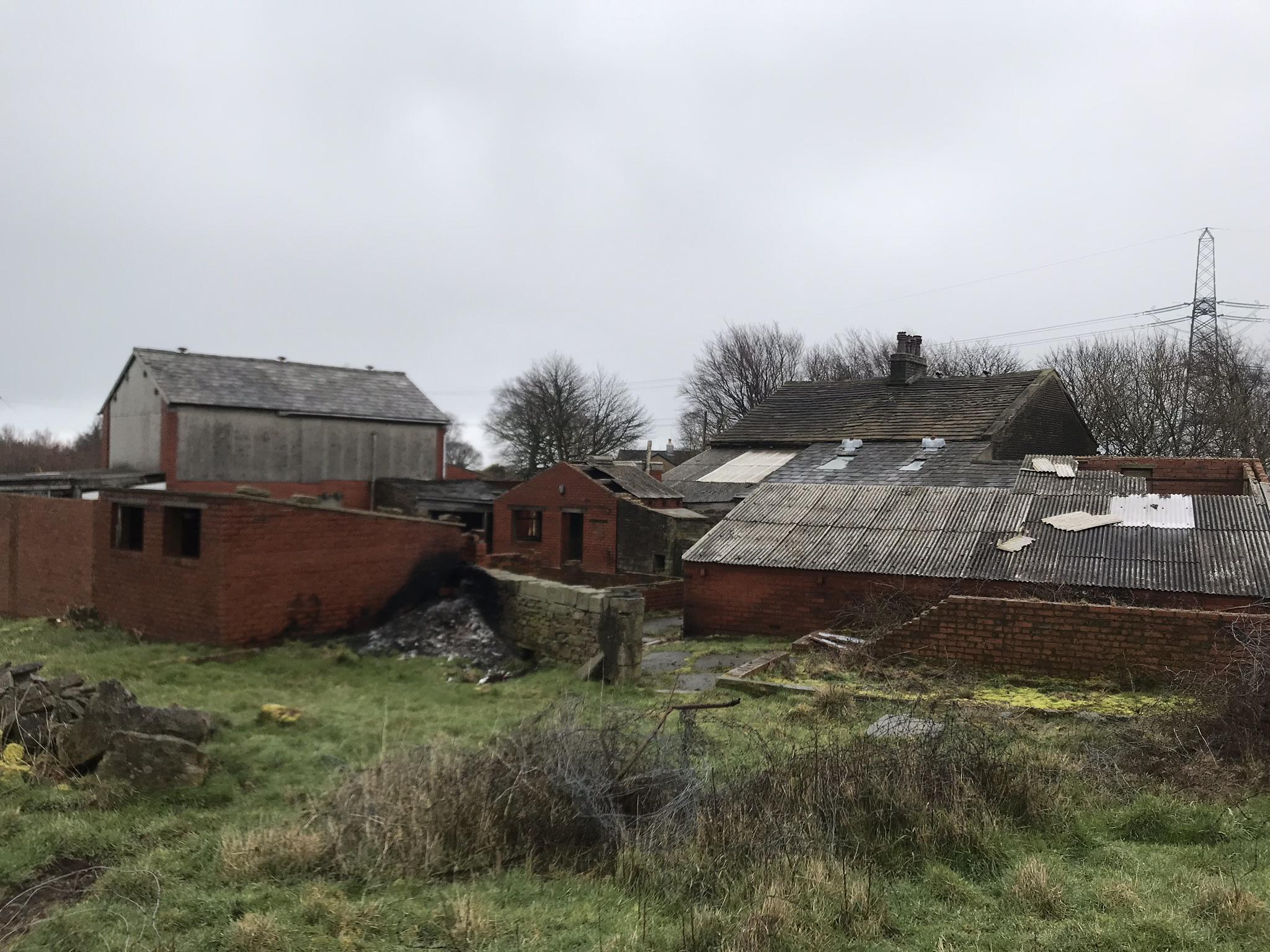

Tonymac01 Posted July 20, 2019 Share Posted July 20, 2019 (edited) Hi all, first post on here. Here’s our project. Just about to embark on our first new build. ?? Looking forward to it all. Bought a plot (ruin) as part of a divided smallholding farm. We have the ‘outbuildings’ our neighbours are in the farmhouse, then there’s the barn. Planning sorted, although we have gone back in with plans for a two storey rather than a single. See pics below. I have questions about building as plans are for not knocking it down and starting again but building on what’s there !! Im going to set up another post for my questions, but will start with this one : I presume the foundations currently there won’t be of a house build standard, how do I start the build without knocking (or looking like) we’re knocking everything down ? Anyway, looks like we have an exciting 12 months ahead of us. Edited July 20, 2019 by Tonymac01 Link to comment Share on other sites More sharing options...

Temp Posted July 20, 2019 Share Posted July 20, 2019 (edited) What exactly does your existing permission say? And what does the new application for a two storey house say you want to do? I disagree with Mike. If you only have permission for a conversion but knock the buildings down the planners may well come back and demand a new planning application. They will point out you have permission for a conversion not a knock down and rebuild. They may grant it or could be mean and say that now the buildings have gone you are trying to get permission for a new house in the country side which is against policy. Its unfair but it has happened before. People have been forced to go to appeal taking time and money. What I would do is check the foundations and if necessary amend your application to a knock down and rebuild. Edited July 20, 2019 by Temp 1 Link to comment Share on other sites More sharing options...

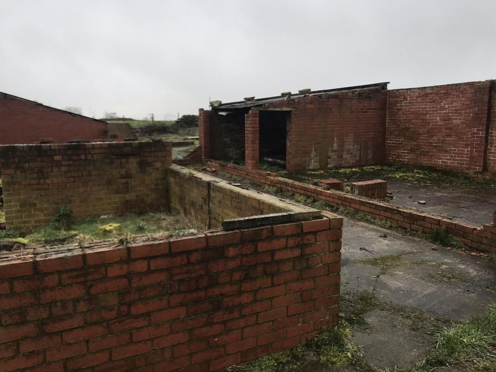

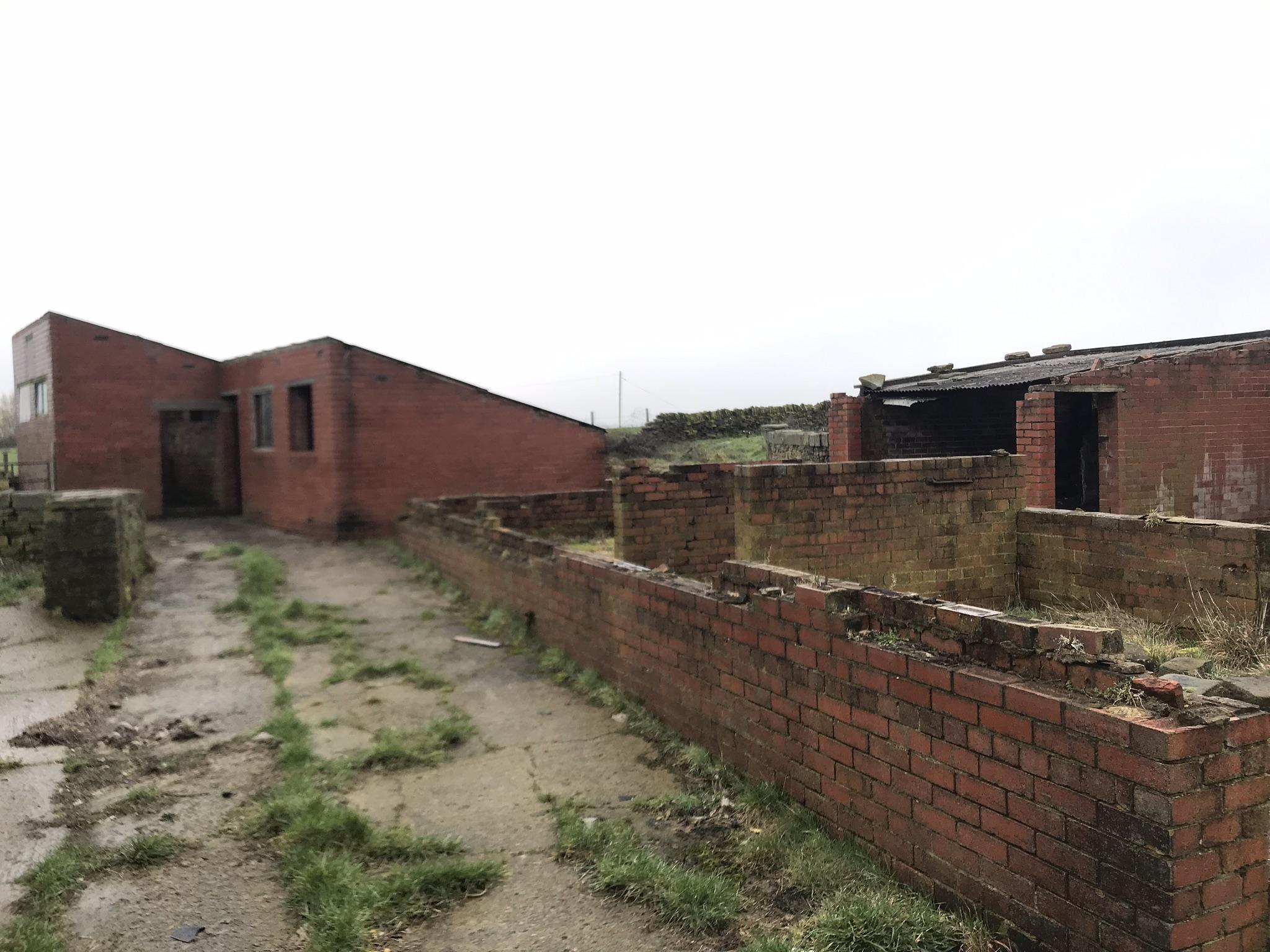

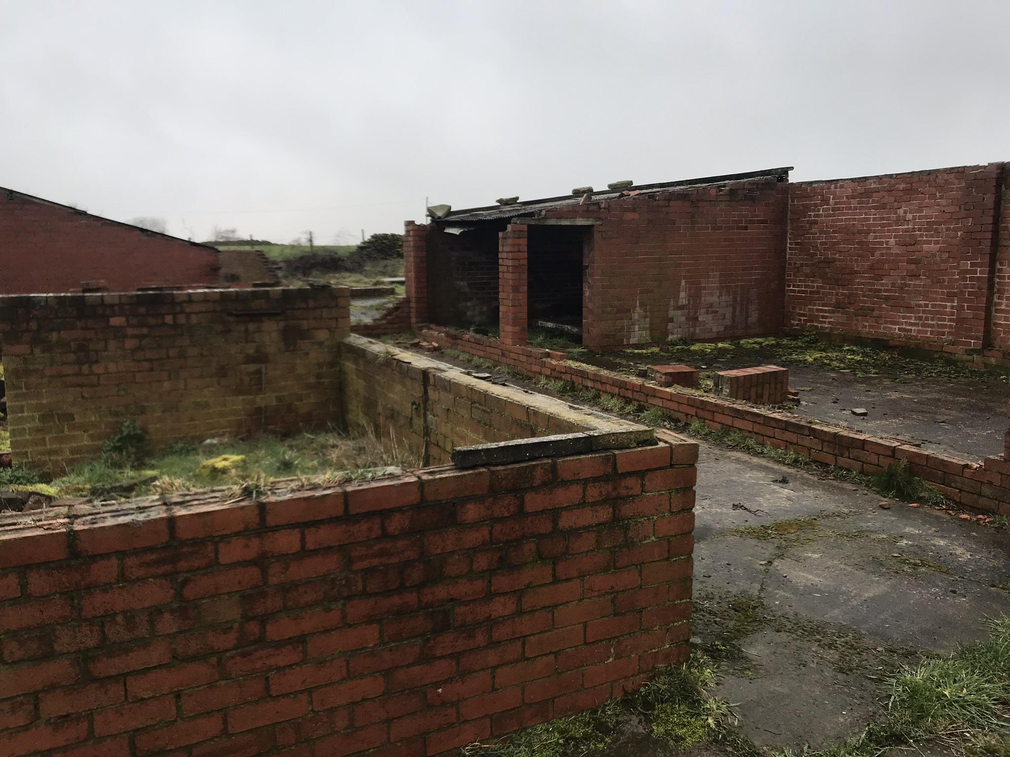

Russell griffiths Posted July 21, 2019 Share Posted July 21, 2019 (edited) I would doubt the foundations will be anything but poor, certainly not good enough for two story, have you got adequate headroom inside, the time you add 225mm in height to the existing. I think i would consider having it all marked marked out by a survey company and then ripp it all down and rebuild on the exact same footprint. I think i would get your new planning through and have and have a good talk with building control. Edited July 21, 2019 by Russell griffiths 1 Link to comment Share on other sites More sharing options...

Tonymac01 Posted July 21, 2019 Author Share Posted July 21, 2019 (edited) Great stuff, it’s not been lived in EVER !! Which isn’t a bad thing. Can i I get back to the foundations ? As it was sheep pens previously, am guessing the foundations won’t be up to the job or standard of house ones. I don’t have time to put planning in again to demolish, plus the planning is for a ‘rebuild’ of what’s there. I would have said it needs a whole new base, in keeping with modern building regs ( the current is rough, different levels, no DPC ) do we repair (replace) one wall at a time ? Or put scaffold up with screens, and knock it down and put a whole new base in ? Thanks Edited July 21, 2019 by Tonymac01 Link to comment Share on other sites More sharing options...
stephen margerison Posted July 28, 2019 Share Posted July 28, 2019 Good Morning, I am doing a similar build, so it looks like the foundations will be very poor. ( And if you get that wrong, you get the whole house wrong !!) I feel you must go back to planning, they can be VERY stubborn if they feel you are running roughshod with them ! a new build 2 storey is not a rebuild. have you spoken to your architect ? I also note you have asbestos on site. This is NOT as big a problem as people make out !!, and unless its Blue asbestos, you can do it your self and save thousands !! my quote was 12-15k rubbish I will do it for circa 2k.If you get foundations right , anything after can be fixed, foundations cannot. ps have you got a demolition licence? regards, Stephen Link to comment Share on other sites More sharing options...
