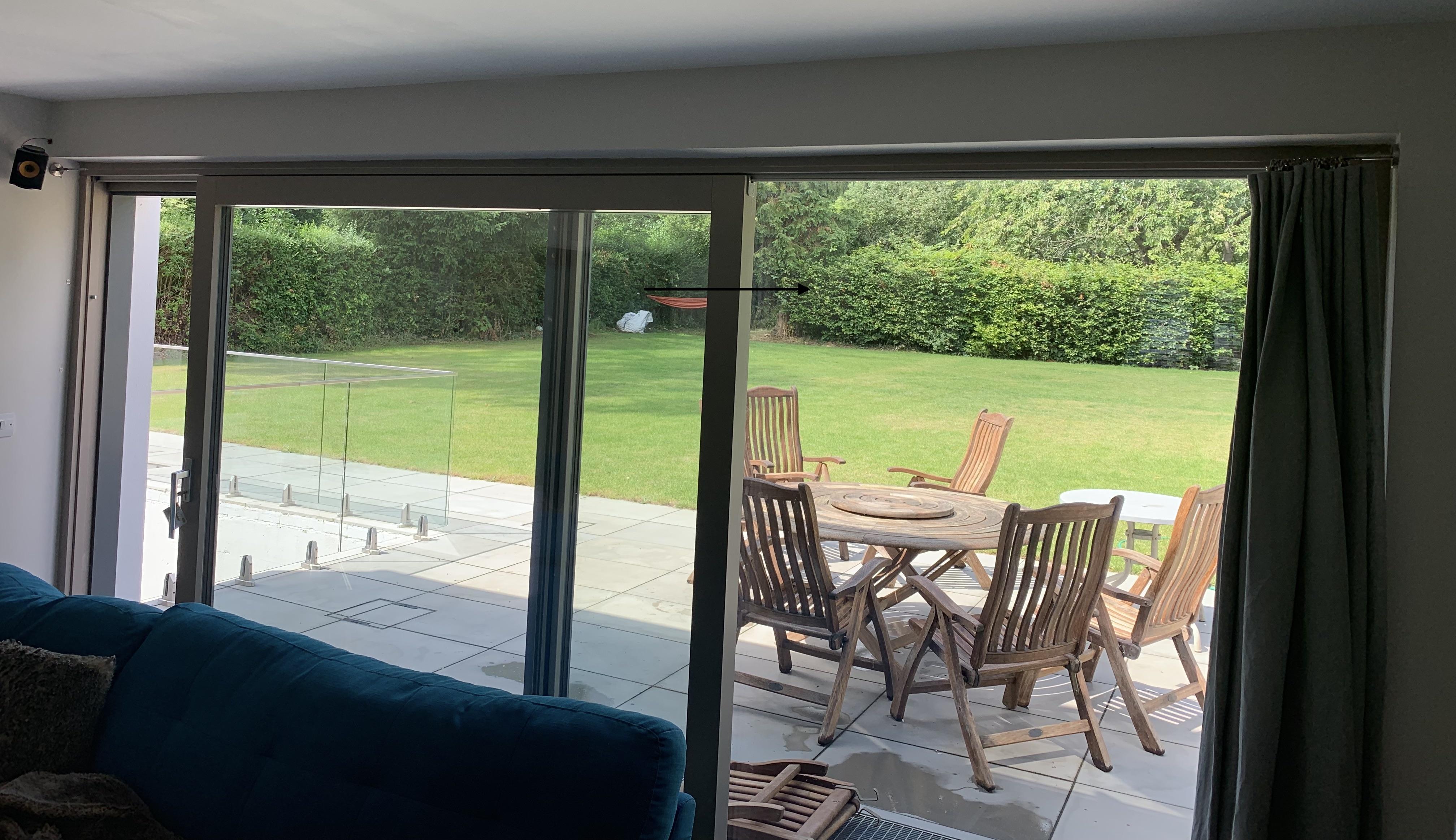

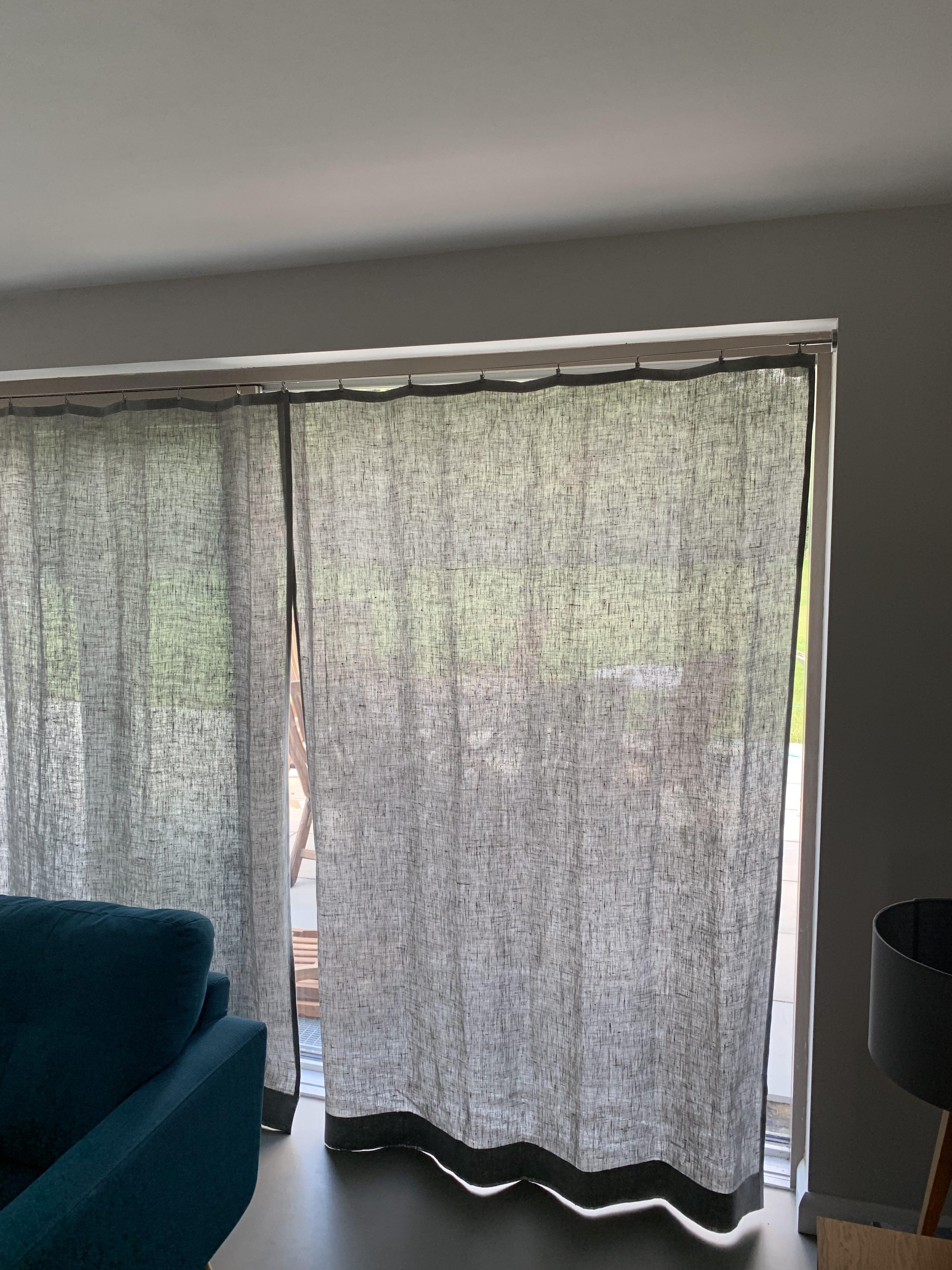

Bitpipe Posted July 20, 2019 Posted July 20, 2019 We have similar at the back of the house, two 4.5 x 2.2m sliders, facing west over garden. At the front of the house we have concealed motorised venetian shutters which are excellent but given they stay down most of the time and we adjust the angle of the slats, not ideal for a door you'd like to walk through now and again! Our only issue is strong sun later in the day for a few hours or so. We looked at internal blinds and curtains, both really expensive and occupy a lot of space when not in use. I went for a tensioned wire spanning each window (Ikea do a 5m one for £10) and Mrs B. bought lengths of grey linen type voile (also from Ikea £8/m) and cut & hemmed it into individual panels, about 1.5m wide. These attach to the wire using a simple peg & loop fitting (yes, also from Ikea) and when the sun is out we pull them into position for shade but they're easily hidden to the side when not in use and as they're pretty thin they take up next to no space. Because they're so light they only deflect the wire by 1cm in the centre - I may put a hook up there if I can be bothered (you'd probably need to given the greater span). Nice also in winter to make the space feel a bit more cosy. Net total cost about £60-70. 1
Triggaaar Posted July 20, 2019 Author Posted July 20, 2019 9 minutes ago, Bitpipe said: We have similar at the back of the house, two 4.5 x 2.2m sliders, facing west over garden. At the front of the house we have concealed motorised venetian shutters which are excellent but given they stay down most of the time and we adjust the angle of the slats, not ideal for a door you'd like to walk through now and again! Our only issue is strong sun later in the day for a few hours or so. We looked at internal blinds and curtains, both really expensive and occupy a lot of space when not in use. I went for a tensioned wire spanning each window (Ikea do a 5m one for £10) and Mrs B. bought lengths of grey linen type voile (also from Ikea £8/m) and cut & hemmed it into individual panels, about 1.5m wide. These attach to the wire using a simple peg & loop fitting (yes, also from Ikea) and when the sun is out we pull them into position for shade but they're easily hidden to the side when not in use and as they're pretty thin they take up next to no space. Because they're so light they only deflect the wire by 1cm in the centre - I may put a hook up there if I can be bothered (you'd probably need to given the greater span). Nice also in winter to make the space feel a bit more cosy. Net total cost about £60-70. Thank you for the reply. We have Venetian blinds at the front of the house. They let light in, but offer privacy. A much better alternative to net curtains IMO. We certainly don't want anything like that at the back though. We want to enjoy the view and let in lots of light. I don't think the wire option would work for us, as the span is longer, but it sounds very similar to having a flush curtain rail in the ceiling. Your grey voile panels are about 1.5m wide each - how many of them do you have, and how much space do they take up when pushed to the side?

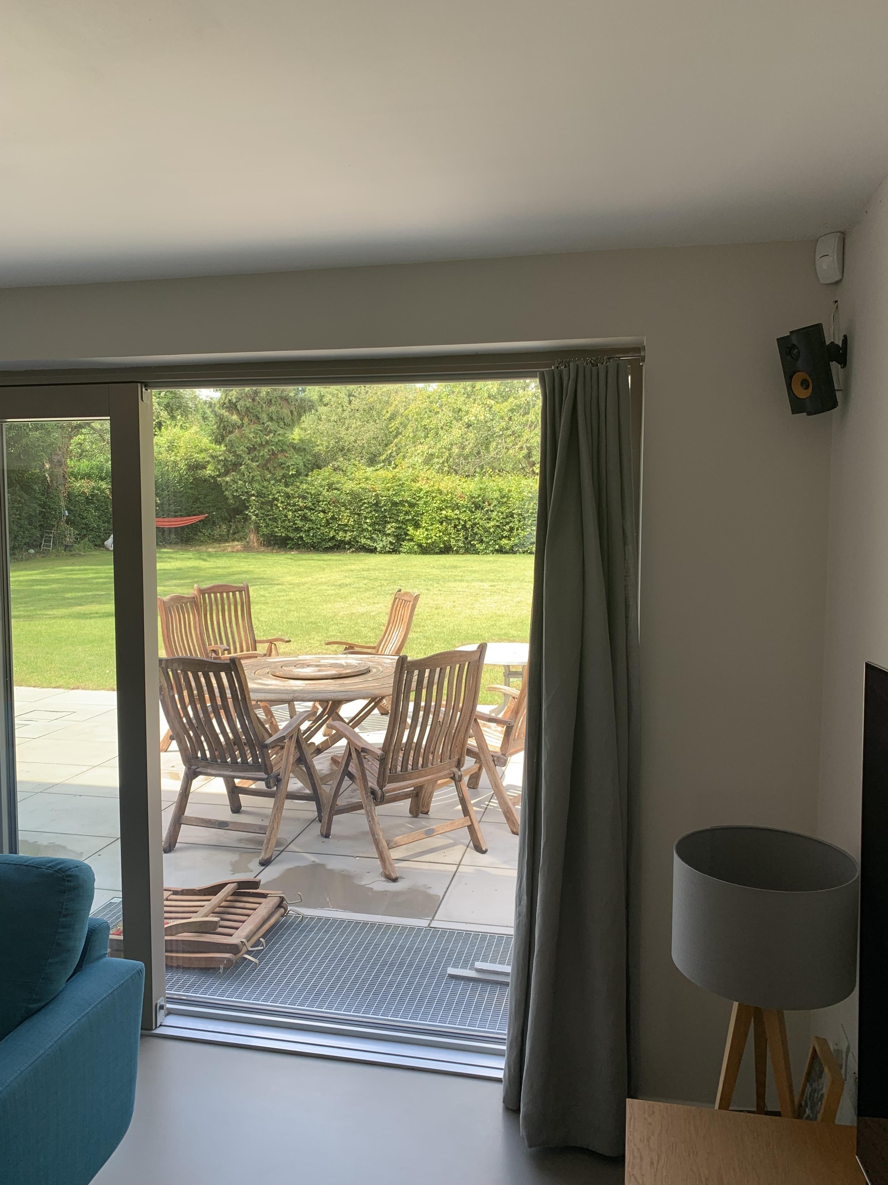

Triggaaar Posted July 20, 2019 Author Posted July 20, 2019 3 minutes ago, Bitpipe said: We have 3 per window. As the wire runs inside the reveal, space is limited but you could run it above and extend a bit further either side. Thanks for the photos, really helpful! If we went for a thin curtain like that, I think I'd want the flush curtain rail, rather than a cable. We could put it in front of the doors, which would give 25cm of space either side (total room width 7.5m).
Bitpipe Posted July 20, 2019 Posted July 20, 2019 Just now, Triggaaar said: Thanks for the photos, really helpful! If we went for a thin curtain like that, I think I'd want the flush curtain rail, rather than a cable. We could put it in front of the doors, which would give 25cm of space either side (total room width 7.5m). It's really more of a voile than a curtain and being individual panels vs a continuous length means it's a bit more flexible to deploy but as it was a complete afterthought it was the only option that worked with minimal disruption. As it is, it looks vaguely contemporary and was cheap as chips so I'm pretty happy with it. Surprisingly effective at minimising solar gain as well. Flush rail would be a good option, gives you options to have a pull cord to move it around too.

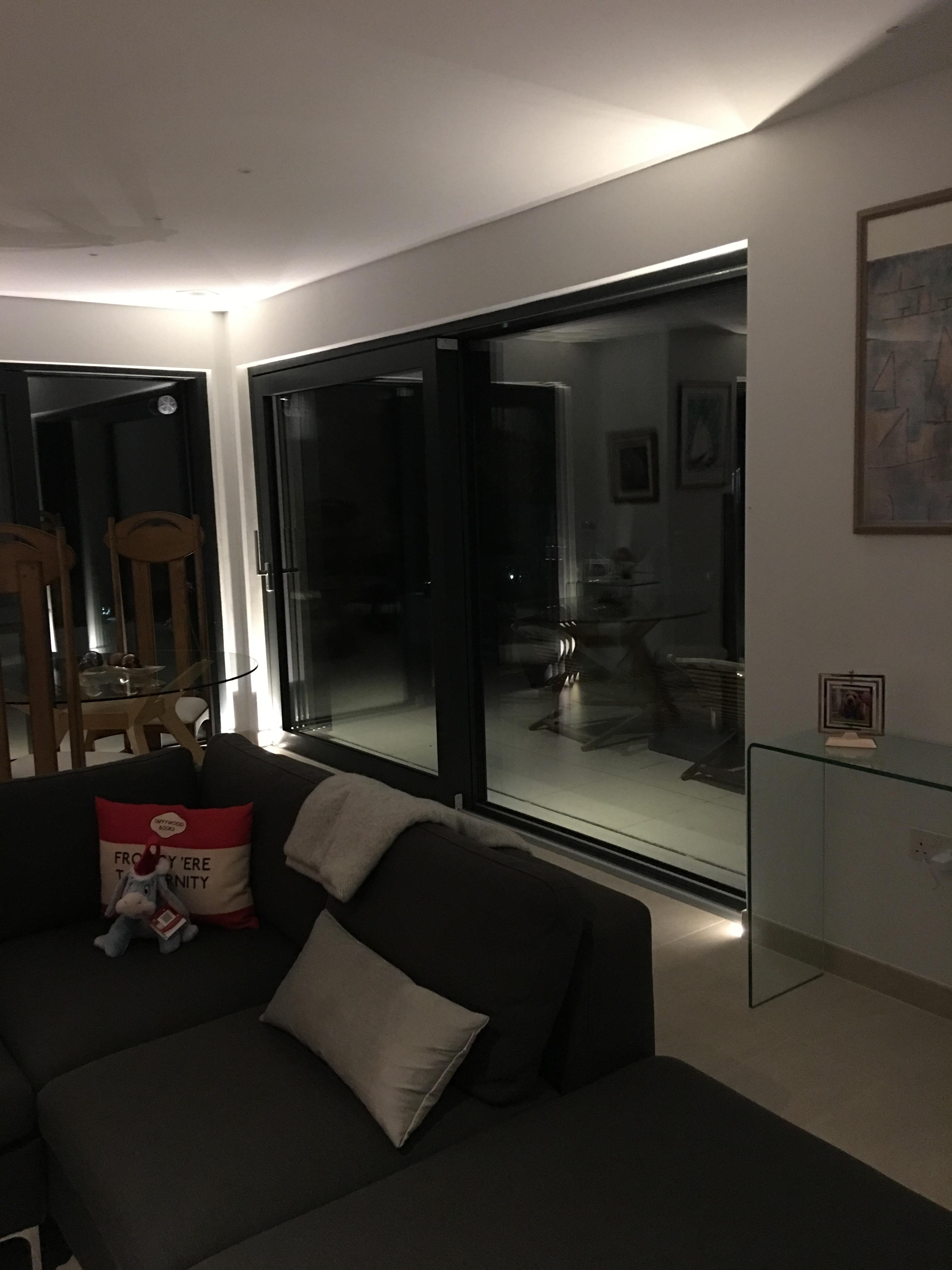

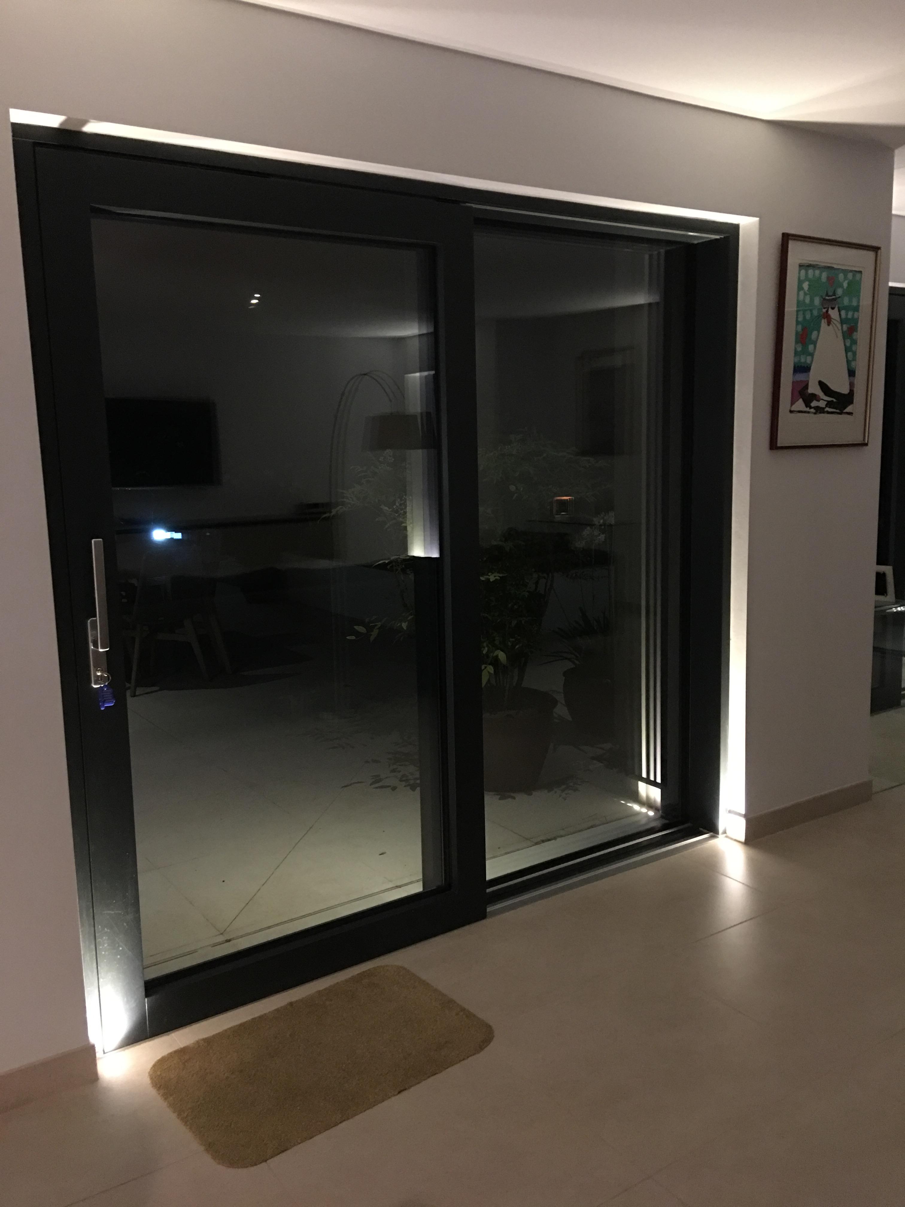

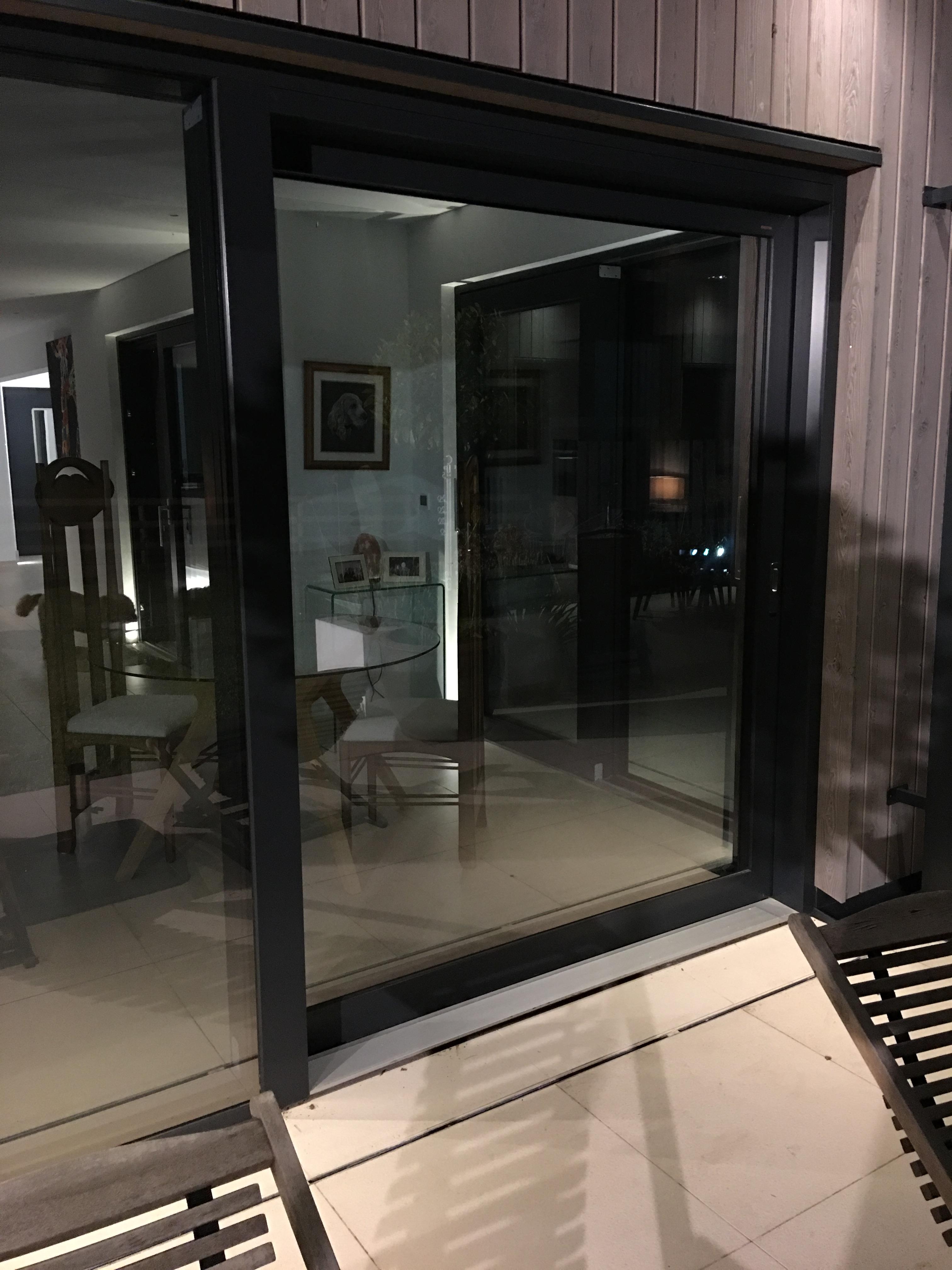

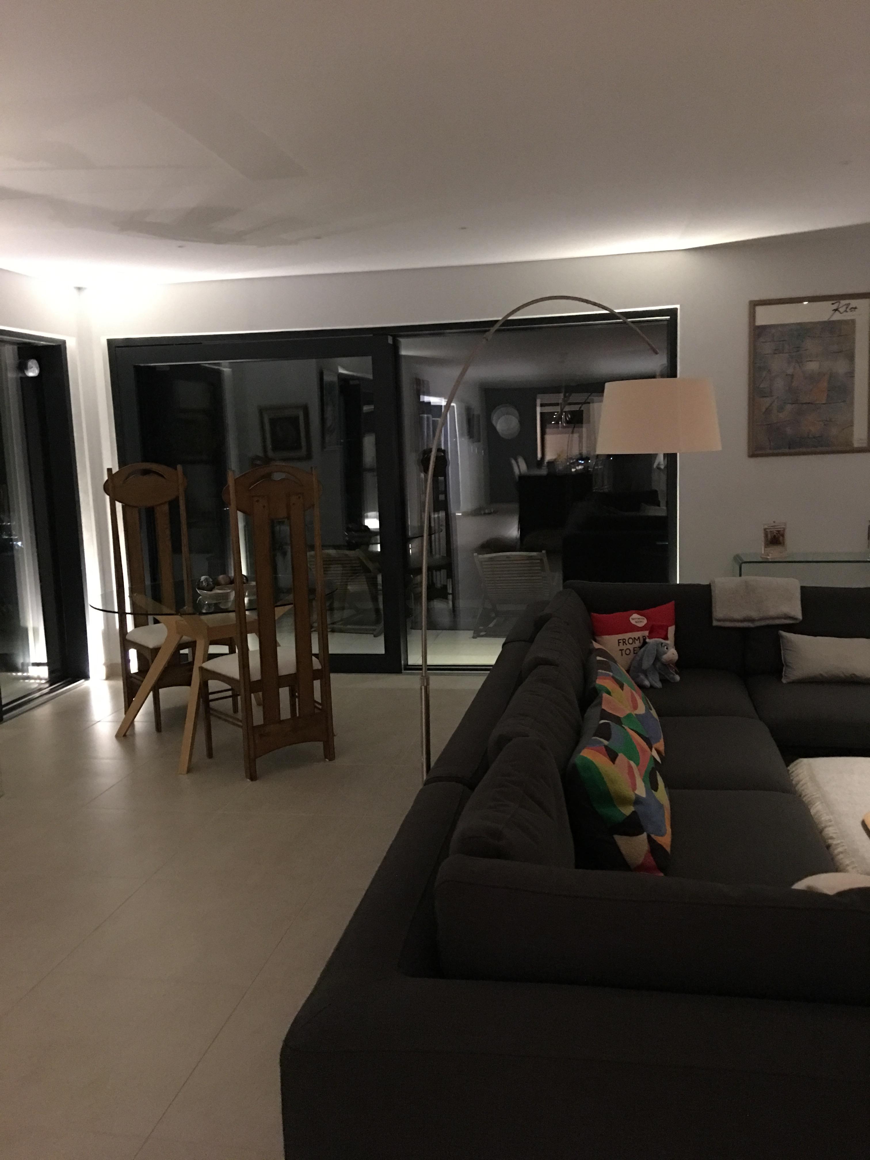

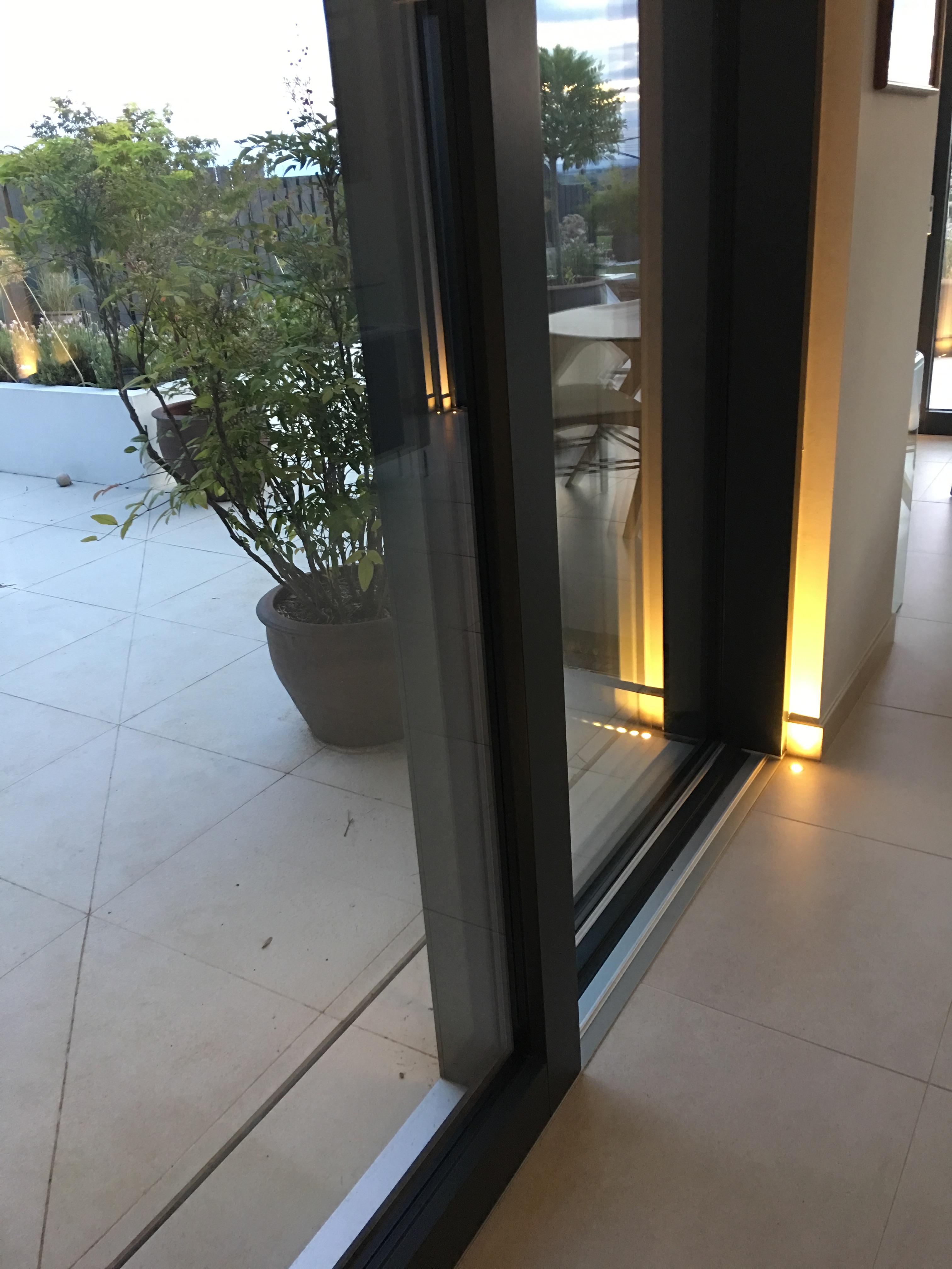

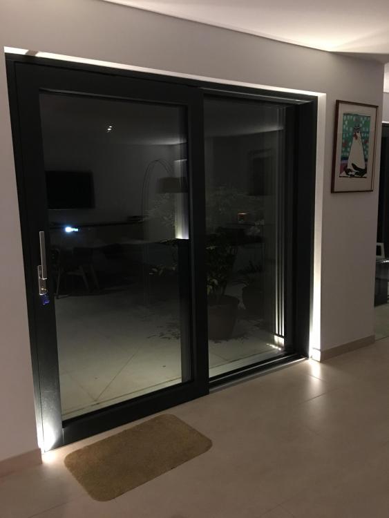

lizzie Posted July 21, 2019 Posted July 21, 2019 I am not a good photographer so bear with me on photo quality, I probably could have done better with the refelections. This is my inside uplighting at the sliders. I have a tiny little led spot set into the floor at each end of the opening. Outside I have the same tiny little led spots in the soffit. It is very effective just wish I could have go a better pic! 1

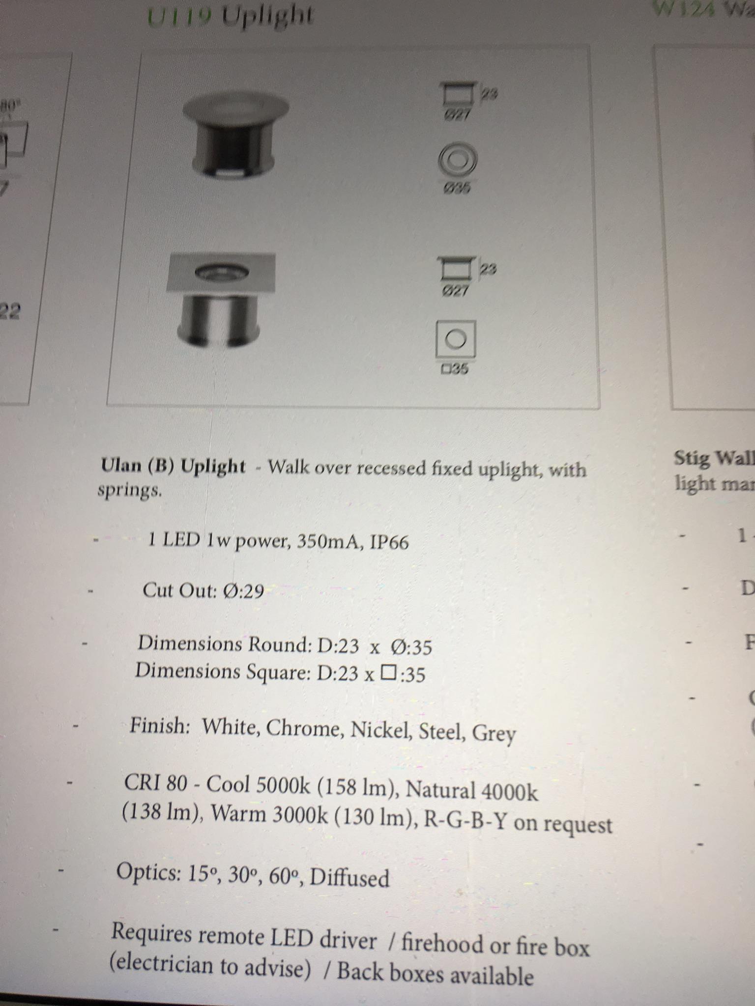

Triggaaar Posted July 21, 2019 Author Posted July 21, 2019 3 hours ago, lizzie said: I am not a good photographer so bear with me on photo quality, I probably could have done better with the refelections. This is my inside uplighting at the sliders. I have a tiny little led spot set into the floor at each end of the opening. Outside I have the same tiny little led spots in the soffit. It is very effective just wish I could have go a better pic! Thank you so much for doing those, much appreciated. Any idea what model the lights are, or what wattage they are etc? Thanks
lizzie Posted July 21, 2019 Posted July 21, 2019 (edited) 1 hour ago, Triggaaar said: Thank you so much for doing those, much appreciated. Any idea what model the lights are, or what wattage they are etc? Thanks This is the spec...no back boxes for internal ones (we have external ones too lighting a wall and that is why ref to backboxes). All that is needed for internals is a duct through slab/screed depending on what you have. I have passive slab no screed floor build up so my ducts are in the slab. (external soffit lights are just downlight version of these) They are dimmable too which is nice. Got ours with all the other lightmaster stuff not sure if they do retail but should be easy enough to find same spec online Edited July 21, 2019 by lizzie 1
