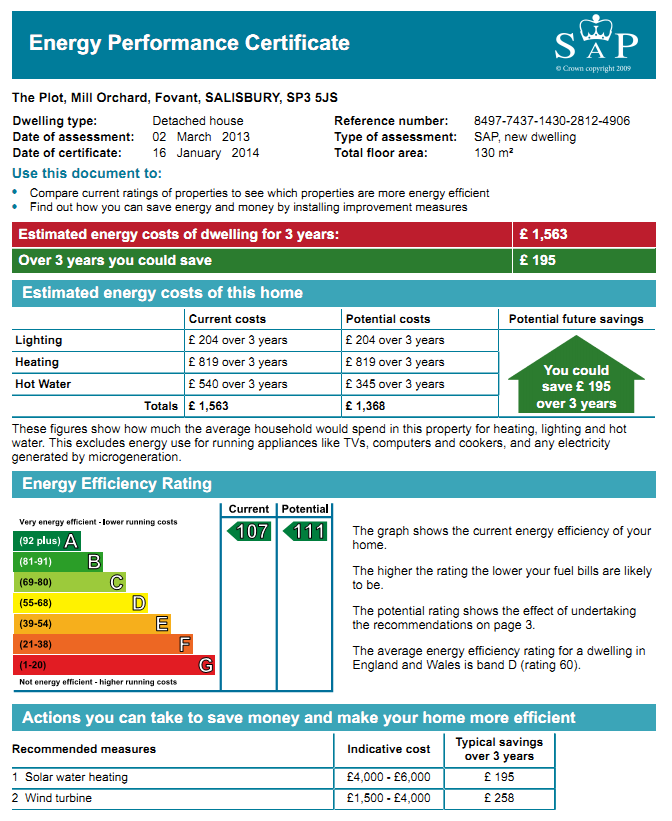

dnoble Posted July 19, 2019 Author Share Posted July 19, 2019 (edited) I have had one done now (about £130, online, sent them loads of specs, u-values etc, you need an SAP and an EPC for a new build it turns out) I turns out the form doesn't recognise the concept of a passive house and you can;'t enter "nothing" in the space heating section. He advised I say have electric panel heaters. The final cert also says there's a "space heating requirement" of >2000kWh/year. It might be OK to use this jut to get building regs signed of, but it rankles a bit that it's so inaccurate. I have queried it with the provider. Any other passive house owners encountered this? Edited July 19, 2019 by dnoble addn info Link to comment Share on other sites More sharing options...
Jeremy Harris Posted July 19, 2019 Share Posted July 19, 2019 (edited) 31 minutes ago, dnoble said: I have had one done now (about £130, online, sent them loads of specs, u-values etc, you need an SAP and an EPC for a new build it turns out) I turns out the form doesn't recognise the concept of a passive house and you can;'t enter "nothing" in the space heating section. He advised I say have electric panel heaters. The final cert also says there's a "space heating requirement" of >2000kWh/year. It might be OK to use this jut to get building regs signed of, but it rankles a bit that it's so inaccurate. I have queried it with the provider. Any other passive house owners encountered this? Inaccurate doesn't begin to sum up the EPC for our house. The thing's a joke, really, when applied to a passive house. I particularly like the automatic observations that get inserted on the EPC, for recommended improvements. This is the front of ours: Note the "Recommended measures" at the bottom. We already have solar water heating via PV, but SAP doesn't take account of this for some bizarre reason. The suggestion to install solar water heating, at an indicative cost of £4,000 to £6,000, with a typical saving over 3 years of £195 is completely bonkers. The payback time would be between 61.5 and 92.3 years, assuming we scrapped the PV water heating we already have. Our house is alongside a stream at the bottom of a steep sided valley, and very sheltered from the wind and weather. It's also inside an AONB and Conservation Area, and opposite a GII listed building, so there's no way a wind turbine would work, let alone get planning consent. Edited July 19, 2019 by JSHarris Added copy of EPC Link to comment Share on other sites More sharing options...
lizzie Posted July 19, 2019 Share Posted July 19, 2019 @dnobleIts so infuriating isnt it...what was your rating? I was mightily upset to get a B and be told without PV an A was nigh on impossible. Link to comment Share on other sites More sharing options...
dnoble Posted July 19, 2019 Author Share Posted July 19, 2019 Agree, it's nonsense Mine also advised solar water heating, though I have this via a sunamp + PV's, again "does not compute" Link to comment Share on other sites More sharing options...
Hobbiniho Posted July 20, 2019 Share Posted July 20, 2019 i am particularly intrigued as to how they think you can get a wind turbine for £1500 , on my EPC it shows the indicative cost of a wind turbine as 15-25k which is more realistic if a bit low, but it doesnt factor into account the large amount of land that you need to site the thing in the first place Link to comment Share on other sites More sharing options...
