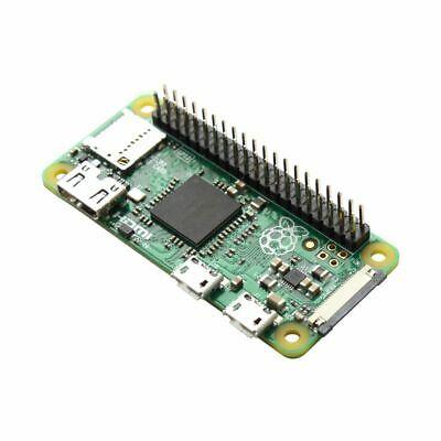

Just got a Zero 1.3 recently but with the soldered header:

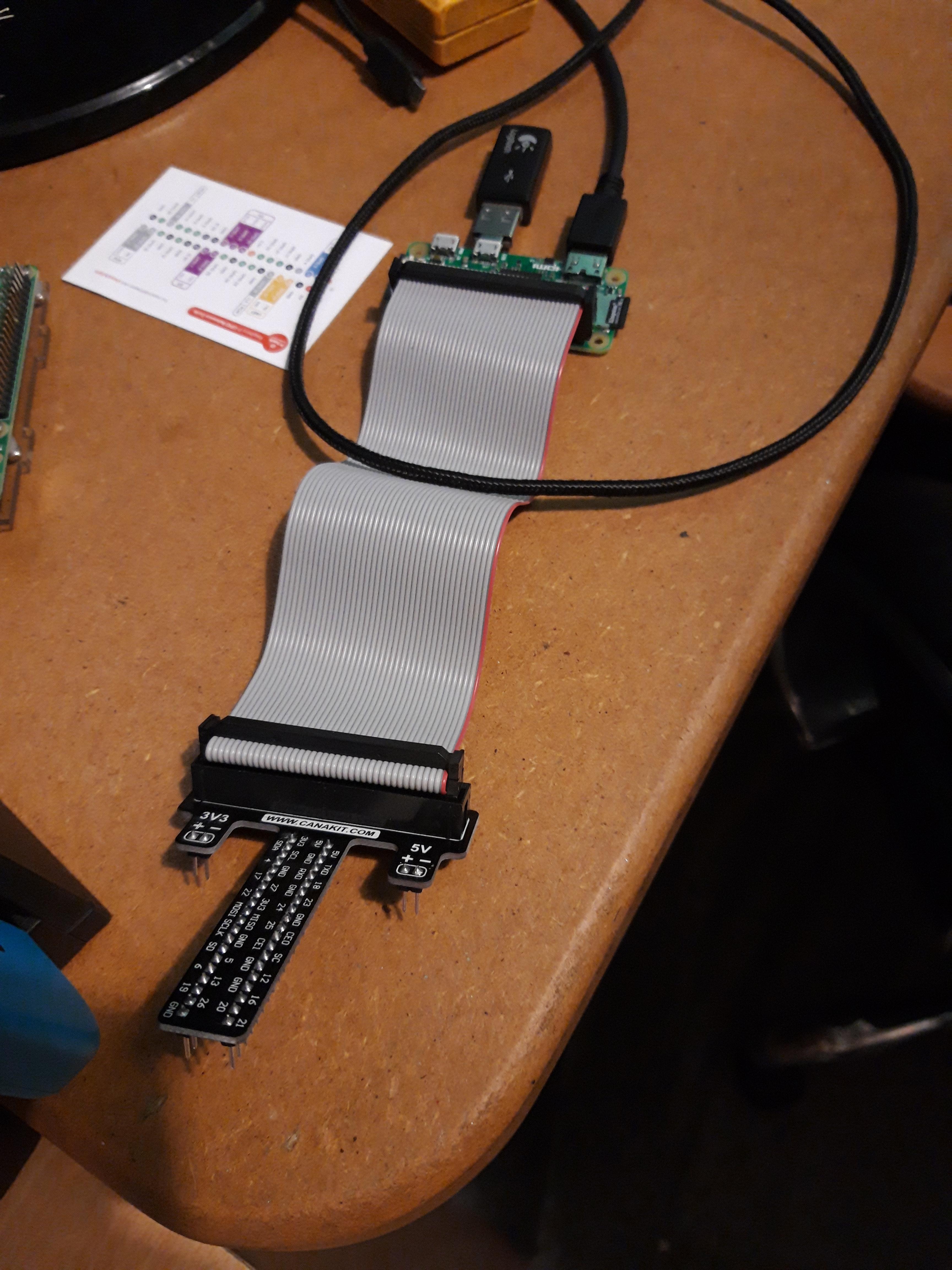

Along with a breakout board:
The boy is FINALLY getting down to doing my mates "Knight Rider" lights with ultra bright LEDs inset into his block paving under the sliding gate.
I can cope all day long with the hardware side but the Python is beyond me. Suppose I should learn...
