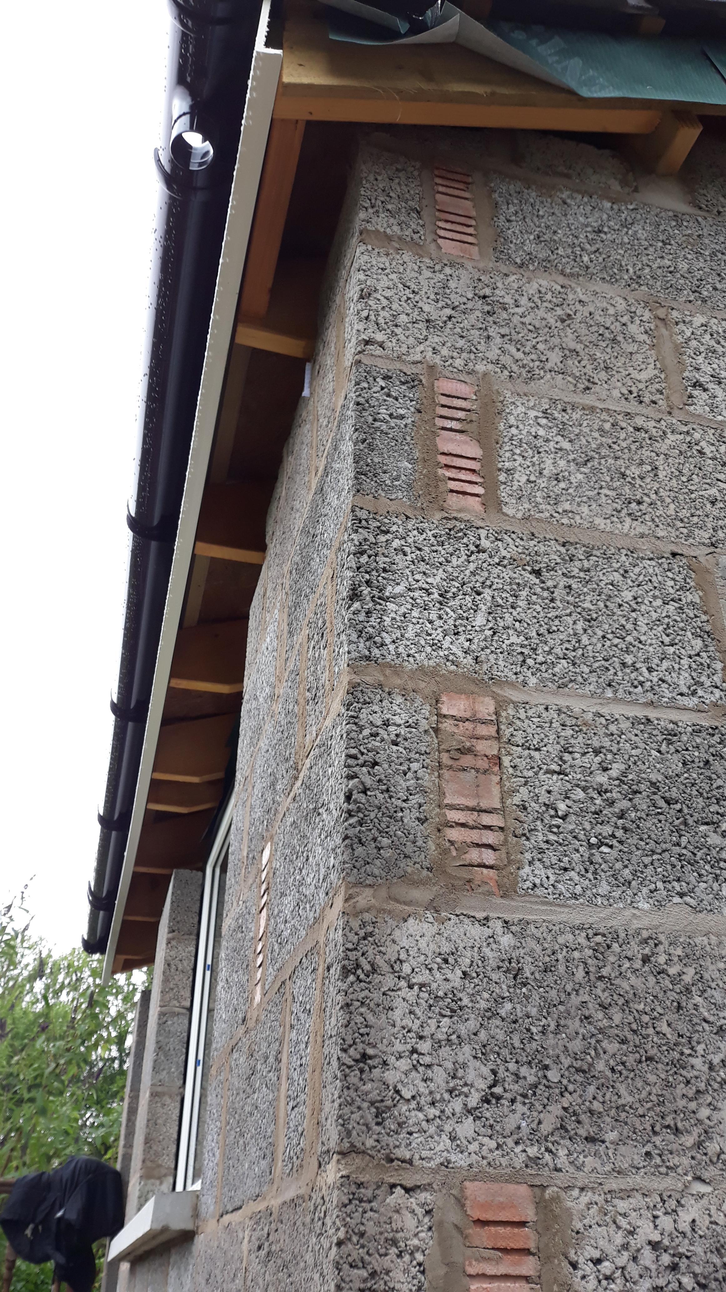

epsilonGreedy Posted July 10, 2019 Share Posted July 10, 2019 With standard stretcher bond corners there is a need for a 100mm wide block and I am getting fed up with the dust, noise and delay of cutting a few of these each course. As this must be such a common occurrence across the country I have begun wondering if there is a special block made measuring say 90 x 215 x 100. Link to comment Share on other sites More sharing options...

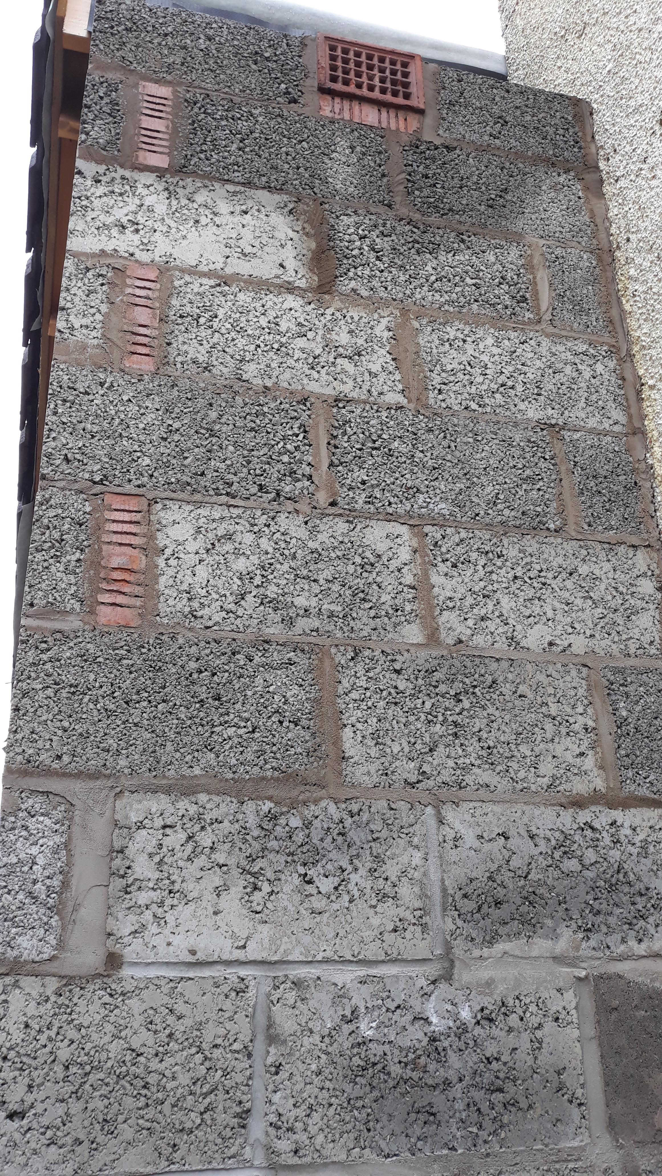

bassanclan Posted July 10, 2019 Share Posted July 10, 2019 Mixing bricks and running out of course is not ideal in your pic Link to comment Share on other sites More sharing options...

Carrerahill Posted July 10, 2019 Share Posted July 10, 2019 1 minute ago, Brickie said: Wouldn’t get away with that on a big site-mixing materials with different Newton’s plus different rates of expansion for the render. Whdre possible,I bond my corners block to block I.e. lose the 100mm piece. For course 2,I cut a 330mm block to give half bond one way,& use the 110mm offcut the other way to give half bond both directions. If not fair faced,you can just judge the 110mm by using your 100mm bolster 10mm in from the end of the block. Saves you getting your tape out constantly & 4 cuts gives your 8 courses worth. It is common to mix commons and block to make up lintel heights and sills etc. Yes, brickettes (coursing bricks) should be used but many merchants don't have any so for the sake of 10-20 bricks a common is used. The CTE (although without figures it may be a null point) may slightly differ between clay commons and concrete block in practise it is not going to make a blind bit of different and as I say is done all the time. The actual reason you are not supposed to do it is not because of different CTE but because of cold spots and that is why the NHBC would not accept it - however, in plenty of circumstances it would not be an issue to have this cold spot and therefore it is perfectly acceptable practise - as for the load bearing capacity of the block and brick, the blocks were 7N and the bricks I bought were 25N/mm² so the bricks although on end can actually bear more load than the block. For the OP building a garage, a common on end will be fine and I have never seen render fail due to mixed commons and block. Link to comment Share on other sites More sharing options...
Carrerahill Posted July 10, 2019 Share Posted July 10, 2019 44 minutes ago, bassanclan said: Mixing bricks and running out of course is not ideal in your pic No, it is not "ideal" but there is no serious or even intermediate concern with this in this circumstance - see my post just above to Brickie. In the end it will never compromise the build or give issue. In the first image, if you look closely the bottom two courses are out in relation to the rest which was my fault, I had to get those courses up for various reasons so I built them myself - when my bricklayer came to build the rest he set the coursing up properly to suit the walls he was about to build thus creating the difference between the bottom 2 and top. Throughout the rest the other 450 odd blocks coursing is bang on. Link to comment Share on other sites More sharing options...
