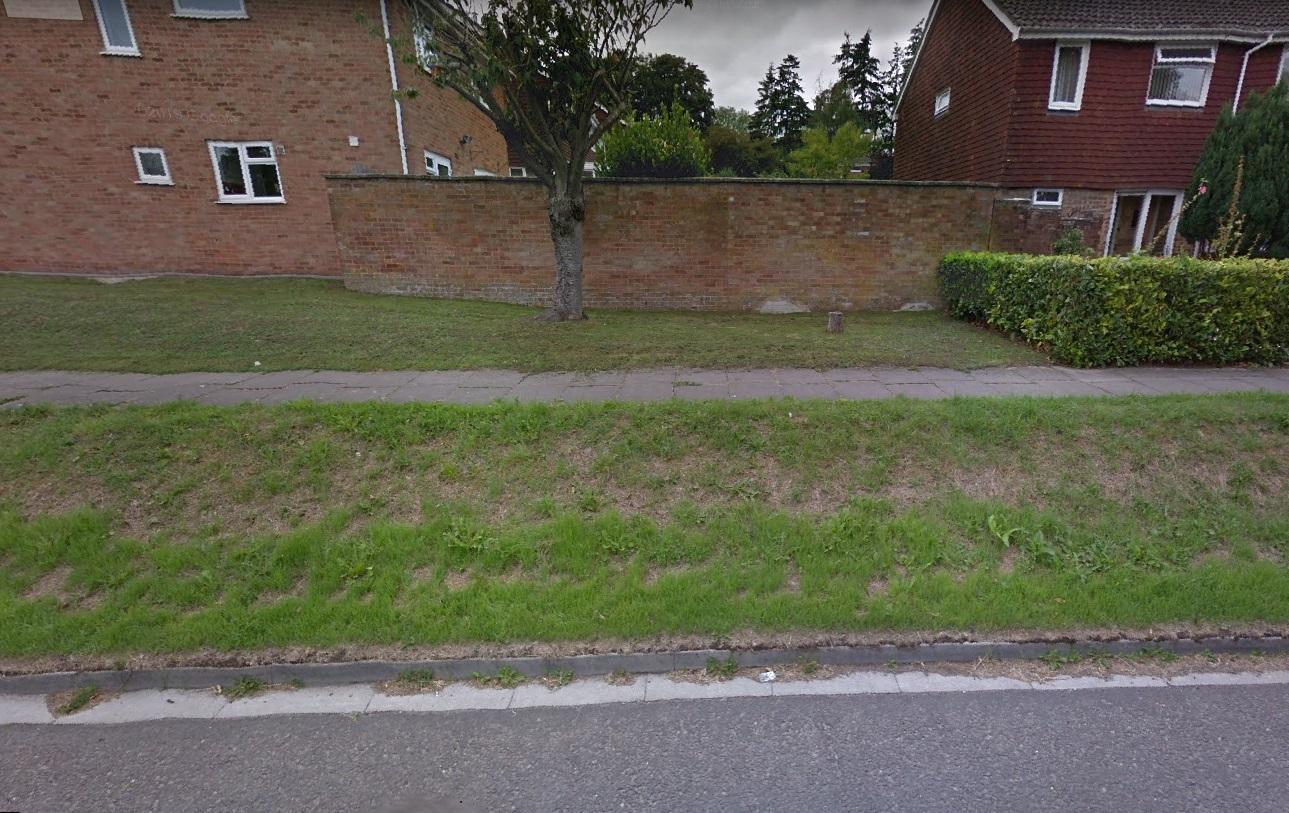

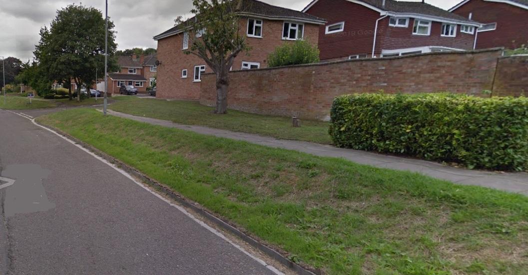

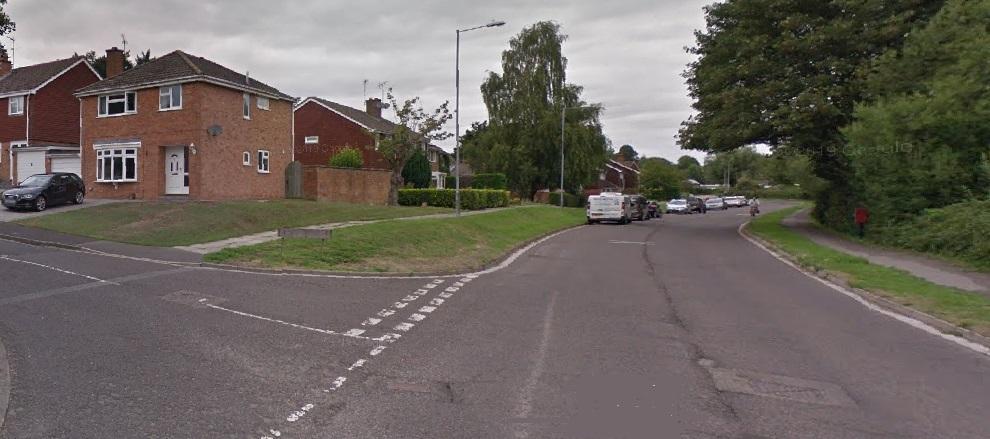

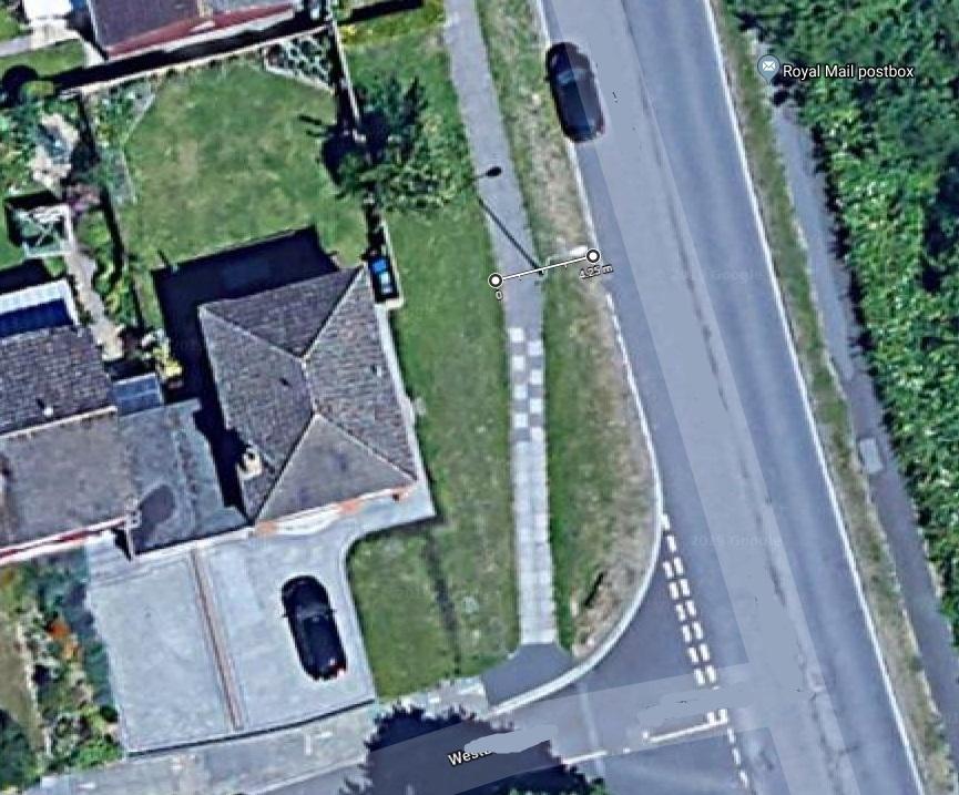

Bob Loblaw Posted July 5, 2019 Posted July 5, 2019 I've read a lot of good information on here so thought I'd take the plunge and get collective thoughts on our project as this is the first time I've dealt with any renovations. We would like to replace a wall with a fence to our boundary (at the 2m height limit) by the side of the house however we do have a path next to the boundary which then goes to a 2m emabankment which is 1m high and then the road. The road is 4.25m from the boundary. We've read the permitted planning rules and know the rule " If the fence would be over 1 metre high and next to a highway used by vehicles (or the footpath of such a highway)". My question is will I be in limits of the permitted planning rules regarding adjacency i.e is the footpath still considered part of the road even though its at quite a bit highr elevation and 2m away from the physical road? We'll go to planning to check but would like ideas from those with much greater experience than ourselves. Please see pictures attached to hopfeully add clarity to our situation (The wall as shown on the side would come down and replaced with a fence / gambions to the boundary at the same length. Many thanks in advance Bob
ProDave Posted July 5, 2019 Posted July 5, 2019 Very grey area. In the old days you would definitely have needed PP when the definition used to be "between the building line and the highway" Now it just mentions "adjacent" to the highway, but the "highway" includes the footpath. So if you build it right next to the footpath, you would need pp. Someone posted a similar case where it went to court and the ruling was when stood on the path, he could not touch the fence so it was rules as not being "adjacent" to the highway. You could always do as your neighbour and plant a hedge. I have a BIL in a similar sited house and he now has a mature Beech hedge all around his garden including around the side and around the entire front garden, and it has made a massive difference to the feel and usability of what was a tiny enclosed garden before.
Ferdinand Posted July 5, 2019 Posted July 5, 2019 (edited) Notwithstanding aesthetic considerations, I do not think I see huge problems with REPLACING that from a Planning or PD point of view, because you already have the right to have a 6ft boundary there. Though you may need to apply, and council planners can bring in all sorts of things if they choose. I can perhaps see complications is the brick wall was part of the ‘look and feel’ of the overall development eg if it was in the master plan. It may also be a brick wall to block out road noise, as a wall will be better than a fence. So you potentially risk making your garden more noisy. The distance from boundary etc concerns you have should not apply as it is a boundary wall not a house wall, and public land the other side. they mainly relate to security and safety of a private human neighbour. Further, you would need to consider the mechanics and access to build it eg safety barriers on council land. There may be an opportunity to explore arguing that it is not subject to planning by knocking say 2/3 off and putting part fence panels between pillars. In any case, I wOuld try an informal conversation with the Council planners aboUt this. It is a BFO brick wall on a biggish thoroughfare, so they will find out about it anyway. Just phone up and ask for the duty planner. (Personally I like walls or hedges, but I have avoided that as it was not your question). Ferdinand Edited July 5, 2019 by Ferdinand
Temp Posted July 5, 2019 Posted July 5, 2019 (edited) I don't believe you need planning permission to replace a wall with a fence that is the same height and in the same position (unless there is an article 4 direction for the area or a planning condition). If it's going to be nearer the road then I think very likely you would need planning permission if over 1m. PS: I don't think the physical layout of the road and path makes any real difference. The highway probably extends right up to your property boundary anyway. They could in theory widen the road and move the footpath nearer. I have a wide grass verge in front of my house and a footpath that crosses the road and verge it at 90 degrees. Apparently the route of the footpath across the verge "isn't defined" because the whole verge is part of the highway so people can in theory walk, drive or park anywhere on it. Edited July 5, 2019 by Temp
Bob Loblaw Posted July 5, 2019 Author Posted July 5, 2019 Many thanks for the responses so far and apologies if I wasnt clear in my first post, the land by the pavement (where the tree is) is ours and we'd like to take down the wall and effectively remove/replace it with another fence/wall alongside the path effictively increasing the back garden size to the boudndary.
Moonshine Posted July 5, 2019 Posted July 5, 2019 50 minutes ago, Bob Loblaw said: we'd like to take down the wall and effectively remove/replace it with another fence/wall alongside the path effectively increasing the back garden size to the boundary. It wasn't clear (to me anyway), but i think that you are going to have to apply for planning, rather than permitted development. Even then, it if a planning application i doubt that you would be able to permission, as based on the street images the existing wall ties in with the existing front facades of the houses to the rear, and the side of your own house. I think that you will have a job on your hands to convince the planners to deviate from this line, though worth contacting them and seeing what their thoughts are.
Ferdinand Posted July 5, 2019 Posted July 5, 2019 (edited) You will need to talk to Highways which could be either County if it is a classified road, or perhaps Local if not, to find out whether that bit of land is designated for widening the junction or the road etc. An application would find that out but it may be useful to know first. Have the material ready to hand ie pic with line where you want your wall, and hopefully you can email it whilst on the phone and they would give enough of a comment for you on the spot. Also potentially there could be services underneath it. Ferdinand Edited July 5, 2019 by Ferdinand

ProDave Posted July 5, 2019 Posted July 5, 2019 Small point. Looking at your rear boundary (wall) it appears the hedge alongside your neighbours front garden is already on your land? If so instruct him to stop trimming that bit and you will take over that duty, and of course allow it to grow taller. then you just have the hedge along the road to plant and grow then.

Bob Loblaw Posted July 8, 2019 Author Posted July 8, 2019 Many thanks for all the advice, we've gone for a pre-planning application to see that art of the possible and get an idea of what they deem to be "adjacent" is if we can't have a fence at the boundary. @ProDave yes the hedge is on our land and that might be a good point with respect to letting it grow if all else fails although we really don't want to go down the hedge route if possibly as I'm inherintly lazy ...many thanks all, now for the waiting game, I'll let you know the outcome if it's of any interest.

Temp Posted February 13, 2022 Posted February 13, 2022 Welcome to the forum 4 hours ago, Alex Kozlowski said: Hi I'm interested how did your planning application go? Did you get it approved in the end? It would be very helpful to all the others going full PP way. We've recently bought a house and we've got pretty much the same problem as you've had. Corner plot with a bit of land outside of already fenced garden touching a footpath. Can you attach some pictures as well please? A highway can extend onto private land so that may explain why the fence isn't on your boundary already. You should check where the highway boundary is. You can put a 1m high fence adjacent to the highway without planning permission. If you want a 2m high fence you need planning permission. This might be refused if it makes it harder for drivers to see oncoming cars or if it woukd be very out of keeping (not in the same style) with the area. You don't need planning permission for a hedge.
Alex Kozlowski Posted February 17, 2022 Posted February 17, 2022 Hi Thank you for the reply. You've assured me in what I already know. I don't know how to check where is the highway boundary. On the opposite side of the road houses have nearly 2m brick walls literally touching the pavement, but these were build together with houses. I'll probably find out soon from the planners when we apply for a PP to build a house there...
Roundtuit Posted February 17, 2022 Posted February 17, 2022 22 minutes ago, Alex Kozlowski said: I don't know how to check where is the highway boundary. I rang our local highways authority and asked them. Someone helpful checked the maps whilst I was on the phone and told me. They claimed 1m of verge measured from the outer edge of the footpath, which I guess is where services generally run. Suits me fine; I don't even charge them for mowing it ?
