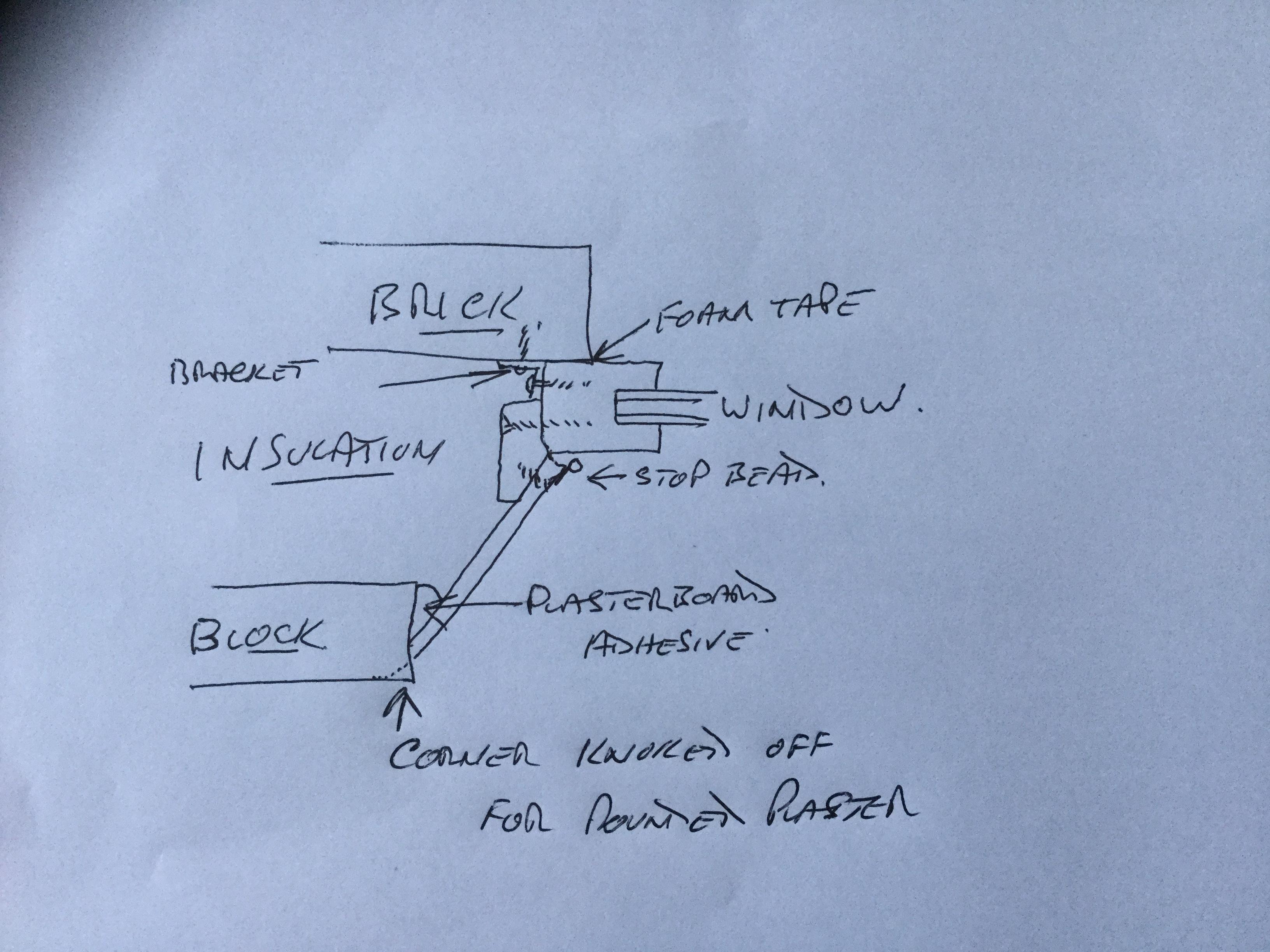

joe90 Posted July 8, 2019 Posted July 8, 2019 51 minutes ago, cwr said: Ok, that makes sense. I've also been told that fixing to outer skin may breach the DPC, be a potential corrosion corrosion issue, and invalidate the window guarantee. I've also got angled reveals on the inside, and a rather large cavity (240mm). All makes it that little bit more complicated... Actually I found it easier, my cavity is 200mm, inner blockwork 200mm wider per side, windows 40mm wider than brickwork “hole”, 20mm expanding foam tape between window and brickwork, stainless straps and stainless screws, vertical DPC stuck to back of brickwork before fixing window straps. Angled reveal made of plasterboard fixed to angled button on side of window and plasterboard adhesive to blockwork after its internal corner was rounded. NOTE I asked the plasterers to use a stop bead at the joinfrom plasterboard to window but they said it was not needed OH YES IT WAS. I have suffered cracking plaster at this junction (so have others on this forum including @JSHarris,) if a stop bead was used the small gap between stop bead and wooden window could be filled with non setting caulk to accommodate any shrinkage or movement. I know this because I did this on the porch I built and I have no cracking. p.s. On the air test the small leaks were mainly at these cracks.
cwr Posted July 9, 2019 Author Posted July 9, 2019 Hi Joe90. Thanks for sharing that. Can you explain to me about the 'angled button on side of window', is that a bracket off the frame to fix the plasterbaord too, or something simalar? Good point re the stop bead, I'll make a note of that.
joe90 Posted July 9, 2019 Posted July 9, 2019 19 minutes ago, cwr said: is that a bracket off the frame to fix the plasterbaord too, or something simalar? No I cut a piece of timber the height of the window, screwed to the side of the window but with an angled edge to screw the plasterboard to, hang on I feel a diagram coming........

Oz07 Posted July 17, 2019 Posted July 17, 2019 @joe90 no cavity closers then ? Just plasterboard up against insulation?
joe90 Posted July 17, 2019 Posted July 17, 2019 44 minutes ago, Oz07 said: @joe90 no cavity closers then ? Just plasterboard up against insulation? What I omitted in my drawing was a vertical DPC on the brickwork, (belt and braces) the rock wall batts don’t wick water anyway, also spray insulation against the back of the plasterboard.
