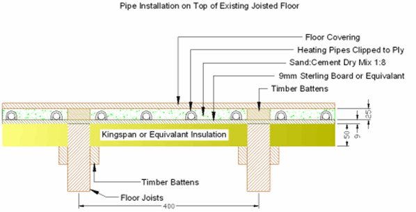

Toppers Posted June 27, 2019 Posted June 27, 2019 (edited) I'm going to be putting UFH pipework on the top of 100mm Celotex insulation between joists, joists are at 400mm centres, how many runs of pipework would I need down each joist run? Length of each run is approx 5.3m. Edited June 27, 2019 by Toppers

Rob99 Posted June 27, 2019 Posted June 27, 2019 Depending on pipe size and output, most UFH is designed at pipe centres of between 125 and 200. Logically it would seem that you need 2 pipe runs between each pair of joists otherwise they'd be at 400 centres. As @Simplysimon says, send a floor plan to Wunda, they're very good.

ProDave Posted June 27, 2019 Posted June 27, 2019 2 hours ago, Toppers said: I'm going to be putting UFH pipework on the top of 100mm Celotex insulation between joists, joists are at 400mm centres, how many runs of pipework would I need down each joist run? Length of each run is approx 5.3m. I think a lot more detail is needed. Will this be the Celotex with the grooves in for the pipes to fit flush? or will it be as someone else suggested be covered with a biscuit mix?
Toppers Posted June 27, 2019 Author Posted June 27, 2019 1 minute ago, ProDave said: I think a lot more detail is needed. Will this be the Celotex with the grooves in for the pipes to fit flush? or will it be as someone else suggested be covered with a biscuit mix? I going to use standard 100mm Celotex and the 8:1 biscuit mix.
ProDave Posted June 27, 2019 Posted June 27, 2019 1 minute ago, Toppers said: I going to use standard 100mm Celotex and the 8:1 biscuit mix. Okay as someone who did this (a little different) I wanted to be clear that you are putting battens along the top of the joists to support the floor, with the biscuot mix filling in between as a heat spreader, but not supporting the floor. This solves the problem of how the UFH pipes cross the joists, you leave a small gap in the battons. and it means you don't need much support for the celotex. I take it the joists have been specified taking into account the extra dead load they have to support.
Toppers Posted June 27, 2019 Author Posted June 27, 2019 (edited) 4 minutes ago, ProDave said: Okay as someone who did this (a little different) I wanted to be clear that you are putting battens along the top of the joists to support the floor, with the biscuot mix filling in between as a heat spreader, but not supporting the floor. This solves the problem of how the UFH pipes cross the joists, you leave a small gap in the battons. and it means you don't need much support for the celotex. I take it the joists have been specified taking into account the extra dead load they have to support. No I was going to leave the Celotex 25mm below the top of the joist and infill that with the biscuit mix. I assume this is the same difference. Edited June 27, 2019 by Toppers

Carrerahill Posted June 27, 2019 Posted June 27, 2019 (edited) This is what I have been advised to do but without the OSB directly above the Celotex. - but I think I will run the battens under the joists and let the PIR sit lower, I also suspect this will be stronger (I will need to get good fixings and use plenty support). Edited June 27, 2019 by Carrerahill
Carrerahill Posted June 27, 2019 Posted June 27, 2019 4 minutes ago, Toppers said: No I was going to leave the Celotex 25mm below the top of the joist and infill that with the biscuit mix. I assume this is the same difference. This is how I am doing it - but I could do it as per prodave as I could just remove a 19mm piece of the plate the joists sit on and use 19x38mm battens over the top - hmm!
ProDave Posted June 27, 2019 Posted June 27, 2019 4 minutes ago, Toppers said: No I was going to leave the Celotex 25mm below the top of the joist and infill that with the biscuit mix. I assume this is the same difference. Your proposed idea gives you one MAJOR problem. How will the UFH pipes cross over a joist, which they will to at one end, crossing over every joist. You cannot notch a posi joist. I did it this way on a very small section of floor under the bathroom, and I threaded the pipe between the top and bottom chord at one end, but it was VERY hard work with only a short run of pipe to keep threading through. If you are going to be doing anything like a normal sized room, you could be having many tens of metres of UFH pipe and threading it through again and again is going to be somewhere between extremely hard, and impossible. Battens along the top with a small gap at one end for the pipes to pass solve all this. Set the celotex level with the top of the joists. 1

scottishjohn Posted June 27, 2019 Posted June 27, 2019 (edited) I would do this joist with insulation between up to top of joists ,then plywood then fit all UFH piping then fit battons between pip[ing ,then fill with biscuit mix ,then fix top floor to that this way no load on insulation at all Edited June 27, 2019 by scottishjohn 1
ProDave Posted June 27, 2019 Posted June 27, 2019 Just now, Toppers said: Mine are C24 joists so I don't mind chiselling a notch out for the pipework to cross. That's fine, you can notch them, just check you put the notches in the prescribed zones. I must have got confused with another thread and thought you had posi josts, sorry for the confusion.
Carrerahill Posted June 27, 2019 Posted June 27, 2019 4 minutes ago, ProDave said: Your proposed idea gives you one MAJOR problem. How will the UFH pipes cross over a joist, which they will to at one end, crossing over every joist. You cannot notch a posi joist. I did it this way on a very small section of floor under the bathroom, and I threaded the pipe between the top and bottom chord at one end, but it was VERY hard work with only a short run of pipe to keep threading through. If you are going to be doing anything like a normal sized room, you could be having many tens of metres of UFH pipe and threading it through again and again is going to be somewhere between extremely hard, and impossible. Battens along the top with a small gap at one end for the pipes to pass solve all this. Set the celotex level with the top of the joists. I think I am going to lower my joists 19mm and batten out on top now. I do have a clear run home down one side the way the perimeter of the floor works out (joist change direction) but I prefer the idea of running them as I want and NOT in the confines of the joists. Good call! I have not been shown this detail before and it makes perfect sense! Glad I didn't nail in all my joists a couple of weekends ago!
Carrerahill Posted June 27, 2019 Posted June 27, 2019 (edited) 2 minutes ago, scottishjohn said: I would do this joist with insulation between up to top of joists ,then plywood then fit all UFH piping then fit battons between pip[ing ,then fill with biscuit mix ,then fix top floor to that this way no load on insulation at all depth of biscuit mix? direct tile onto this? Edited June 27, 2019 by Carrerahill
scottishjohn Posted June 27, 2019 Posted June 27, 2019 (edited) 3 minutes ago, Carrerahill said: depth of biscuit mix? direct tile onto this? If tiles --then 6mm ply on biscuit mix +tile onto that ? it s what idid in my own floor 15 years ago with 450x450 tiles --all still there just make sure there is no flex in joists !! Edited June 27, 2019 by scottishjohn
