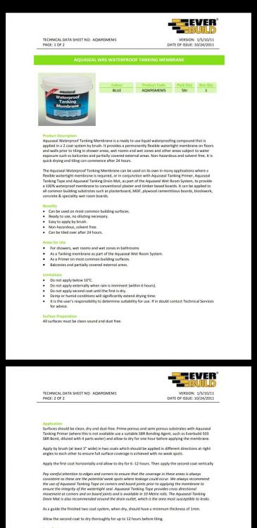

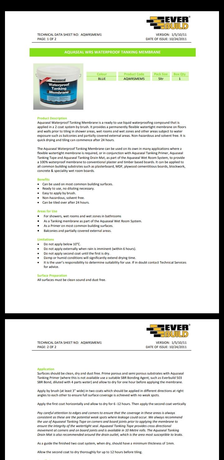

Onoff Posted June 24, 2019 Posted June 24, 2019 (edited) Interestingly on my Aquaseal tanking kit is says you can use Everbuild sbr if you haven't got the Aquaseal primer: Edited June 24, 2019 by Onoff
